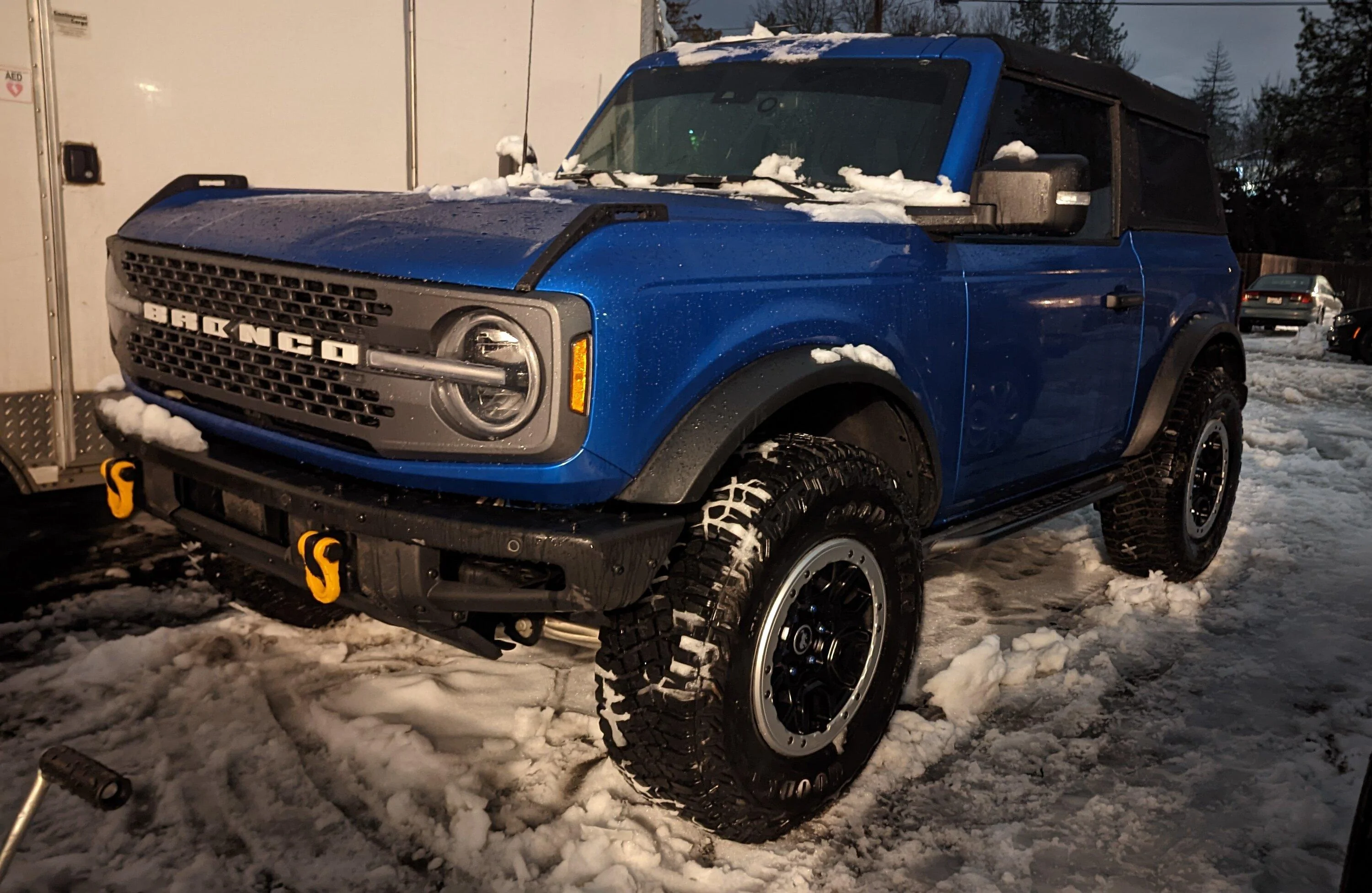

What are you doing for wheels for these?
Sasquatch beadlocks. I found rings for as low as $600 if you shop around. I may need 1" spacers.
A minimum wheel width of 10" is recommended on these 14.50s. As a beadlock the squatch wheels should be around 9", I'm ok with that.
Between a functional beadlock and mostly off road, I'd agree that the recommended wheel width is not very important.
One concern is if you go with spacers and you are swapping these for street setup, the spacers take some extra work to swap, with the two-piece design.
My other warning on spacers, is try to get them with a hub-centric lip if possible. On another rig, I was snapping lug bolts like crazy because they were carrying the weight on the lugs (no lip to get the weight on the spacer and the hub).
Amazing deal on the tires, btw. Thanks for the heads-up on blems.

I hoping I can get away with no spacers, or maybe just a slip on 5-8mm. The 1" spacers are a single piece so it's not as bad. I put 2pc on the Bronco 2 and they're a pain in the ass.
I'm guessing hub centric for the Bronco is still a custom order at this time.

This damn rig is such a black hole for money. Five 37x14.50x17 Interco SX2s ordered up for $1800 shipped.
Get ready for the disappointment. Lol! These bad boys are smaller than advertised and heavy as hell. I plan on selling mine soon. Never mounted brand new.
What do they measure?
They claim 36.83", not even close? How about width? I wouldn't mind if they ran a lot narrower than advertised.

Wow that's not great. 0.1" shorter than my current 35s.
Agreed. Far from a 37" tire, I am looking for ground clearance. Idk why they are small? I have found old comments/threads on numerous pages how small they were. And this was long ago. Cool tire, but too small for my build. I have always ran TSL SX's or Boggers. 17" tire sizes are odd anyway. I am use too 15" tire sizes. I am only going 17" due to the beadlock wheels.
Yup got SX2 35x13.5 15 now and 1 inch smaller then the TSL SX 35x15.5 15 that were on my 72
