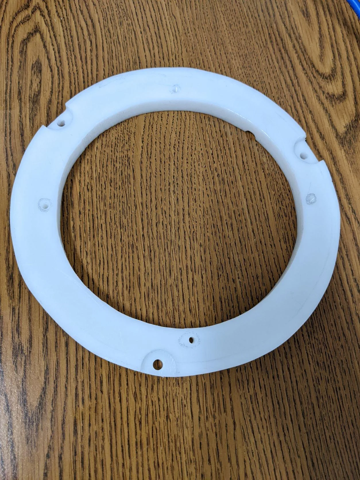

Rather than purchase adapters for the 6.75 I made my own from 1/2 thick plastic. The stock kick panel speaker is a 6.5", but there is plenty of depth and space for the 6.75 to fit. As these were the only ones my local shop had in stock, I went with them. I did trim the back of the kick panel trim grill area (see photo) to ensure that the speaker would not touch as it travels. I mounted the tweeters to the dash top grills.

Did you have do drill any new holes for the kick panel speakers? Was the outer ring the multi fit style?

I made my own adaptor for these speakers so there was no drilling required. I used some .500 thick PP sheet. The factory speaker has three screws holding it in, you can see the three holes in the adaptor with the counter bored area for their heads. Then the four threaded holes are used to bolt the 6.75" Rockford Fosgate speaker to this ring.
