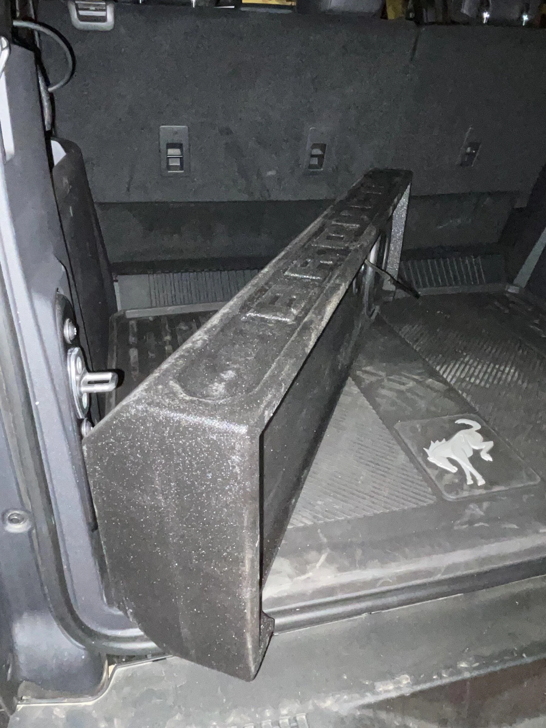

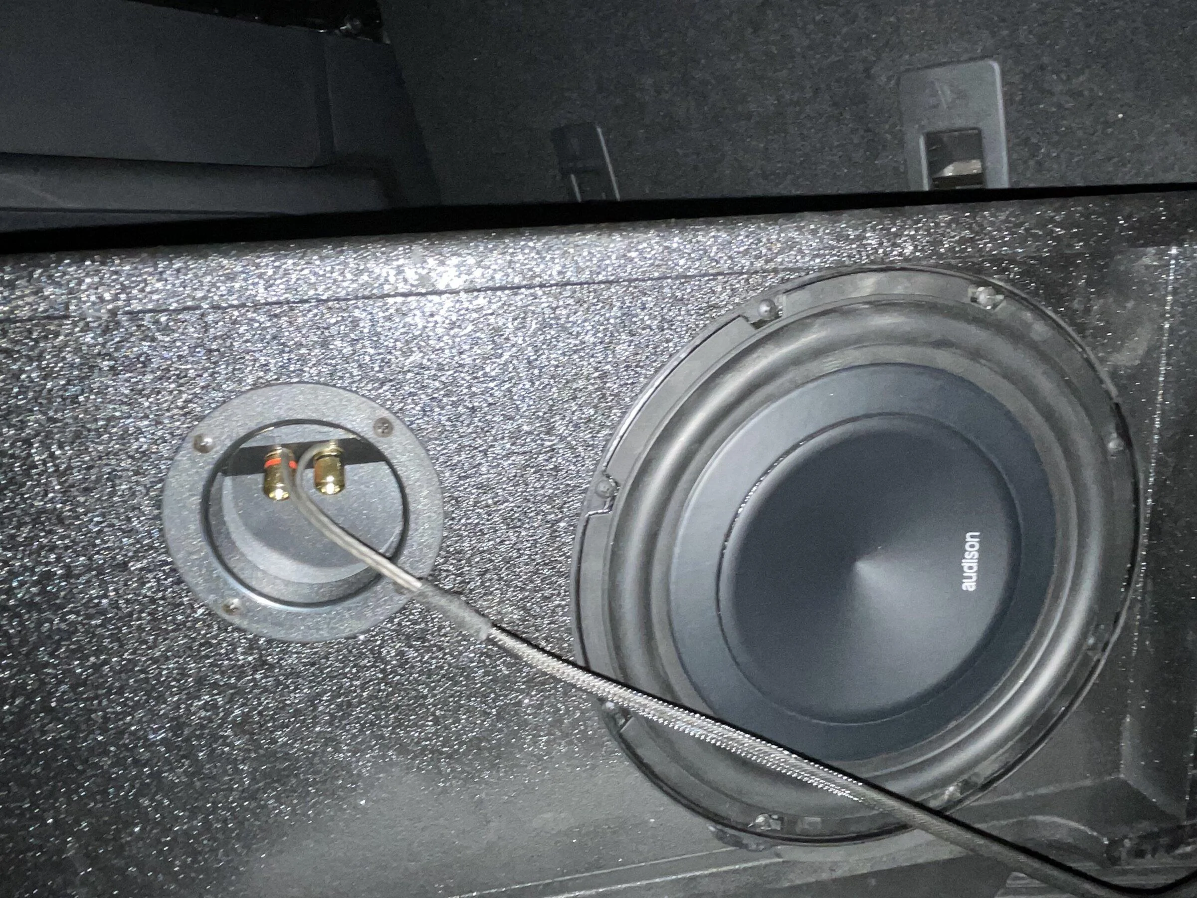

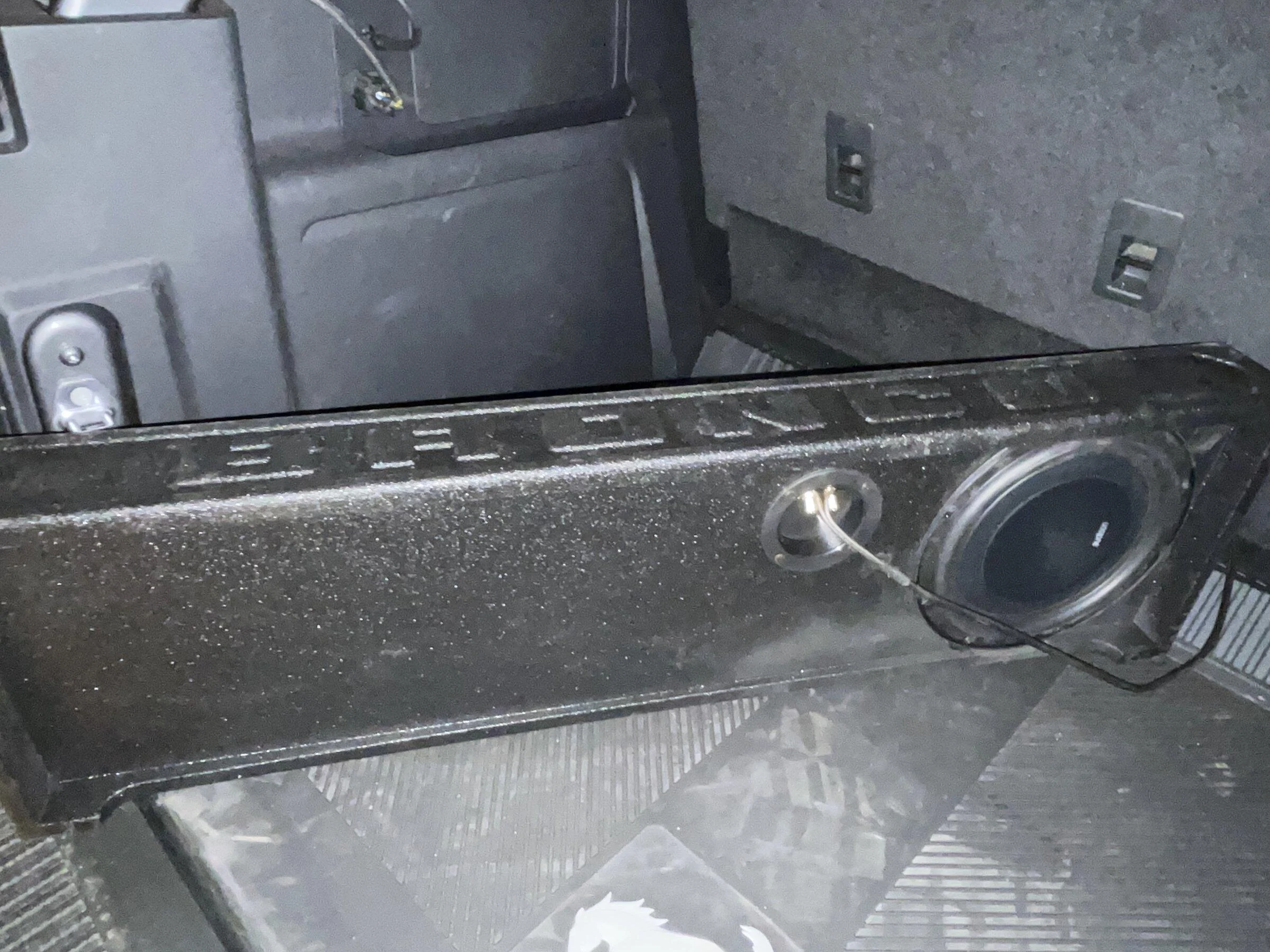

Sorry for all the questions. How does it sound with just one 10"
Been a few weeks and it sounds awesome with the top and doors on, I’d give it an above average with top off and doors off. Here are a couple of pics from underneath.

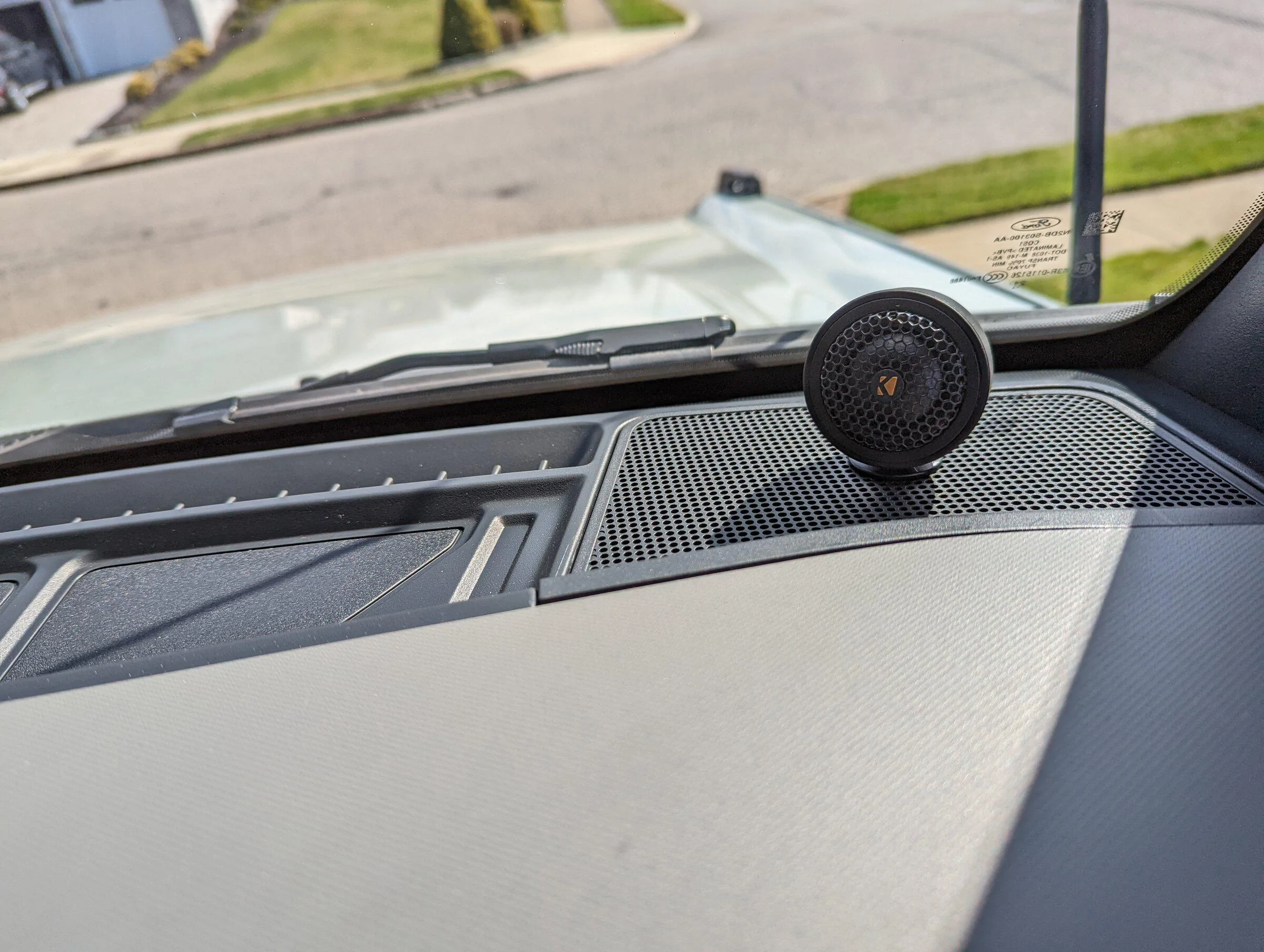

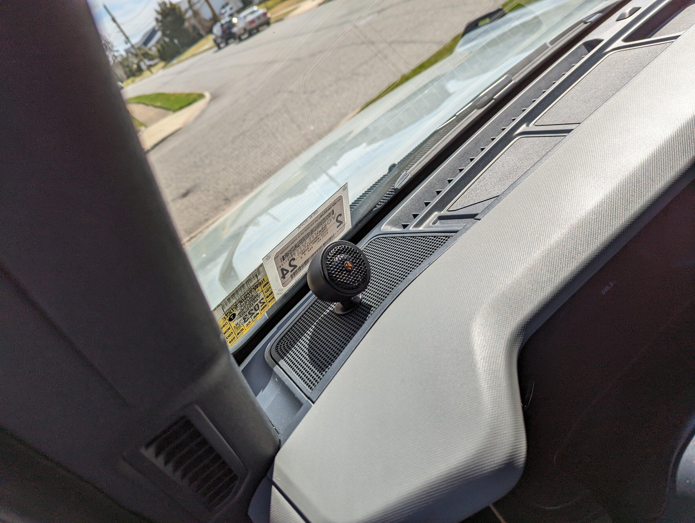

After 2 weeks I finally finished installing my 1000watt JVC amp, dual 12 inch kicker comp c in a 32/17/16 ported enclosure (with a bass knob), Pioneer 4inch TS-G400 in each dash corner and rear pods, and 6 3/4 inch Kicker 46CSS674 in the (ironically) kick panels. I hope the amp installment can give some ideas. Feel free to ask any questions.

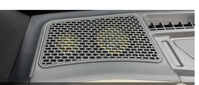

Coaxial 4 inch dash under the component tweeter? How does that sound? Also, is that a 5 channel amp? Which speakers are being driven by the amp?
I also went with the Kicker tweeter mounted on the dash speaker grill. I'm thinking about removing them and just running the kicker 4 inch coaxials and the 6.5 inch components active in the front with the rear pods running off the factory radio.

I did the 4 inch 2 way because of how excluded the kick panels are, I suprisingly get pretty good mid range from those and it pairs very nicely with the tweeter pushing those highs, I originally didn’t have the tweeter mounted and noticed I was lacking a lot of highs even with the 2 way. And it is a 5 channel amp. I have 1 channels powering both rear pods. One channel powering the dash speakers. And the other 2 powering the kick panels. And then the sub channel.
