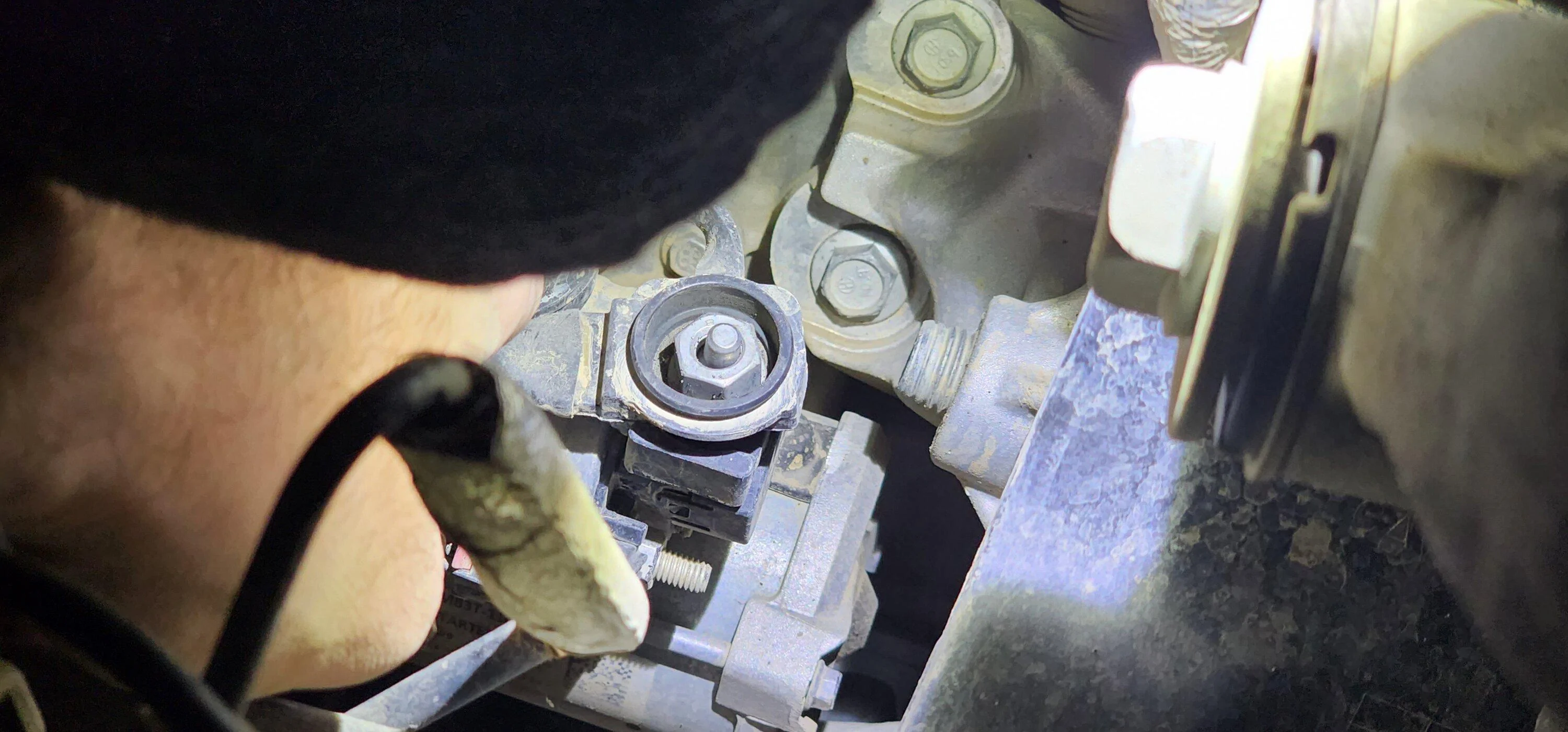

Having issues with the Bronco not starting. Press the start button and get a CLICK from underneath but no action from the starter. Press the button over and over and eventually it'll fire right up like nothing was ever wrong.
Have it scheduled to go to the dealer, but it's highly intermittent and will certainly be impossible for them to replicate without some real luck.
Anyone experience this and find the culprit?
-UPDATE-
I took another look at the starter this morning, and the nut for the power is clearly backed off and stuck sideways. It's not loose, and wouldn't budge in either direction, so I'm not dealing with it myself. Could I? Sure, but that's what warranty is for. It's at the dealer now.
