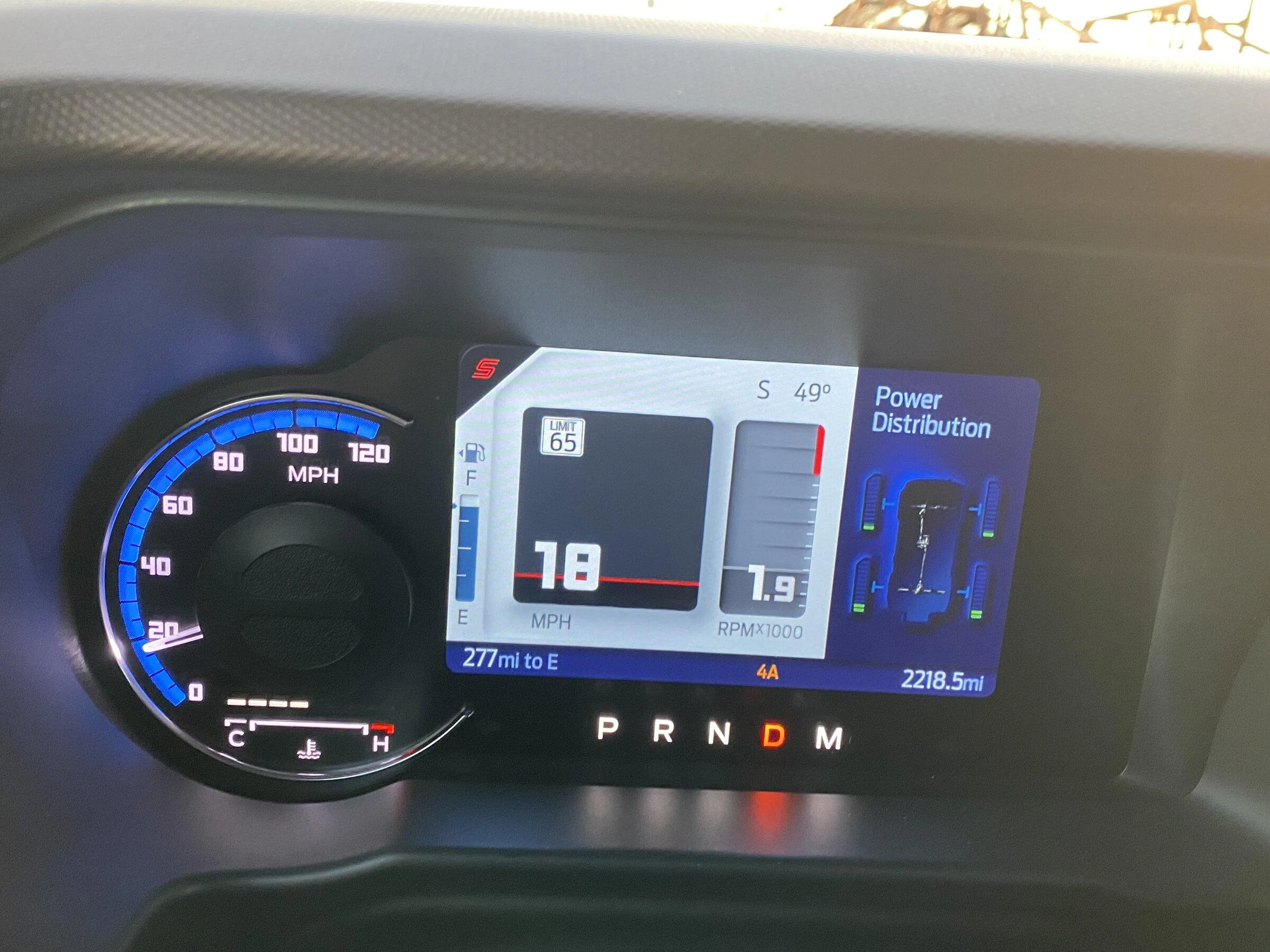

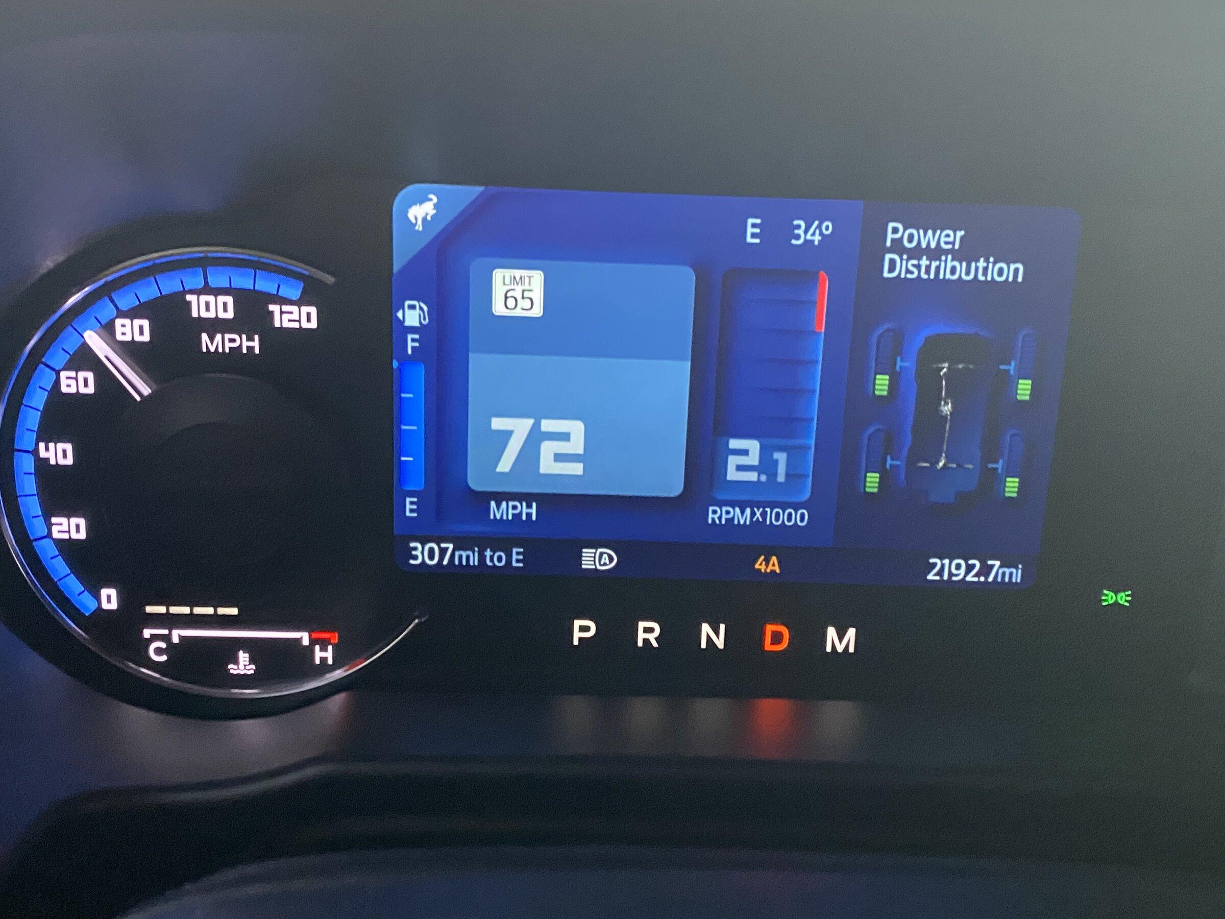

I’ve driven mine in 4A on both wet and dry streets, light snow covered streets, and in dirt at Badlands off-road park in Indiana. While many here are saying it defaults to 2WD unless 4WD is needed, that has not been my experience at all. It’s almost always pushing the 4 wheels. You can see this by selecting the off-road pages on the instrument panel and selecting the one that shows power distribution to the 4 wheels.
Was looking to see if this has been covered. Mine has been defaulting to 4A and I’ve left it there. Lots of chatter about 4wd adding wear. Was surprised to see this while flipping through display screens. Power distribution. On dry pavement about 80% of the time shows power going to ask 4 wheels while in 4A.

I don’t use 4 h on the streets, never said I did. Just asked a question. Also pointed out earlier that I was surprised to see on this power distribution screen that in 4a power was being sent to my front wheels in dry conditions about 80% of the time.
