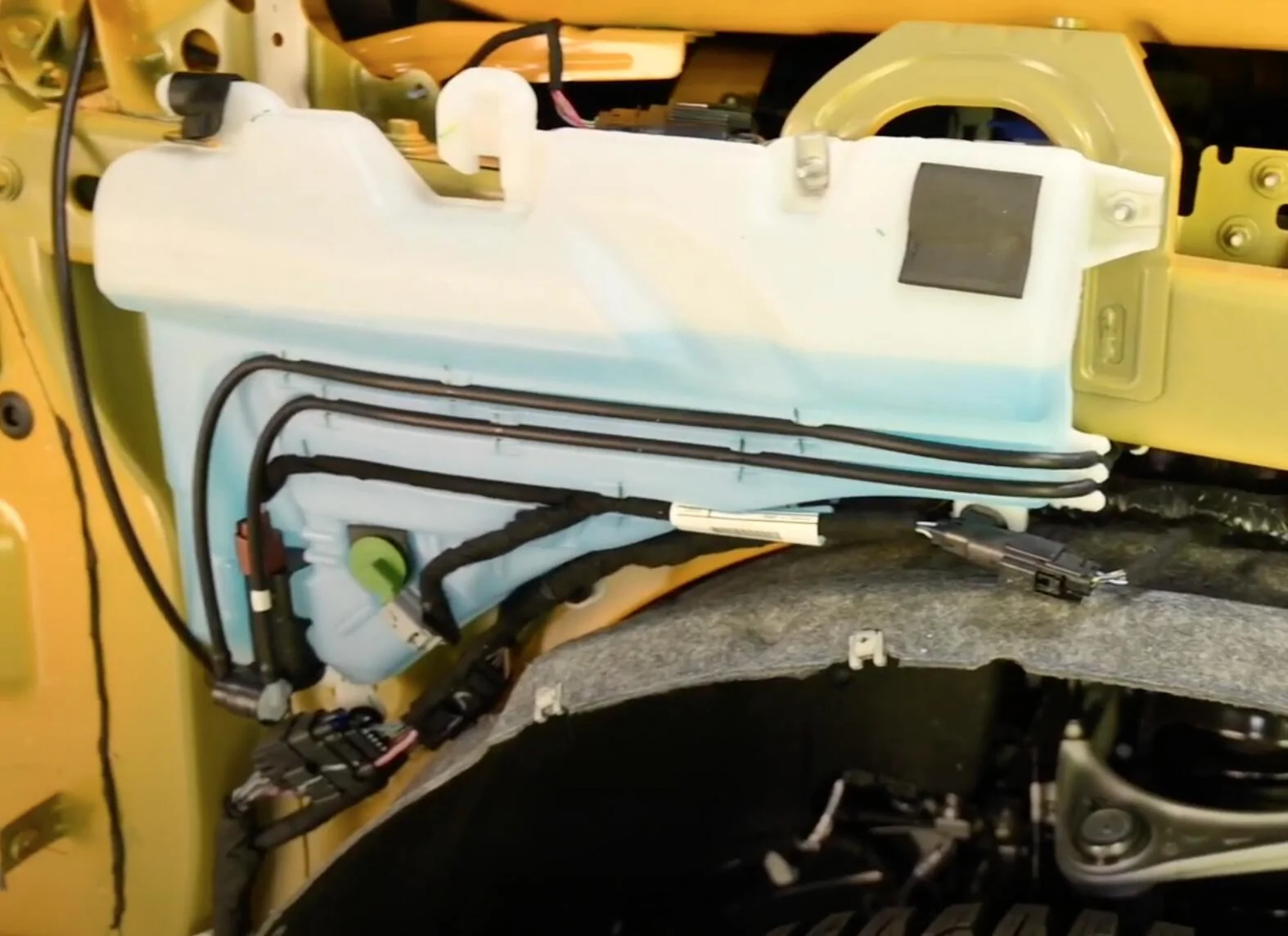

Been noticing my reservoir gets empty really quickly and finally decided to pay attention. Bought a new bottle, poured it into reservoir and marked on the bottle how much I used. I happened to hear a drip sound on the garage floor and saw fluid actively dripping on the floor. The felt in the front passenger wheel well was wet and dripping right under the reservoir. Also noticed dripping at the felt near the rock rail area. Dripping stops after a few minutes. Over the past two days, I have not used the washer fluid function on the wipers, but have proceeded to add more fluid every few hours or so. Obviously a leak somewhere or a crack in the reservoir.
Anyone have this issue? Will be calling the dealer soon.

Be aware the washer reservoir is a two piece design and you may get some leakage if you run it filled to the cap (like you'd do on most vehicles). The filler neck is connected at the top of the tank and the seal there may be leaking.
You could (if so inclined) unbolt the filler neck and check the gasket to see if it twisted or cut. If the reservoir is cracked it should be a simple fix.

I have a 2021 OBX and have the exact same issue. Noticed a puddle of fluid just under the passenger fender.
Good luck trying to get into a dealer.
They are making appointment 2 weeks out...it will be quicker to troubleshoot and fix it yourself rather than wait on Ford.

There is a line that runs back for the rear wiper that runs through the passenger side too - Iā€™ve seen a few posts where the hose had just come off - itā€™s just some rubber tubing on barbed fittings and nothing but friction really holding it together

I had the same problem about a year ago, the plastic weld in the bottle itself failed.
At the bottom of the reservoir. *facepalm*
bottle was swapped for a new one, and hasn't been a problem since.

Similarly, my washer fluid reservoir spontaneously empties at the same spot within a couple hours of using it as if holding pressure or a vacuum and then releasing. Havenā€™t taken the fender off yet to figure it out.
That is exactly where the loose hose was.
Just followed the flood of washer fluid to the passenger foot well and found the disconnected hose.
What an awesome idea it was to create so many failure points just to run a single rubber hose line.
The bottle on mine has cracked , dealer ordered a new one under warranty.
