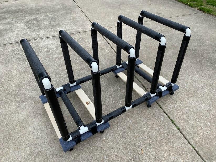

Built a door rack!

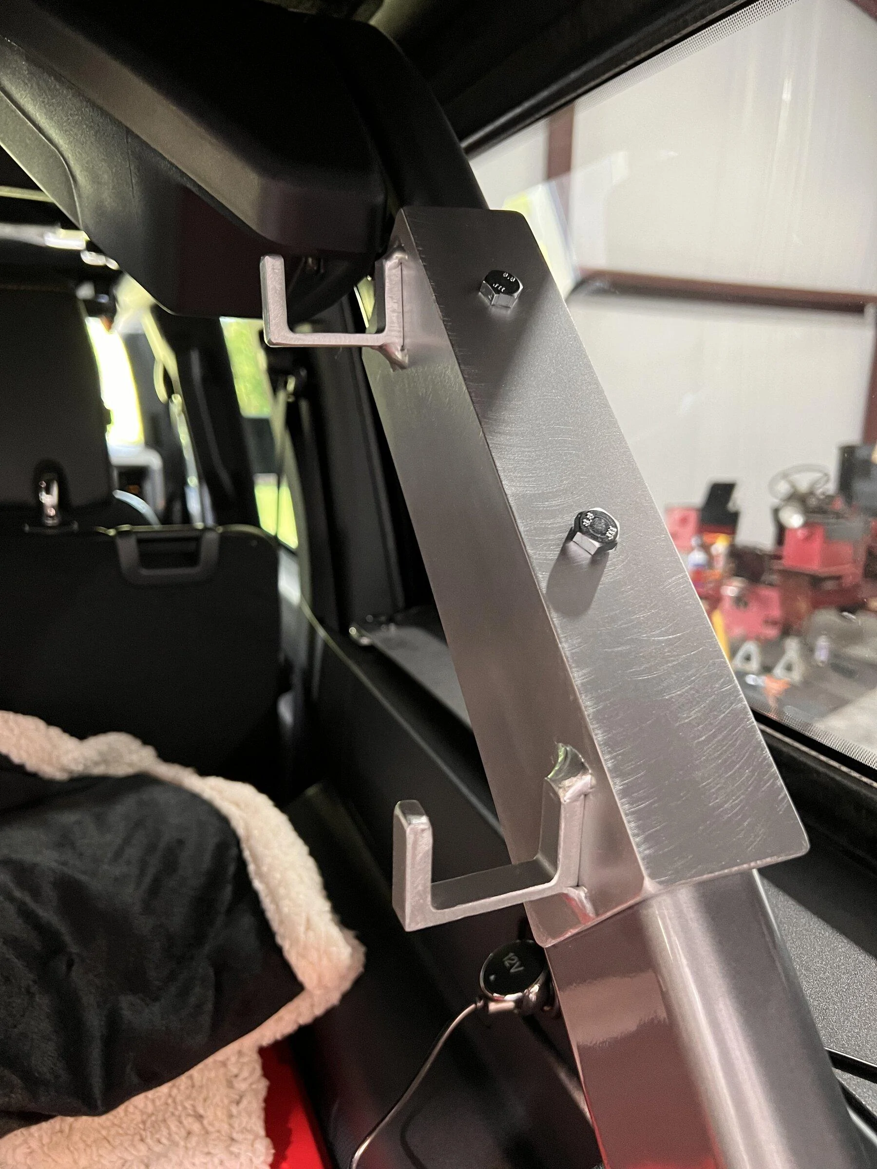

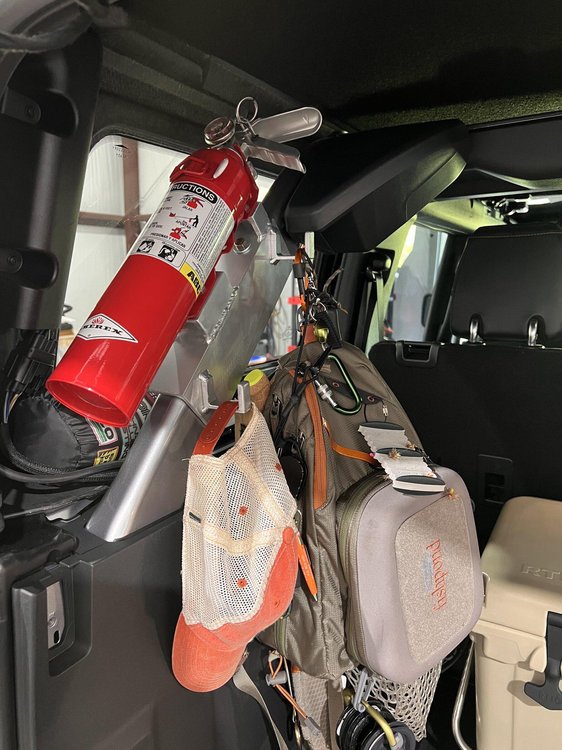

I needed a fire extinguisher mounting bracket and also needed a way to hang some gear for upcoming fly fishing trip. Had a little scrap aluminum around so came up with these.

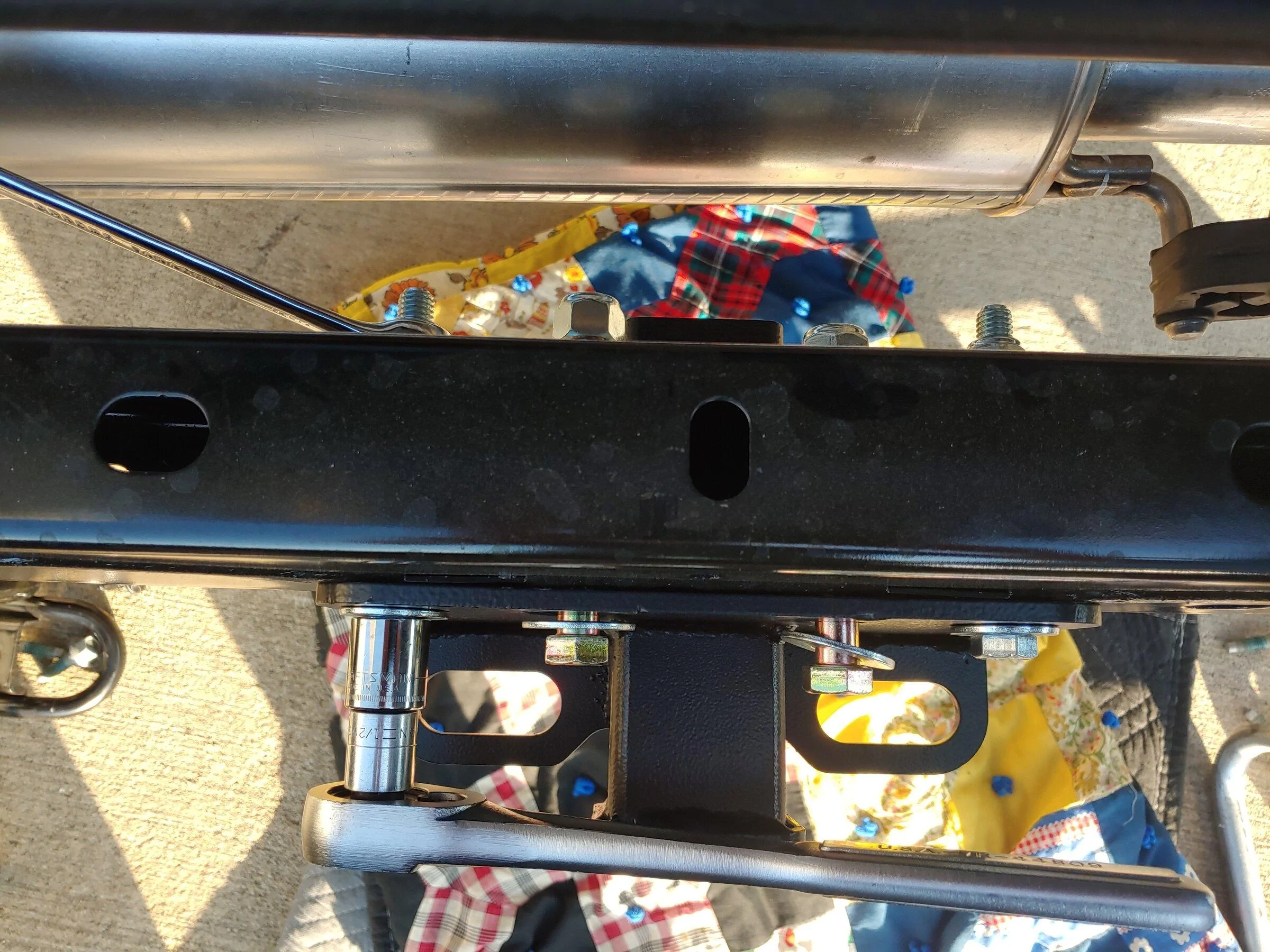

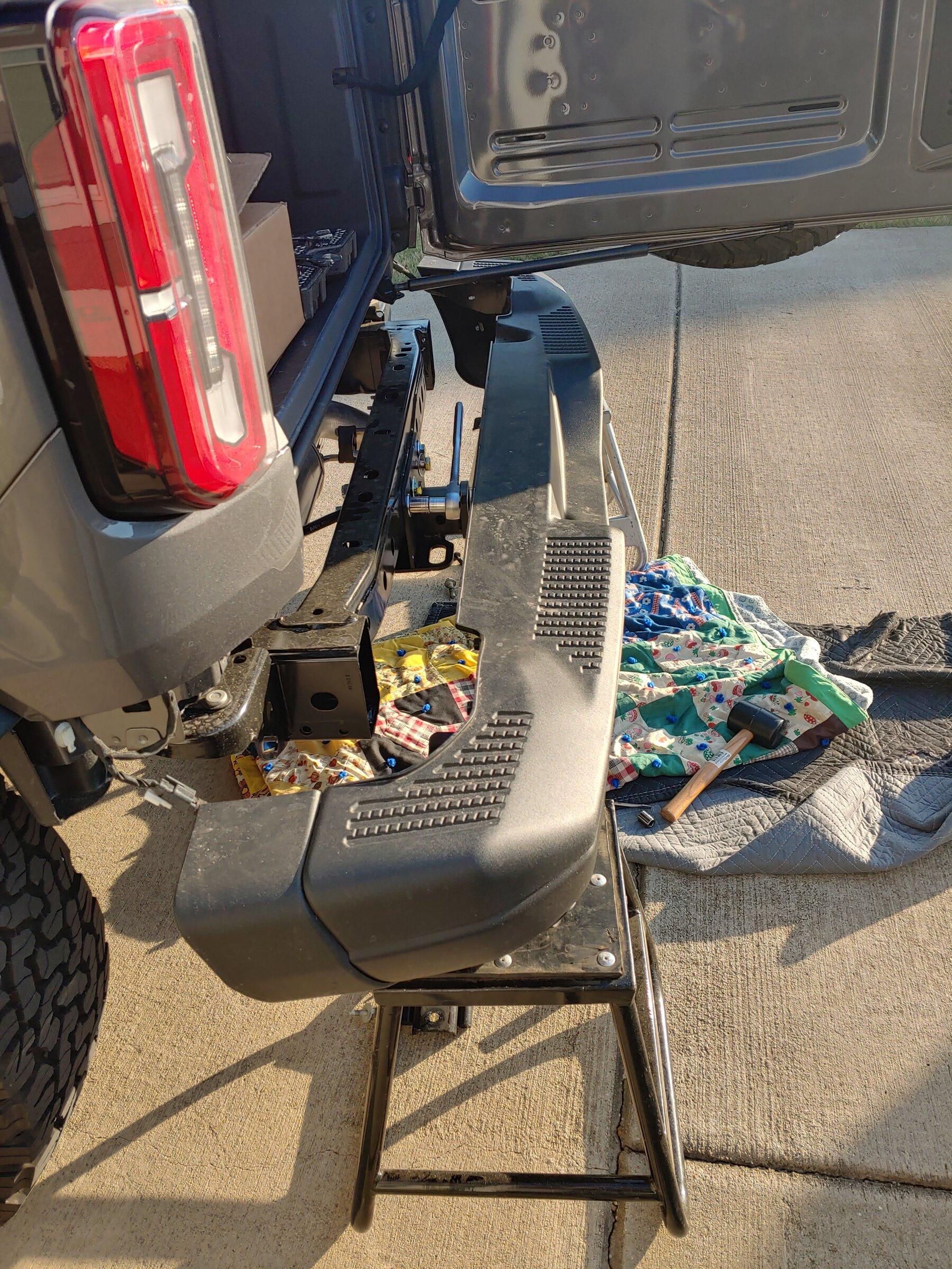

Installed the Rough Country hitch receiver.
did you have to remove the bumper? i saw a post on facebook saying they figured out a way to do without removing bumper... i'm hoping to avoid the removal..

I removed all bolts and then just held the bumper out of the way to get to the bolts I needed. Kind of a pain, but the clips that held in the wires for the back-up sensors were being even more of a pain.
Yes. Not a big deal. Only install vid I found didn't have high package so I had a couple of differences. You have to unplug the 2 center wires and the 2 outer ones on the ends of the bumper if you want to remove it. I just did the inside ones and pulled it off and had some thing on each end to set the bumper on. The Badlands had 3 bolts on each side(2 that hold on the recovery hooks and 1 just adjacent to those).
