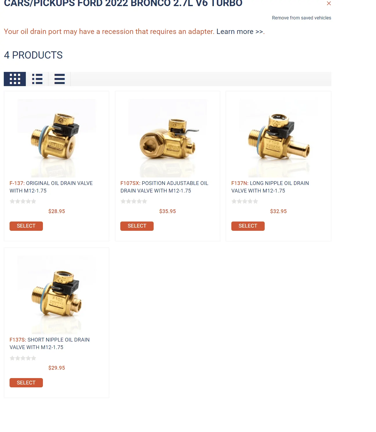

The Fumoto Web Page, searching for a 2022 Bronco 2.7 shows these 4 Fumoto Valves:
https://www.fumotousa.com/cars-pickups-ford-2022-bronco-2-7l-v6-turbo
What are you using? Model#

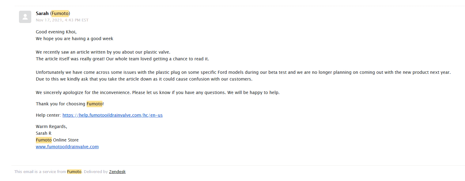

Fumoto has abandoned their 2.7 application. I was in their beta group.
The only application they have is for the 2.3.

Their web page (link above) has 4 models they say work on the Bronco 2.7

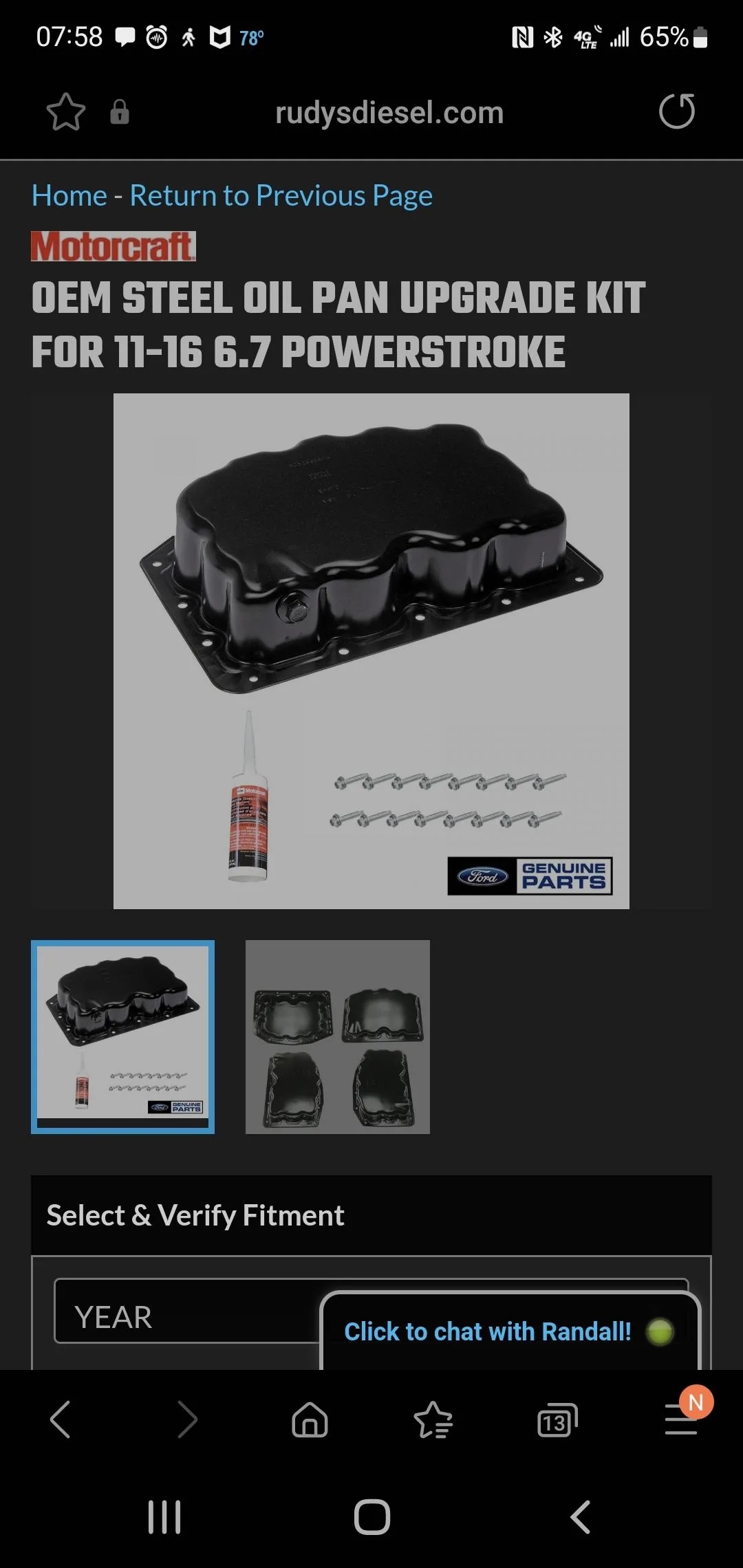

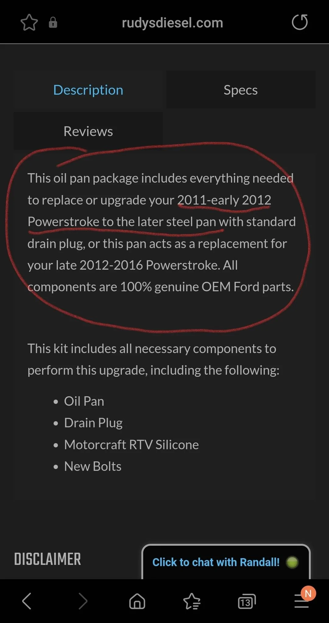

No, I do not have a metal pan on my 12' 6.7l.......
Here's the upgrade metal pan to replace my plastic one if needed. Not sure where you're getting your info but it's incorrect.

Please see below email. I was in the Fumoto beta test, testing their plastic valve and Fumoto shut it down.
