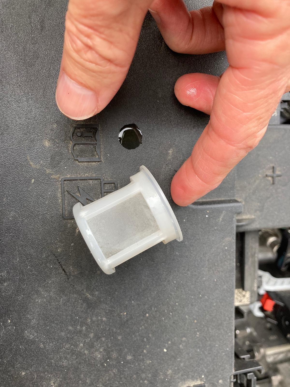

I found this loose in the engine compartment after an oil change. Anyone knows where it goes?

I believe itā€™s a filter that goes in the windshield washer fluid bottle. A lot of techs pull them out to fill the fluid faster.

My brand new Bronco doesnā€™t either. But thatā€™s what it looks like.

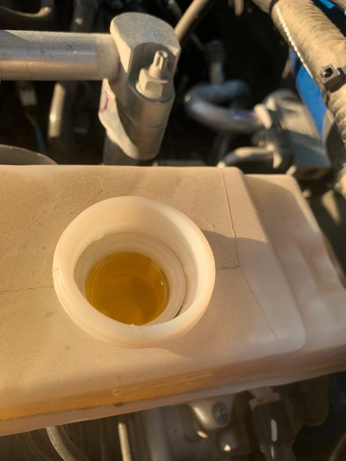

Brake fluid reservoirs have a screen as well. Check that.

I actually checked brake, coolant, windshield washer, oil fill, and looked for the power steering pump. Lol.

I went to the dealership and checked under the hood of another 2.7 turbo bronco and it had a filter. I talked to the service manager and asked how in the world would the brake fluid filter be removed for an oil change. He didnā€™t know and I asked him to order me a new filter since this one was dirty and I didnā€™t want to put it back in.
