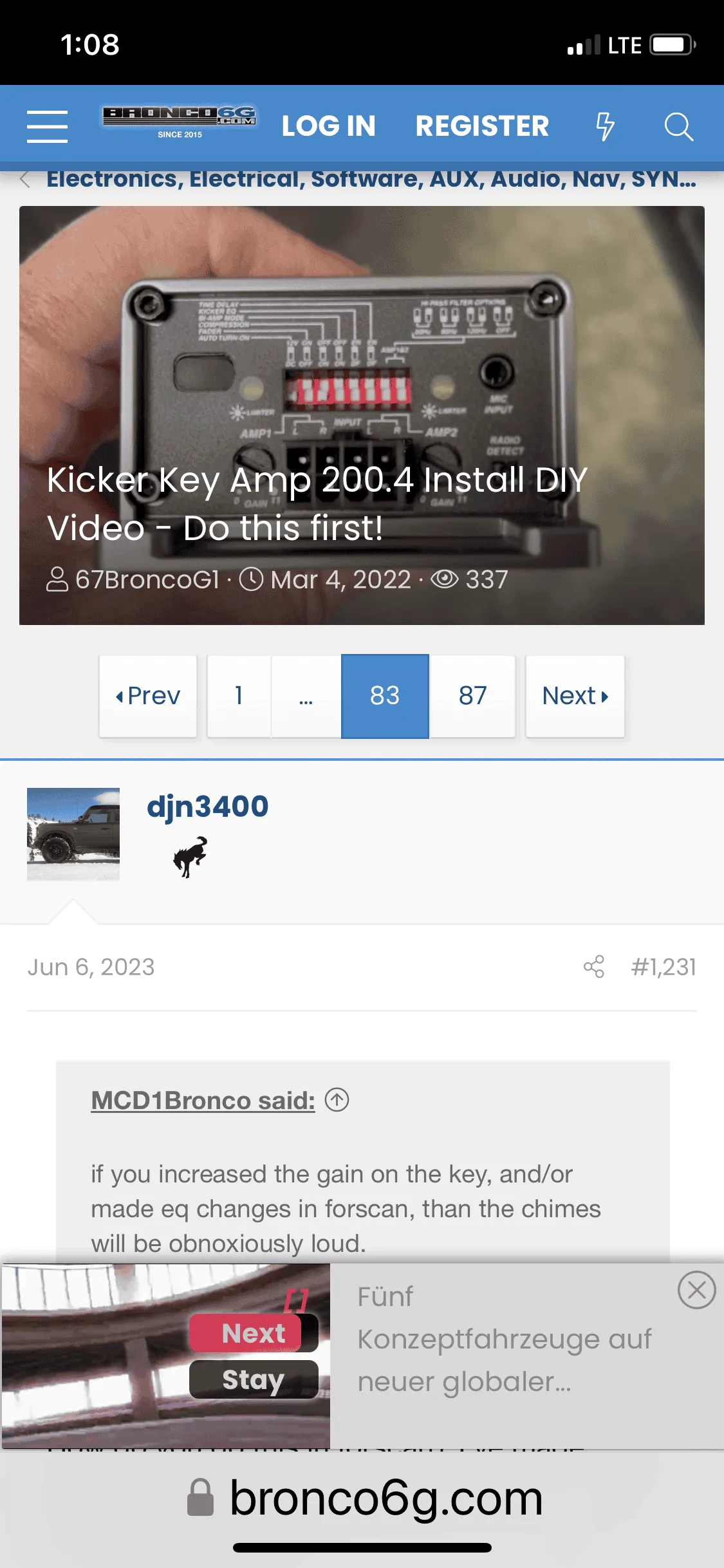

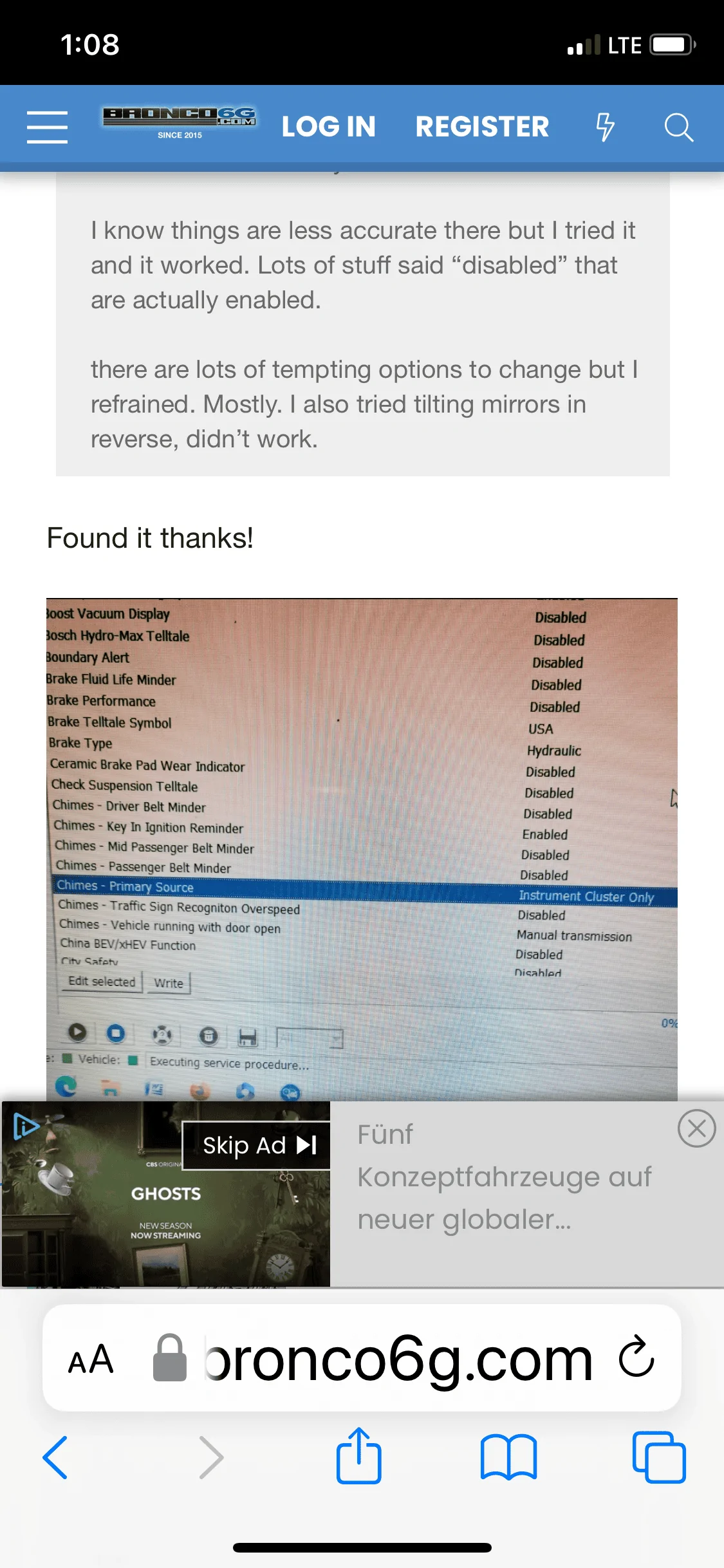

This moved chimes and turn signal sound to instrument panel from front speakers. Turn signal sounds like a normal vehicle now. Sorry for screen shots … not very technical
