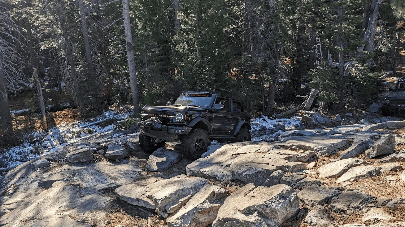

Because you need all the clearance you can get on certain trails. We will insert picture of a crazy person easily driving over rocks. Note a stock sas bronco would be high centered and not capable of doing this trail without being dragged.
Ford Bronco Why lift it? 1702311501010
Understand that at an Off Rodeo your on a pre-designed route specific to the bronco(not a trail, because routes are planned carnival rides). Real trails have obstacles that will get you no matter how built or good of a driver you are.

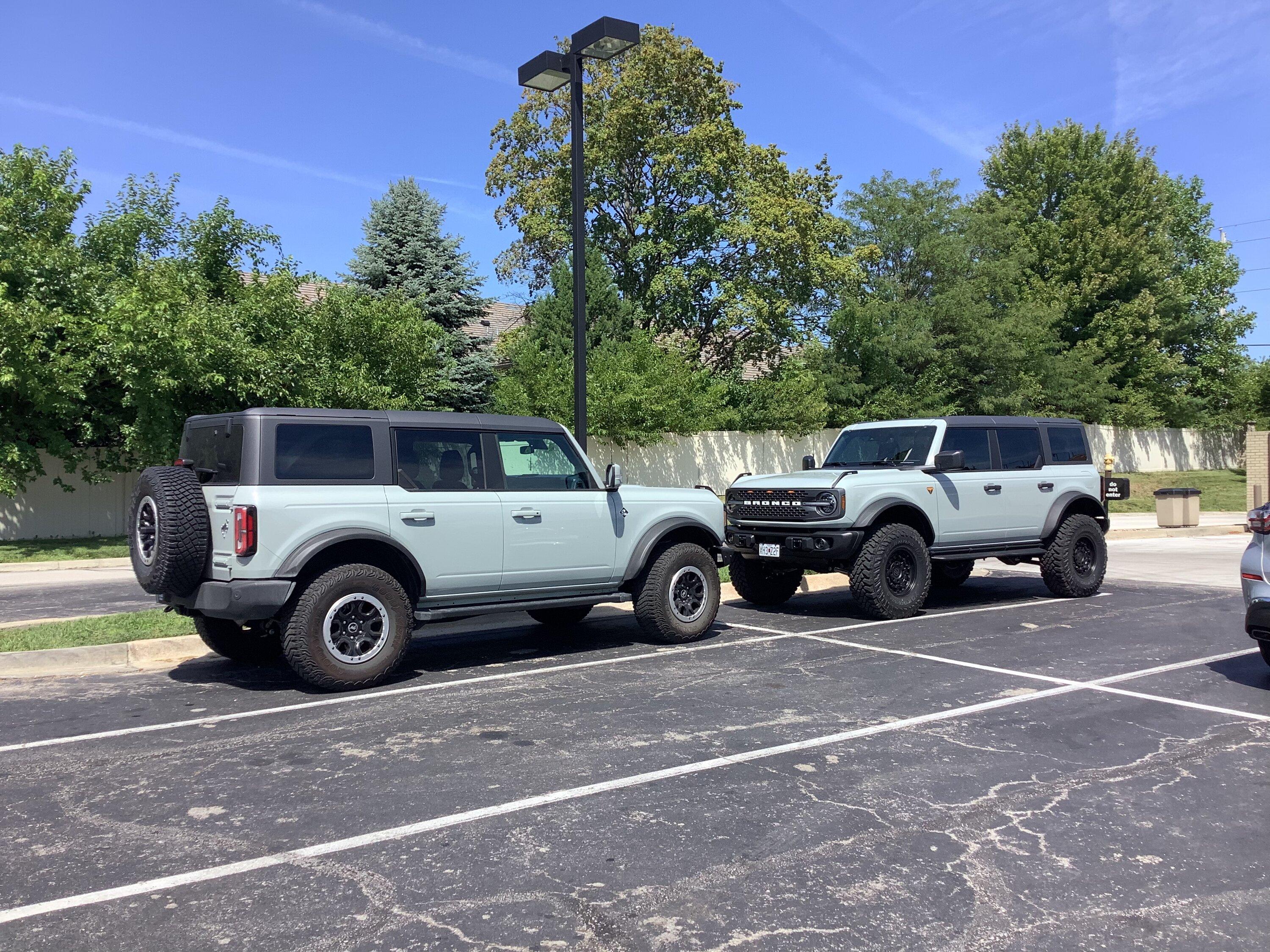

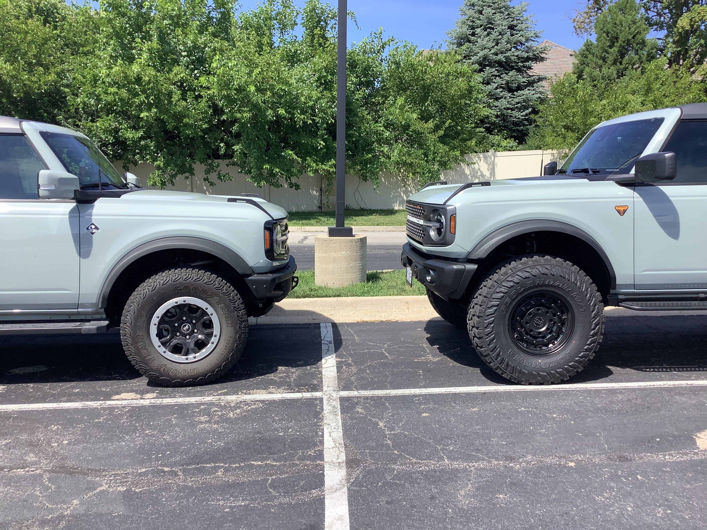

Looks so much better!
What lift and tires you running, I assume no spacers since you have aftermarket wheels? , looks great!
