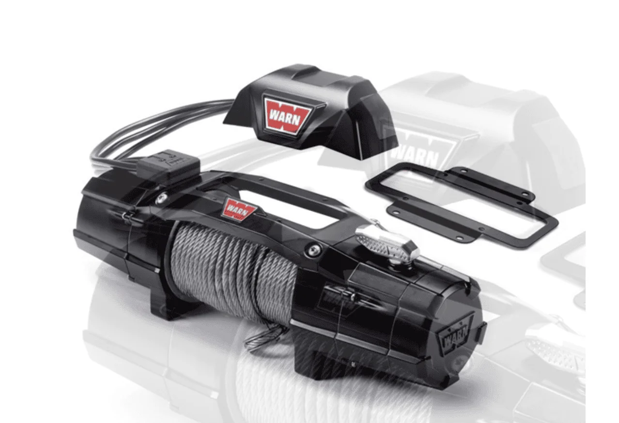

The warn winch is just a ford branded Zeon winch correct? Why couldn't we just relocate the solenoid using the relocation kit?
Ford Bronco Winch solutions 1622600168100
That 'should' at least 4more inches of clearance so that the camera wouldn't be covered. Am I wrong?
BroncoKong Jr.
Andrew
Mar 7, 2020
4,888
8,425
Moving the control pack was the Bronco brand manager's suggestion. But it would still block the camera a little.
Not sure why "move the control pack" became "not compatible with a camera"
A little I could deal with... :) Still hoping for a hidden winch solution to show up in the AM.

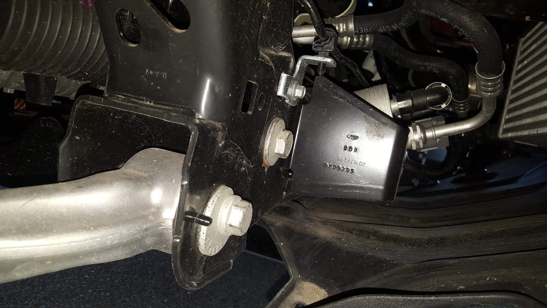

So I had a chance to get a pic of what it looks like behind the skid plate.
Looks like the oil cooler is bolted to the front crossmember, right were I would think they would bolt up a hidden winch mount. This could be why we have heard crickets about it. It's gonna take some relocation to get it done.

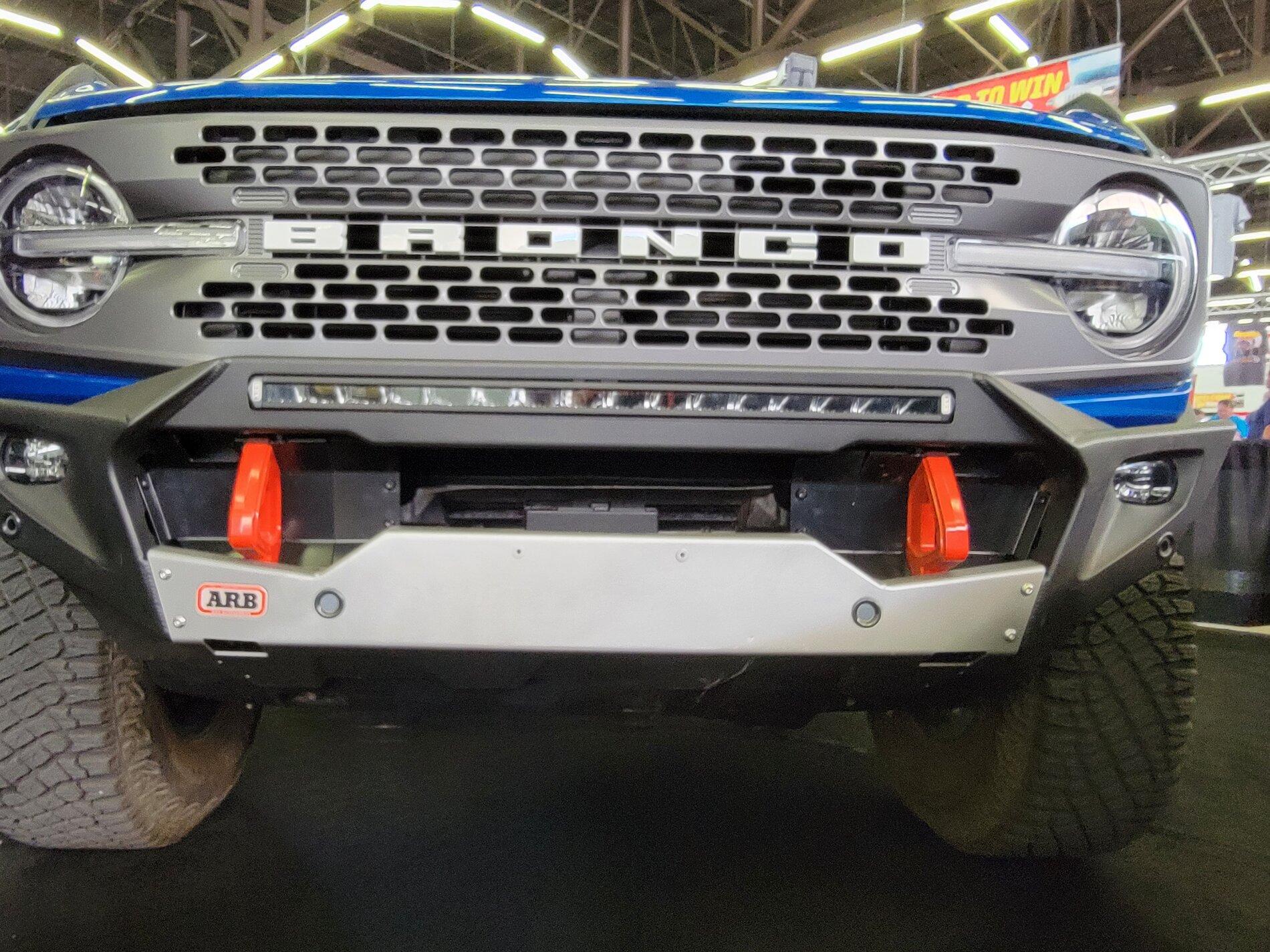

It may introduce artifacts on the edges/seams of the 360 view but I think moving the camera should not be ruled out. It's possible that a bar going over the winch with a integrated camera or camera mount for relocation could minimize issues while providing a clear view ahead.
But looking at this design... moving the solenoid and changing the bar design, would probably solve the problem without moving the camera.
I'm not saying relocating the front camera should be ruled out, but I very much doubt this approach will work or function properly... unless someone can find another vehicle with a similar feature-set where the OEM cameras were relocated and the camera views were retained.
Relocating the solenoid may be the best solution for costumers with the 360 option, but there are still a few other things to take into account... such as front parking sensors and ACC operation.
These are all questions I would like a definitive answer to, but just in case I added the winch/winch plate accesory to my order as a DIO. This is one of those times when additional technology can pose a problem in other areas...
