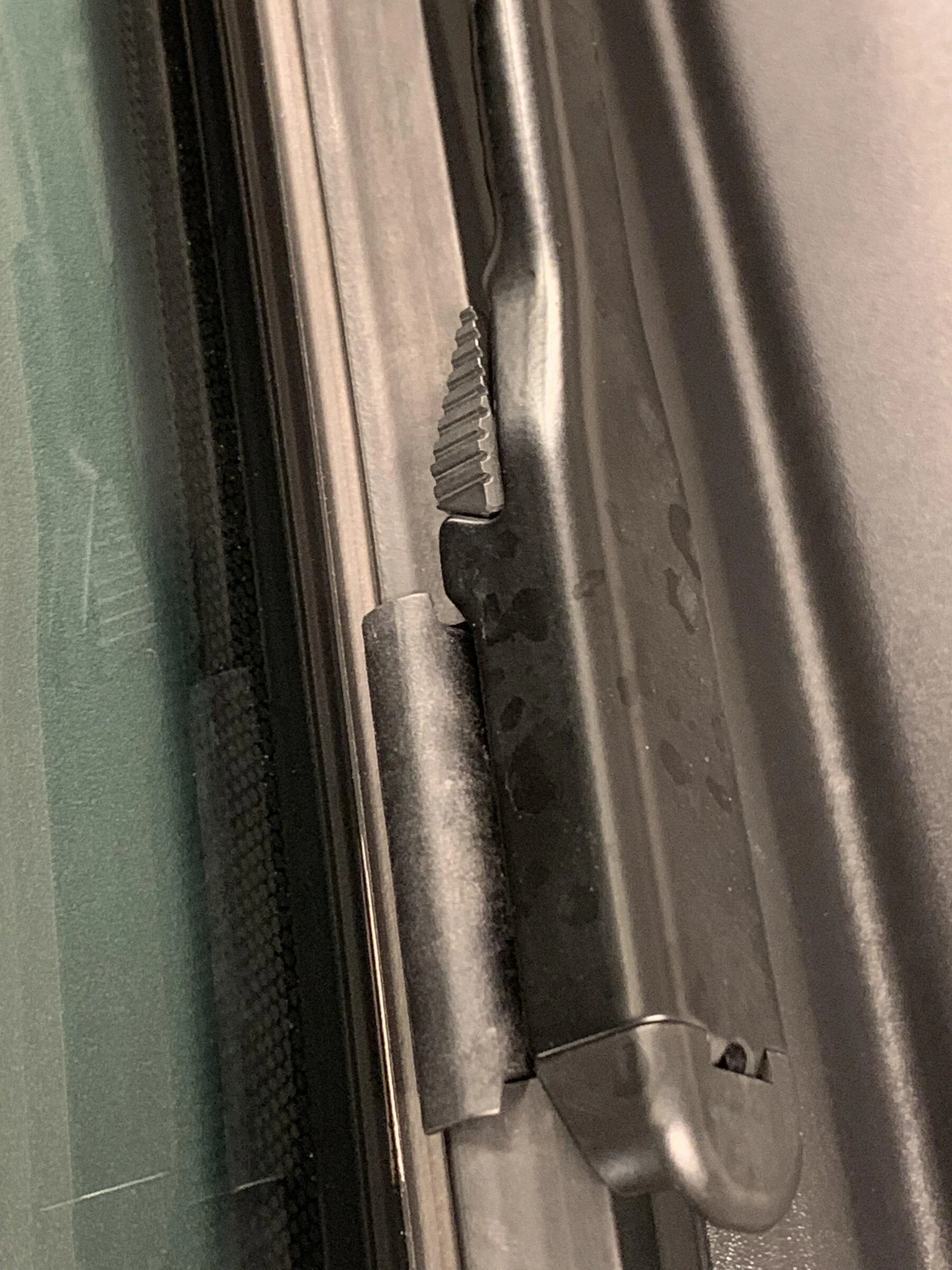

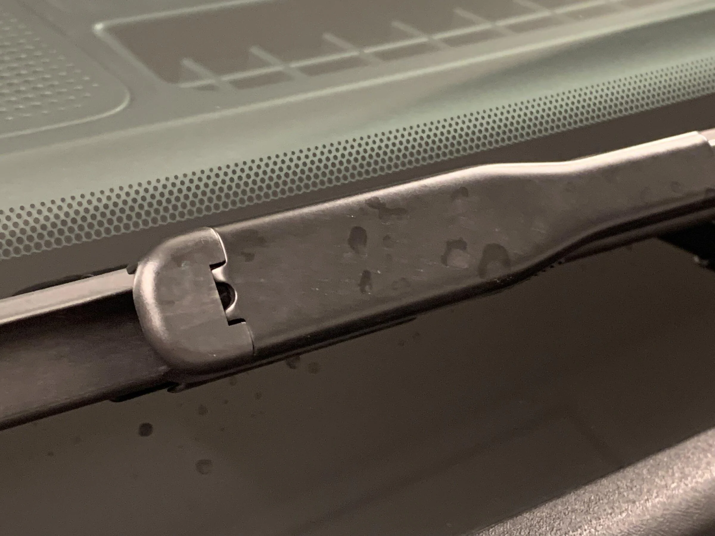

I have a really stupid question, that I expect to take heat on but I don’t care - how does one remove the wiper blade?
I read the owners manual, and it didn’t help. I see there’s two pieces you can squeeze on either side, but I don’t think I should have to use force to remove them. Any tips or pictures that might help?

From what I read in the OM you should be able to pull up that little "knurled" thingy to release the blade. And, then there is a little thing on the underside of the arm you push to get the blade to slide off. It's sad that something as simple as changing a wiper blade can be so danged aggravating. But, it's been a long time since I've changed a set that was easy, And, those are on my '67 Camaro.
Oh, one tip. Grab a towel, and lay it on the windshield just in case the wiper arm flops down. Don't wanna be cracking that windshield.

Thanks, I just figured it out.
You press inward the two plastic side clips you see in my picture, then while doing that pull away/outward from the wiper arm. It’s actually easy once you do it one time.
