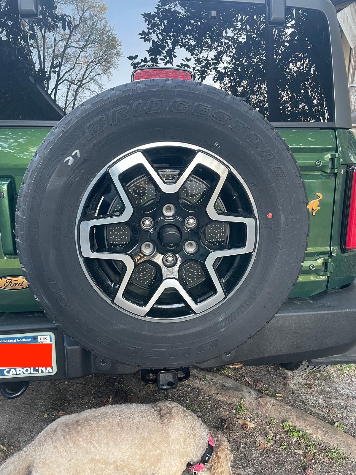

I used the supplied harness to tie into an aftermarket 4-way flat trailer plug. My Bronco did not come with the factory trailer wiring or hitch. All my additions were using the Curt 4-way flat system designed for the LED taillights.
I followed the Blanco Bronco video pretty closely. The wiring around the tailgate enclosure and then getting under the trim was key to making the entire thing hidden. I used a sturdier than supplied t-tap connector to get an input signal from the passenger side reverse circuit. I did not need to connect the blue wire to anything as my Bronco doesn't detect the aftermarket trailer harness; this harness is getting power independently from the aftermarket control box that has a direct line to the battery (with inline fusing and all that jazz).
All in all, the light has been powered on for about 2 weeks and I have not experienced any issues. The light has been attached but not wired up to power for about 6 weeks. I used double-sided tape to stick the light to the spare tire holder to make putting on the tire easier because otherwise, the light would jiggle around.
I can't speak to how waterproof my setup is, but it's been in multiple rain storms, drives on the beach, and a no-touch carwash since powering on and I've had no issues. DId it take me longer than advertised to install? Yes, but I'm also very new to all this and seriously took my time. Is it worth it? Yes - I really like the extra reverse lighting since my tint makes the stock reverse lights seem weak in the dark.

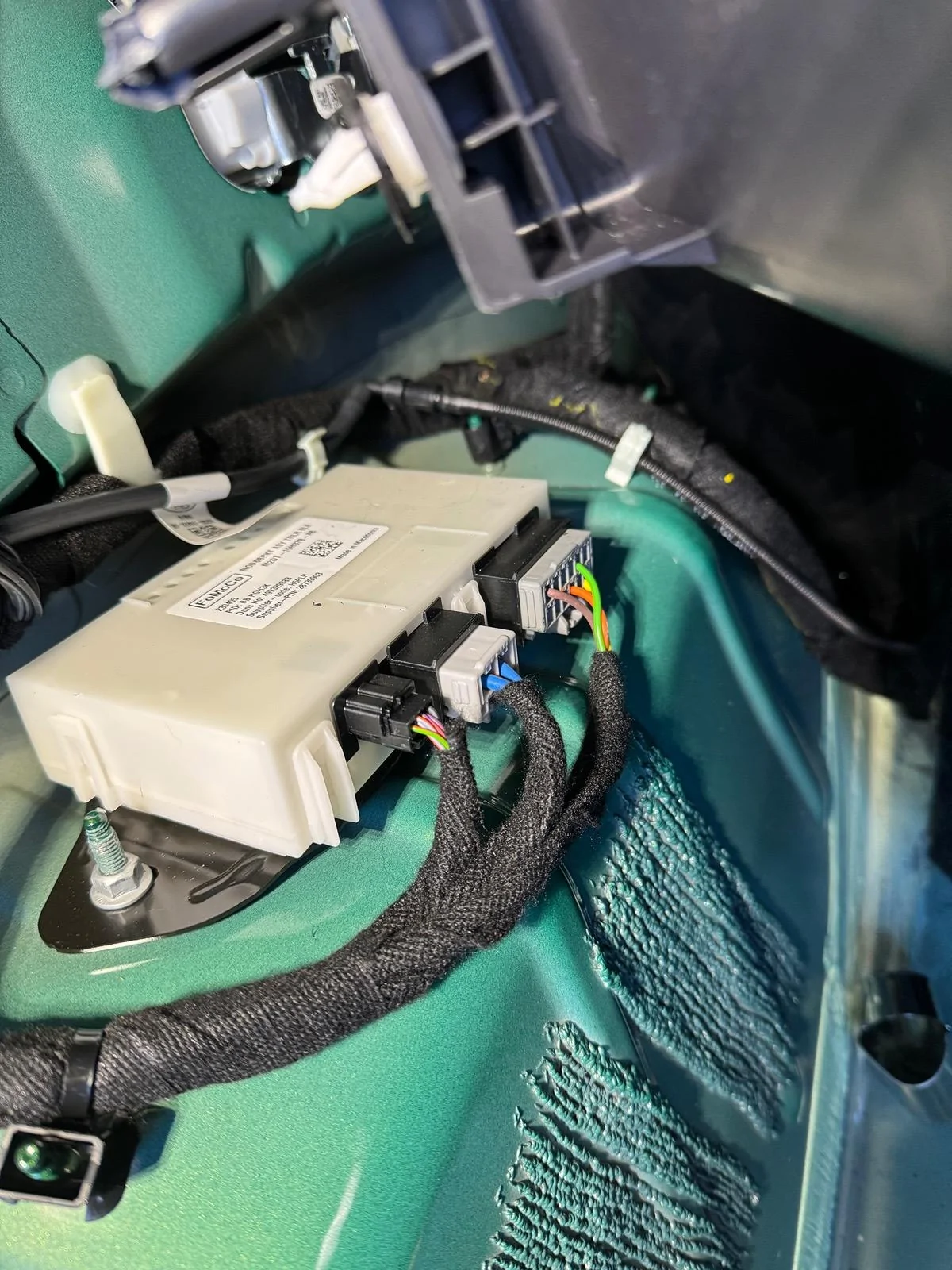

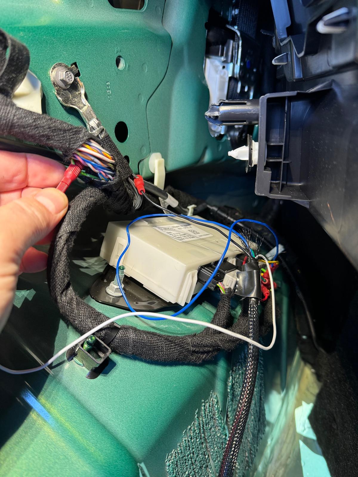

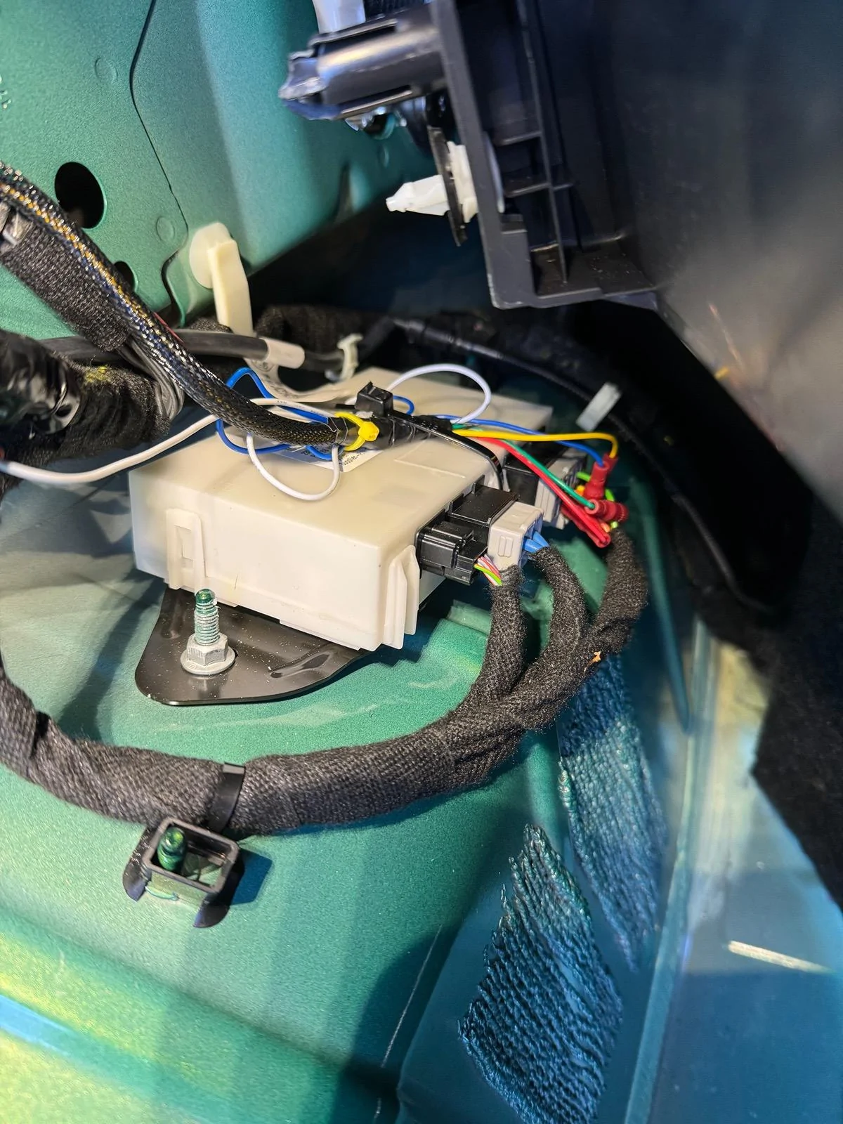

Their instructions were awful. I wired to the OEM tow wiring module behind the panel on the driver side in the cargo area. Tapped into the taillight there also. Nice and clean as well as protected within the vehicle.

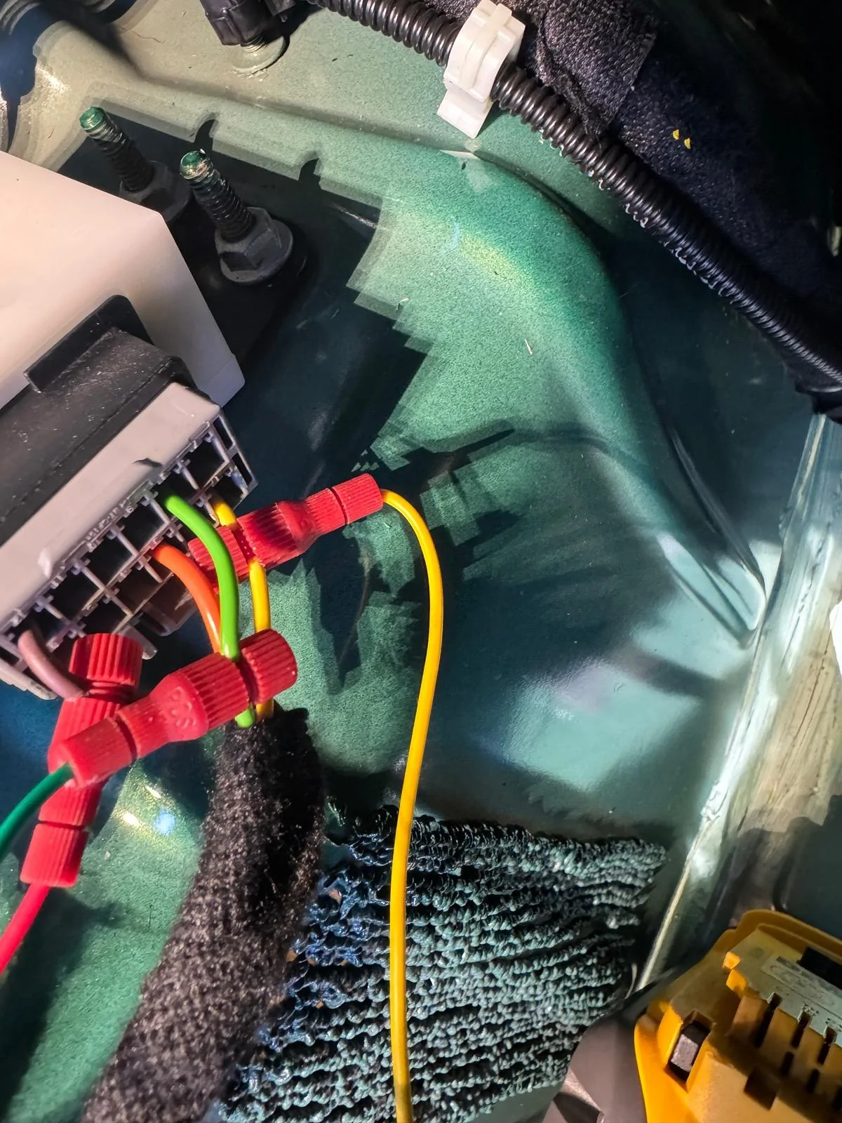

Yes. The wiring they provided reached if memory serves. If you follow their instructions to wire to the plug, the spliced are exposed to the weather (water and salt here). If you go to the tailight plug, you lose full functionality. My way, you avoid both problems.

Yes, I like this option better. How do you figure out which wires are which as there seems to be more there than just the hitch. Are they matching the hitch wires? Seems like the brown, orange, green, yellow, are the hitch. And the new black and white are for the reverse, off the taillight?
Oh, and what splicers are those?
Sorry Iā€™m not an electrical person, but I can follow ā€œdirectionsā€ ;)
Thanks so much!!!

I probably used some combination of this:
https://www.bronco6g.com/forum/thre...ronco-equipment-installation-guide-pdf.25649/
And
The towing module install guide. Thatā€™s here somewhere but most of what you need is in my pictures.
Yellow->yellow
Green->green
Red->maroon or whatever that is.
Blue->orange
Their white wire went to the drivers side taillight reverse wire I think. Itā€™s on page 24 of the Install guide above. Green/brown probably. Iā€™m going from memory. I meant to do a write up, but I didnā€™t want to help them sell any more.
And those are Posi-Taps. I bought an assortment of them from Amazon. Canā€™t remember which size I used for this install. Looks like these are it:
Posi-Tap taps 20-22 ga. Mini.... https://www.amazon.com/dp/B0B381X9NB?ref=ppx_pop_mob_ap_share
