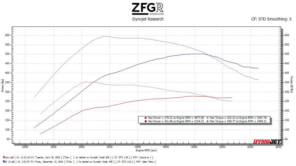

Last Friday, we spent some time on the dyno with Matt's 2022 2.7l Wildtracks Bronco. Previously, it made 404 rwhp on e85, which was great. Matt wanted a little bit more, so he added CR Performance Engineering stage 3 turbos and a port fuel injector upgrade. The results? 501rwhp and 588 ft-lbs! We were definitely limited by the turbine size and look forward to trying stage 4 turbos, but for now, the stage 3s are doing excellent with almost no compromise in spool time and are perfect for daily driving.

This is pretty insane! Is this a custom tune or just bolt ons and one of the canned tunes? I have a 2.3 and waiting till someone figures out custom tuning so I can get some parts and ditch the Ford Performance tune. The FP tune is decent but people have been tuning Ecoboost mustangs for a while and theres a lot more potential in even the 2.3. I don’t really understand why it hasn’t progressed yet.

There is no swappable ecu for the 2.3l right now that's the issue.
This is a custom tune

What was the fuel, E85?
Can I pre-order a Stage 4?

That's insane. Let's see this thing do a pull on the road. Love it and congrats!
