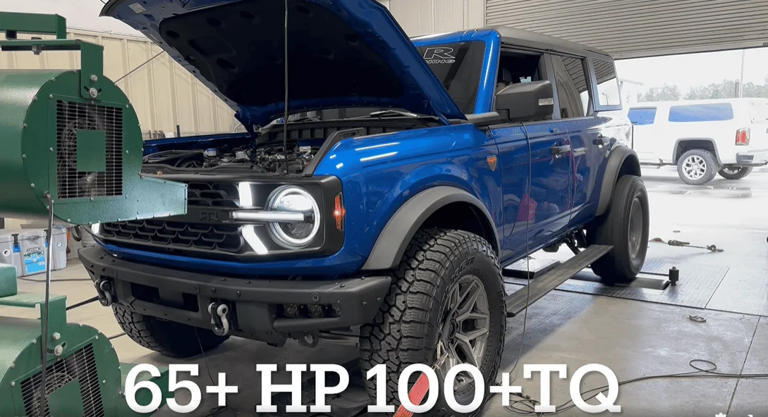

Spoke to Richie at 5-Star and he shared pricing and what it takes to custom tune a 2.7L Ford Bronco.
First off, let's talk cost.
SCT Device (Includes 3 tunes) = $799
New unlocked PCM = $999
This is the cost for 5-star to do their thing.
However, there's a caveat. You will need to bring your Bronco to a Ford dealer or certified shop and have them reprogram the new PCM with an FDRS device. There's currently no way around it, and I don't have an estimate on what this will cost.
Cleary Ford didn't make cracking the Bronco's PCM easy, but this is how it's going to be for the foreseeable future.
If you're interested, call Richie at 843-536-6288

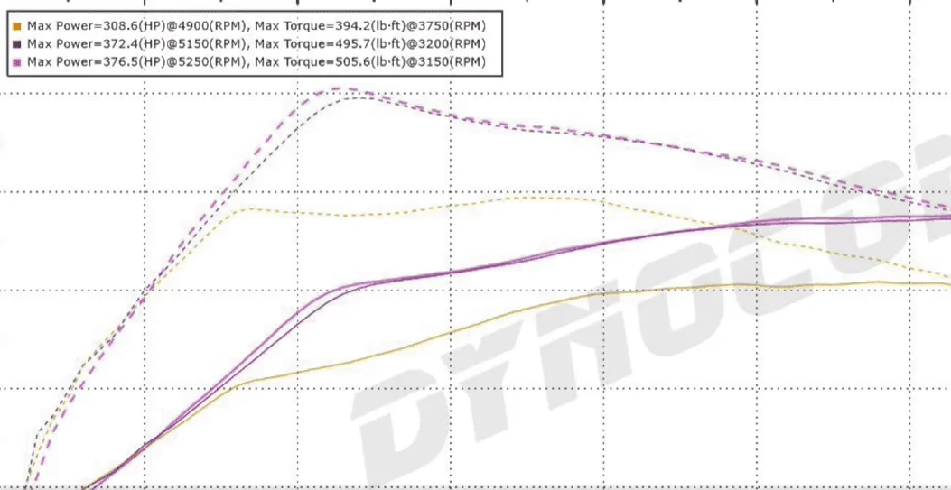

Below are the results on a 93 octane Tune. Sounds like they can do E30/E50, but it hasn't been tested yet.
Keep in mind, this is not stock. It has the below modifications, hence why the baseline is high:
  • SPD Downpipes
  • S&B CAI
  • Whipple Intercooler
  • Turbosmart BOV
