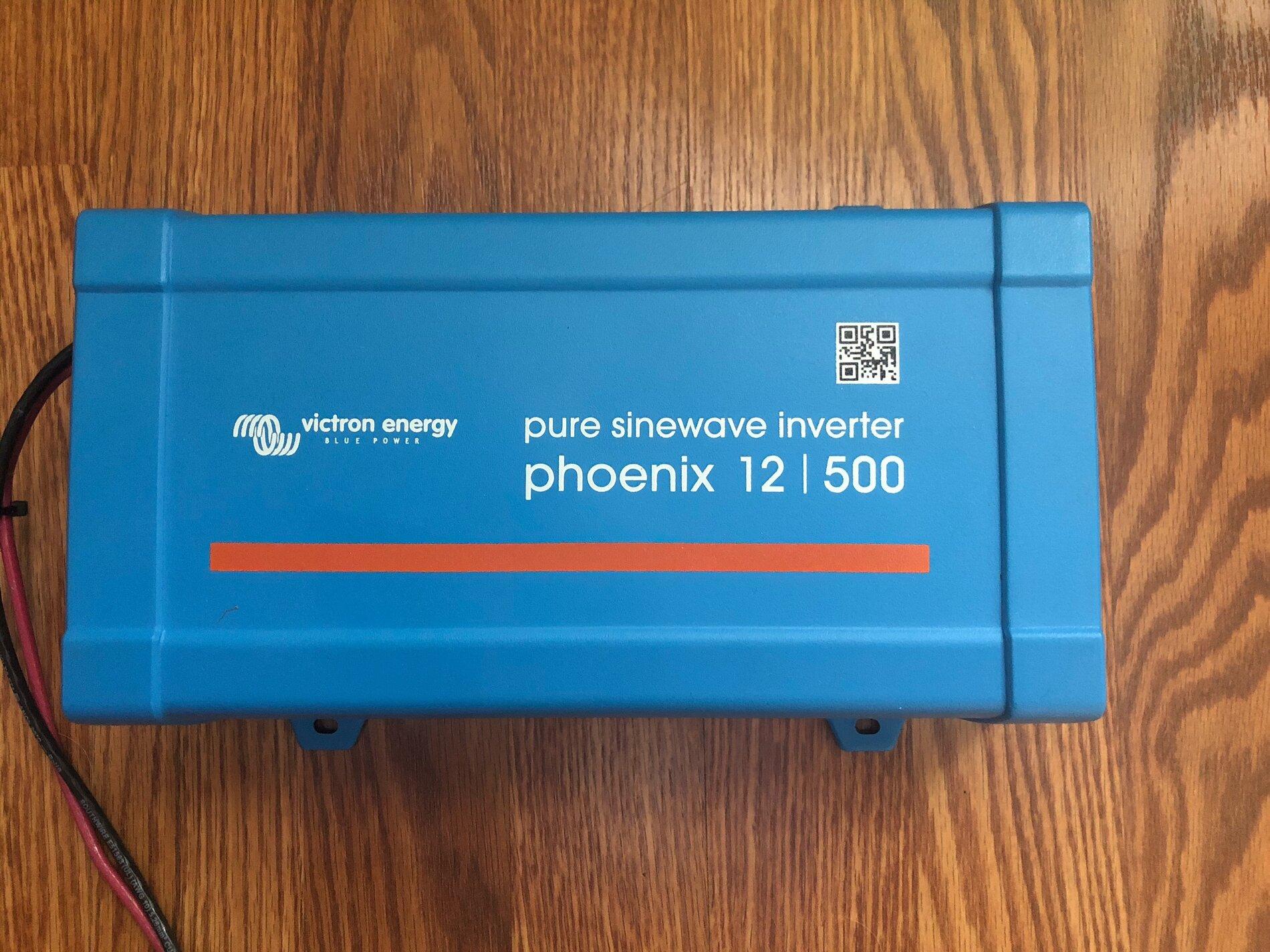

One of the best made inverters are from Victron, a bit expensive but good. If your cheapie inverter is a modified square wave, and your charger uses a full bridge wave rectifier to supply the DC for charging that's why it doesn't want to work. You need a pure sine wave inverter in that case.
This is my small one, works great on all electronics and they make a nice 1200 watt in this line, scan the QR code in the photo for info.
