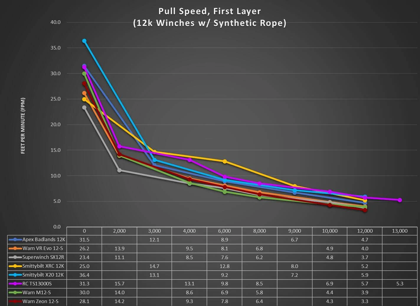

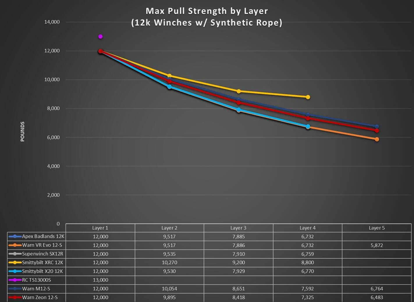

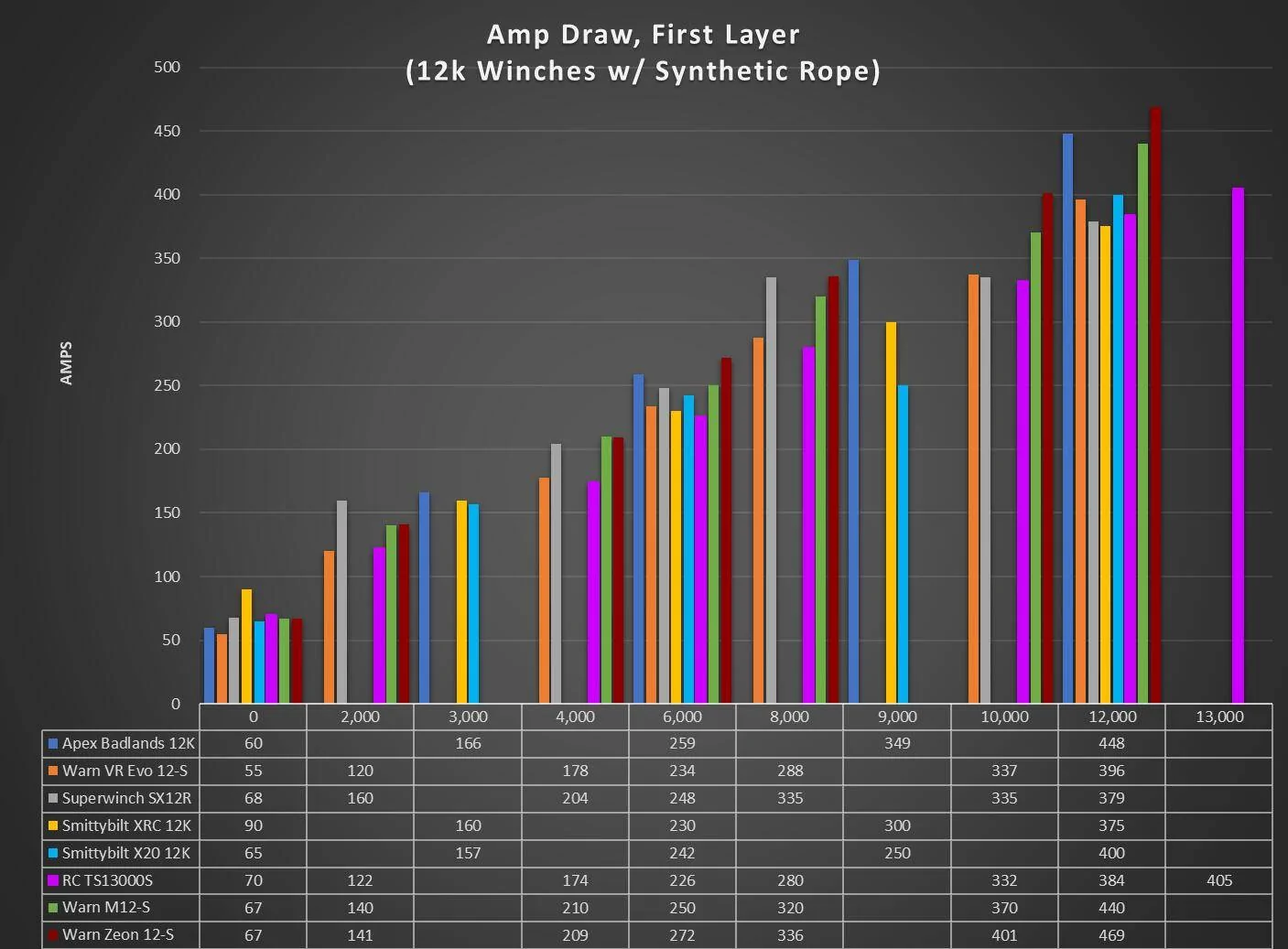

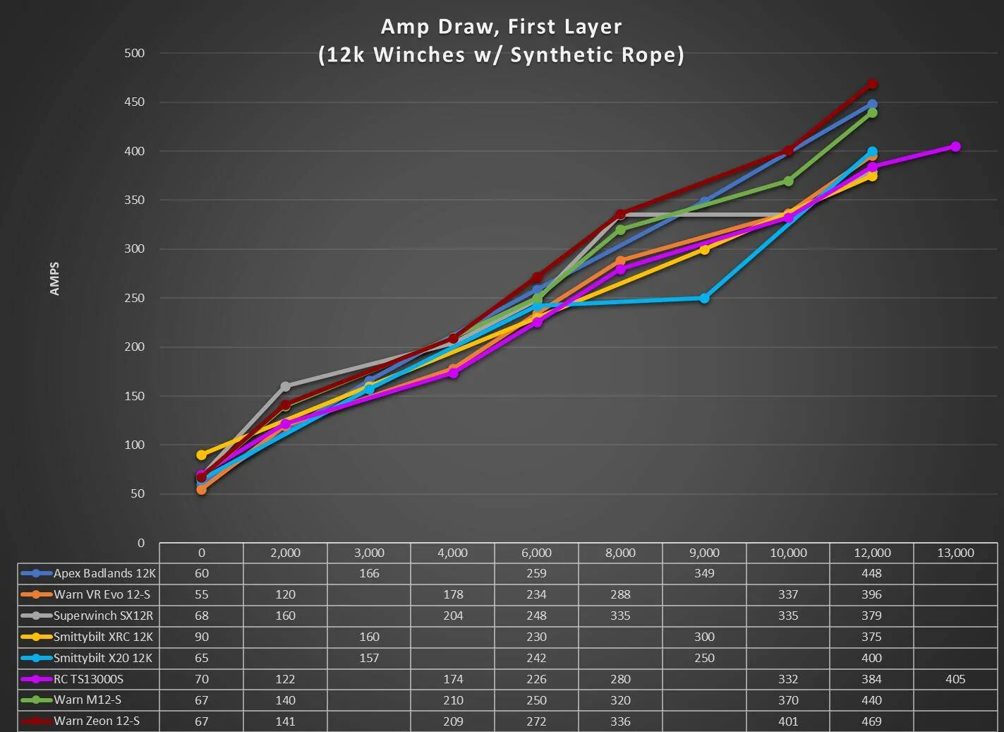

As we near the holiday season and BF deals start popping up, I thought maybe others could benefit from some of my research and analysis I did earlier this year when trying to pick a 12k winch for myself. It's easy to focus on the dollars only, but I have always looked at best bang for the buck. Sometimes that means I spend more dollars but get something much greater in return, at least that is the hope/goal.
Ultimately I ended up with a Warn Evo 12s. Mainly because I liked the warranty, confidence of knowing they would be around for easy parts/repairs/support & I got a smoking deal to boot.
A few key points:
1. Most data pulled directly from the manufacturer's website. A few I had to call or email and request the data. Overall, everyone responded & played nice.
2. All data was compiled back in May 2024 and based on the most recent generations available at that time which usually meant "Gen 3" but not always. Obviously specs can vary based on generation and you should double check. Let me know if you spot an error, and I will update.
3. I had the least confidence in HF Apex generation/specs. Mainly because they had about a dozen different manuals. I spot checked and they seemed to match for the most part. Not sure why so many. If it's like their 44" toolboxes, it's because they have minor variation between plant locations so you end up with several different model/SKU's.
4. Both line & bar charts are provided for each primary segment. When values are near identical like pull strength, the line charts can be difficult to read. However, when you have multiple testing intervals by different manufacturers like line speed & amp draw, the opposite is true. Hopefully one or the other is helpful to you.
5. Charts state "synthetic" but all test values collected were not different for steel cable or synthetic rope.
6. Charts and test data don't tell the entire story. Duty cycle comes into play and needs factored in. I was going to add various manufacturer recommendations but didn't make much traction. The Apex manual has a printed duty cycle they recommend. When I called Warn, the rep flat out said they didn't duty rate anything but their industrial winches and had no interest in sharing any practical advice other than feel the winch and stop when it gets warm. The Superwinch rep was very nervous to answer the question and stated to run 15 seconds and let rest for 45 seconds and then repeat.

Ford Bronco 12k Winch Comparison: Pull Strength, Pull Speed, Power Amp Draw 1731948290087-ut
Ford Bronco 12k Winch Comparison: Pull Strength, Pull Speed, Power Amp Draw 1731948342264-oi
Ford Bronco 12k Winch Comparison: Pull Strength, Pull Speed, Power Amp Draw 1731948371577-n
Ford Bronco 12k Winch Comparison: Pull Strength, Pull Speed, Power Amp Draw 1731948398662-sd
Ford Bronco 12k Winch Comparison: Pull Strength, Pull Speed, Power Amp Draw 1731948419256-zu
Ford Bronco 12k Winch Comparison: Pull Strength, Pull Speed, Power Amp Draw 1731948451137-35

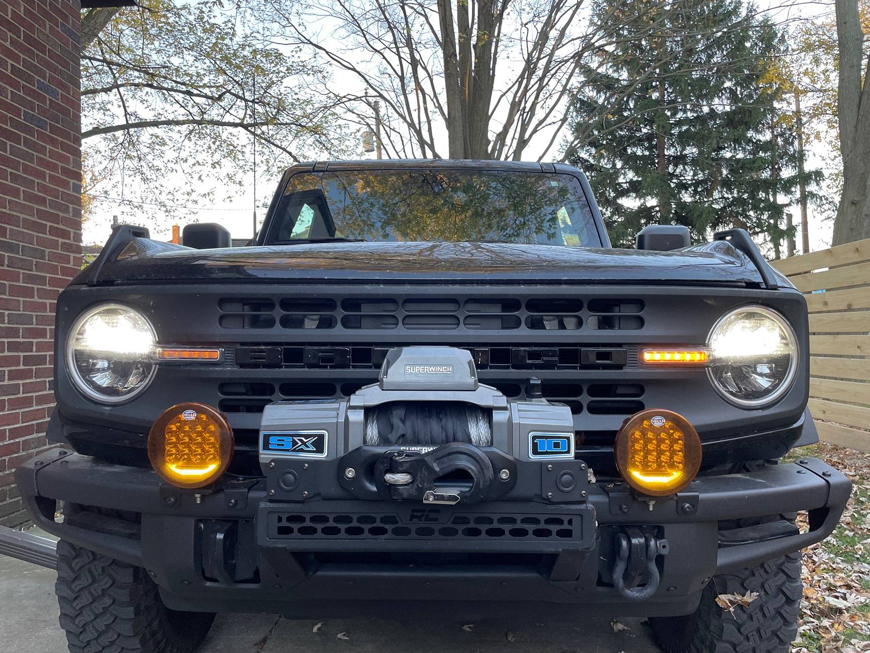

Was hoping to see SuperWinch included here. But I realize it’s not one of the commonly considered options. I’ve used it for a few non-recovery tasks (like pulling on root balls/stumps). No recoveries necessary since installing 10ish months ago. That must be the mark of a truly great winch - deterring recovery situations…. 😂
Actually Superwinch was included. In the first chart, it's 3rd down from the top and it's color is grey throughout all the charts. However, I noticed that I had the labeling incorrect. Previously it was Superwinch SX12 which is the WIRE version. I have re-labeled and re-uploaded new images to show Superwinch SX12R which is the synthetic version. Per Superwinch's catalog data, they do not differentiate any performance variation between wire or synthetic rope so the tech data was correct, just a labeling issue.
https://www.superwinch.com/public/m.../7d0187e305c518c99c178662a2304221.pdf?v=0.1.2
Hope this helps. By the way, Murphy's law....when you need a winch, you won't have it. And when you have a winch, you will only need it to help others. I much prefer the latter. :cool:
