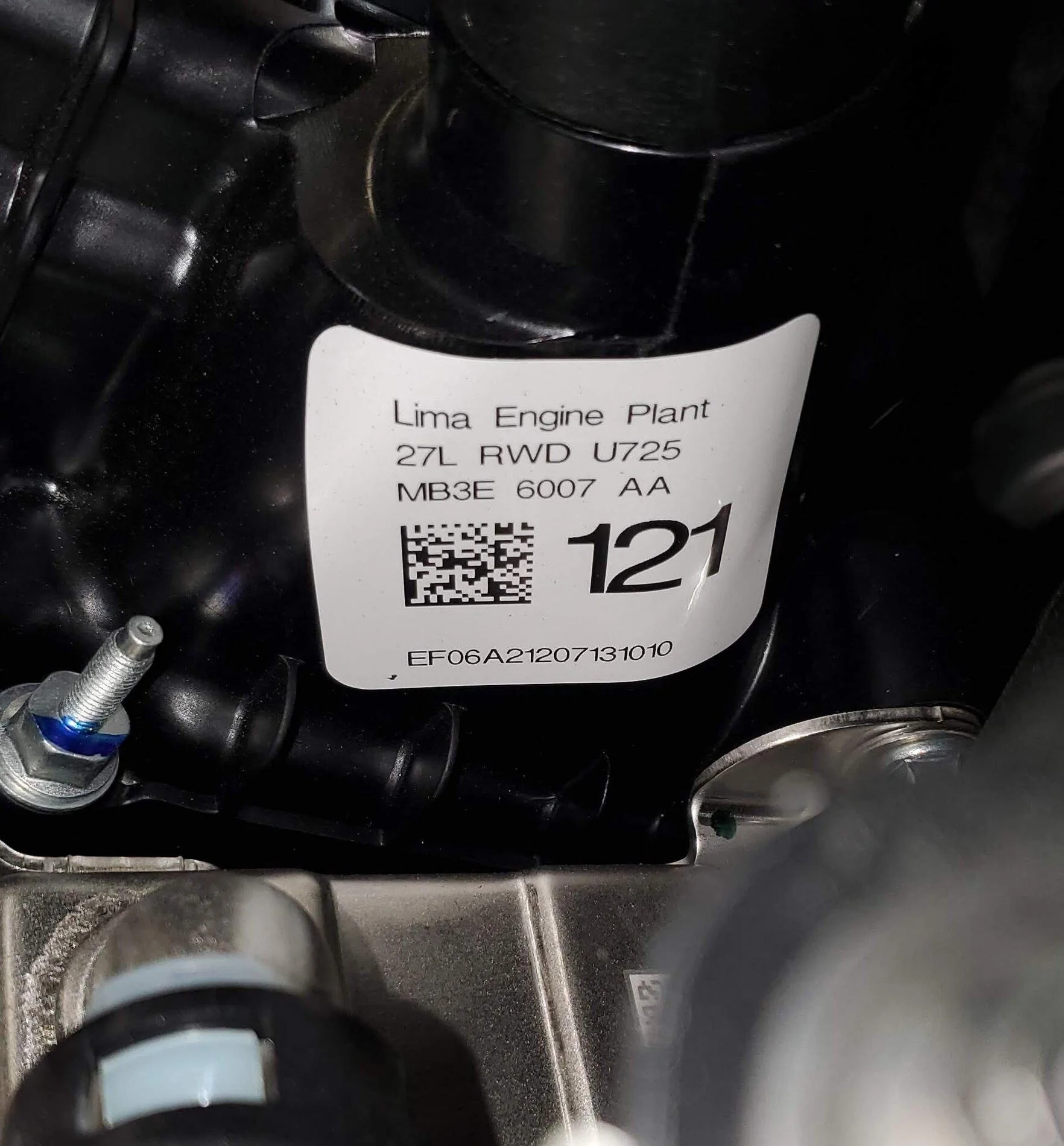

User: estone
Failed Part Number: MB3E-6007-AA
Engine Julian Date: 21207
Engine Sequence Number: 131010
Mileage of failed motor: < 1000
Cause of failure: Valve
Replacement Part Number: Unknown
New Engine Julian Date: 21XXX
New Engine Sequence Number:
So if the last six digits after the Julian date are the engine sequence number, someone is going to have to explain to me why I have the same Julian date and engine sequence number as @estone28 (21207 131010)

Some debate if his julian number is actually 21209
Yup, I went back and checked his original thread. 7/28/21, at least that's what his dealer told him, so that would, indeed, be 21209.
But, are engine sequence numbers unique to each build date, or are they a running, sequential number that just continues to increment day by day? I can't imagine they build 131K engines each day. Maybe the digits in the sequence number are broken down into multiple fields indicating something other than a sequential number. Still a funny coincidence!
They are definitely not sequential, and I think the 12 and 13 (or the 2 & 3) after the date have some other meaning, since we have both appearing with earlier and later dates. My date is 228, but my sequence starts with 12. Could be a line or shift indicator?
Only Ford knows definitively. The guy that blew up on our build week(blend 9/7) got me a bit nervous. That's for sure.

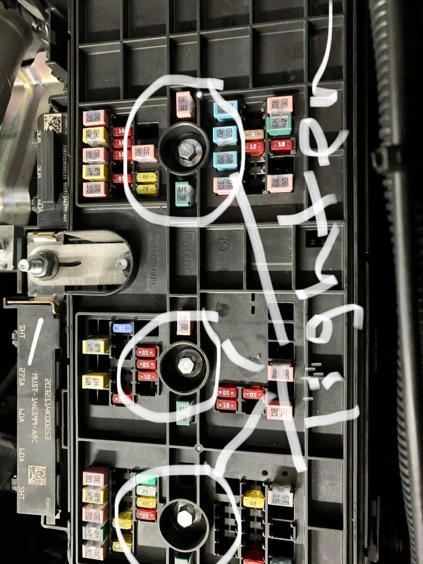

Another issue reported recently was loose bolts in the fusebox.
Ford Bronco 2.7 engine failure tracking thread - Ford Please! loose bolts
Because I probably made a typo and it's actually 209. I will correct it.
