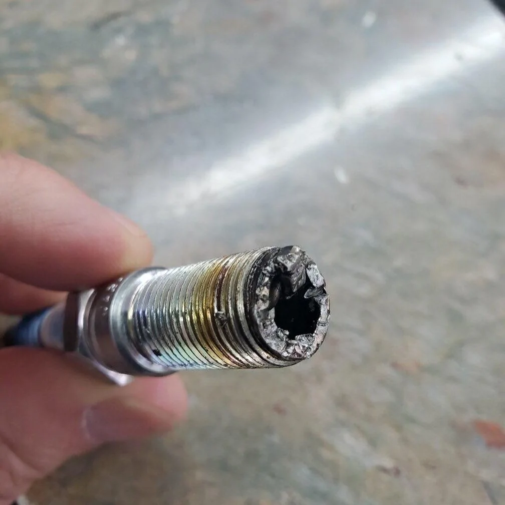

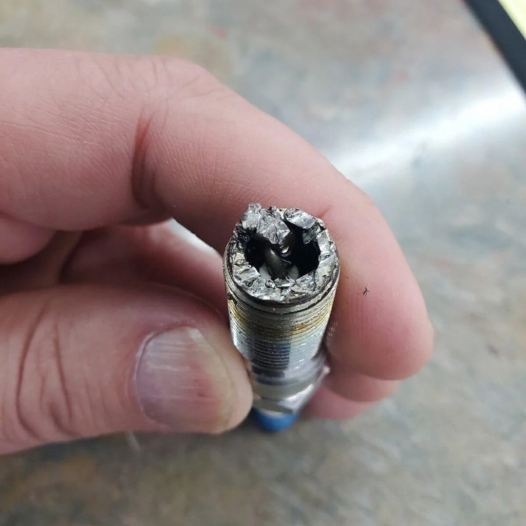

That’s me. I don’t have any details other than what the dealer sent me on Friday. The sent me photos of the spark plug and the scope pictures. Bronco has 2000 miles and a build date late October. We took delivery on the 5th. Was at the dealer on the 3rd.
Didn't see any signs of detonation...

I would swear that looks like detonation, most likely due to a fuel system failure under boost is my guess... Not that I have ever seen that happen on the dyno.
That's definitely a picture that Ford doesn't want getting out.
With no other information my best guess, one of the two fuel pumps failed or one of the injectors stopped firings (or had severely compromised flow). Detonation can destroy motors in mere seconds.
