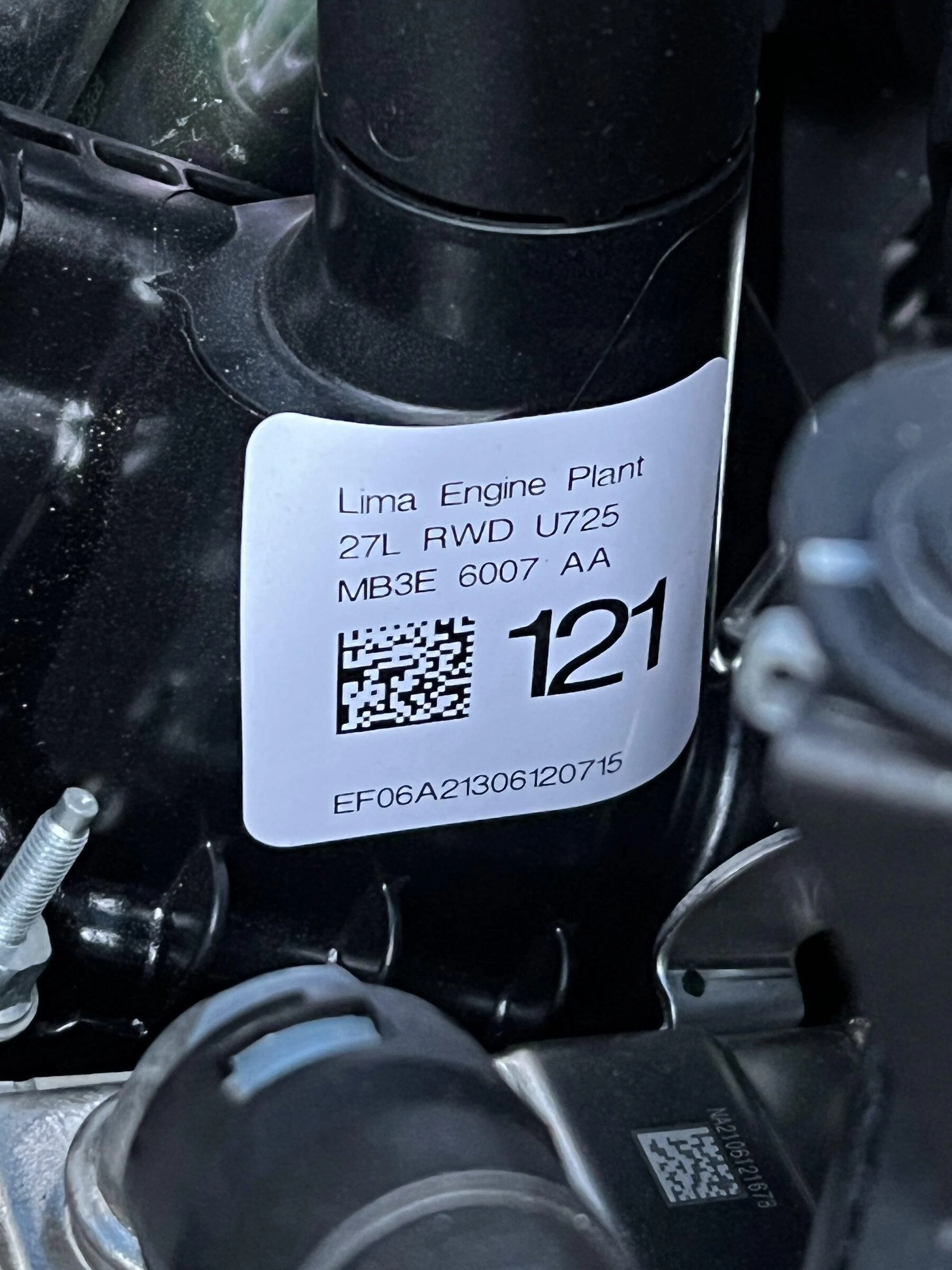

Should I be worried? I’m not sure how to decipher my engine build date (I understand the 2021)
Went into production 11/09/21, delivered 11/22/21
Thanks for your help
Ford Bronco 2.7L blown engine failure list . . 68 so far [Updated: December 13, 2022] 6BA504E6-F80E-4E42-AEBD-4179A9097FE1
Gina,
The "306" after 21"306" means that you r engine was manufactured on the 306th day of 2021.
or November 2, 2021. It is the AA suffix, if you look above the large 121. Should you be worried?
There is an unknown percentage of failures for the AA revision engine. It's covered by warranty and no sense worrying about it.
