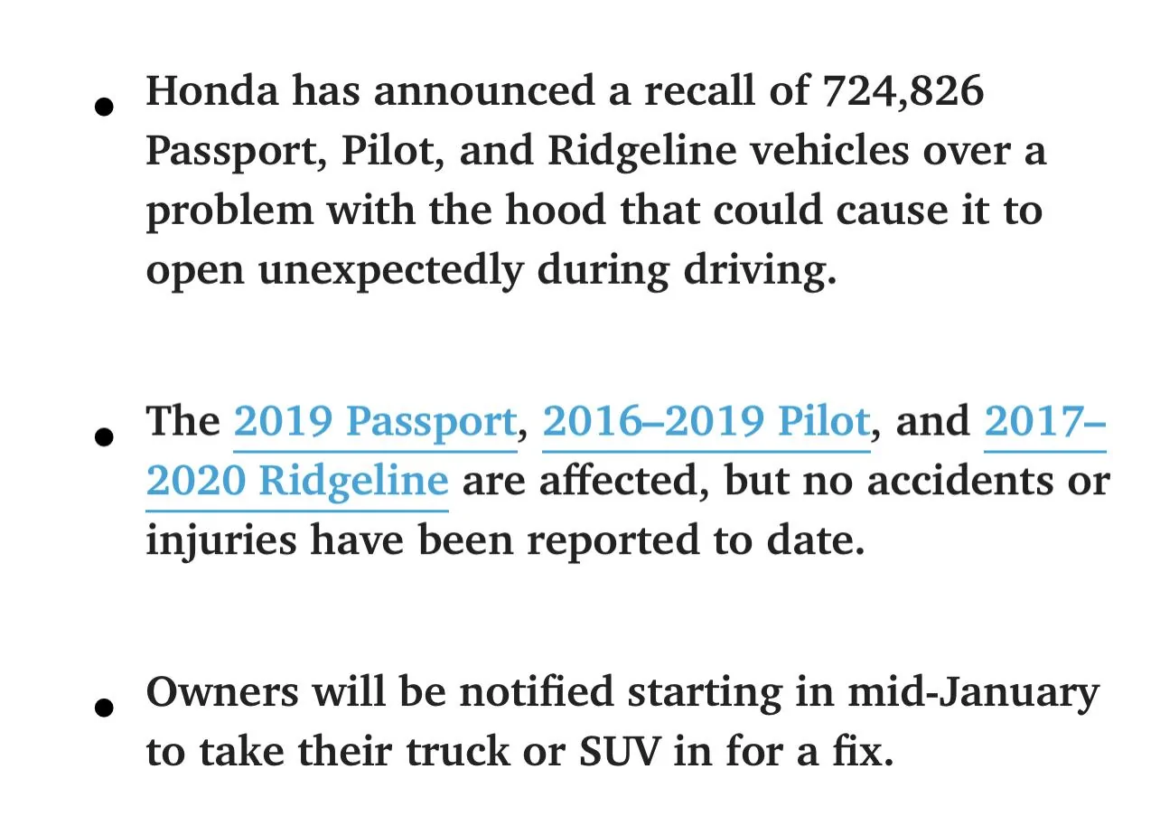

I just received a recall notice for my Honda Pilot’s hood latch. This is what honesty and transparency looks like. This is why I have been a loyal Honda customer and trust them. No accidents or injuries reported but they still issue a recall and get the problem fixed for their customers. What will it take for Ford to do the same?
This is far from the first self-opening hood problems that Honda has experienced. I don't know how many specific recalls they have done over th eyears for the same thing but do know they refused warranty coverage on a Civic whose latch attached to the radiator split off top of rad, and hood smackjed into windshield. Warranty was no good because of an aftermarket cold air intake

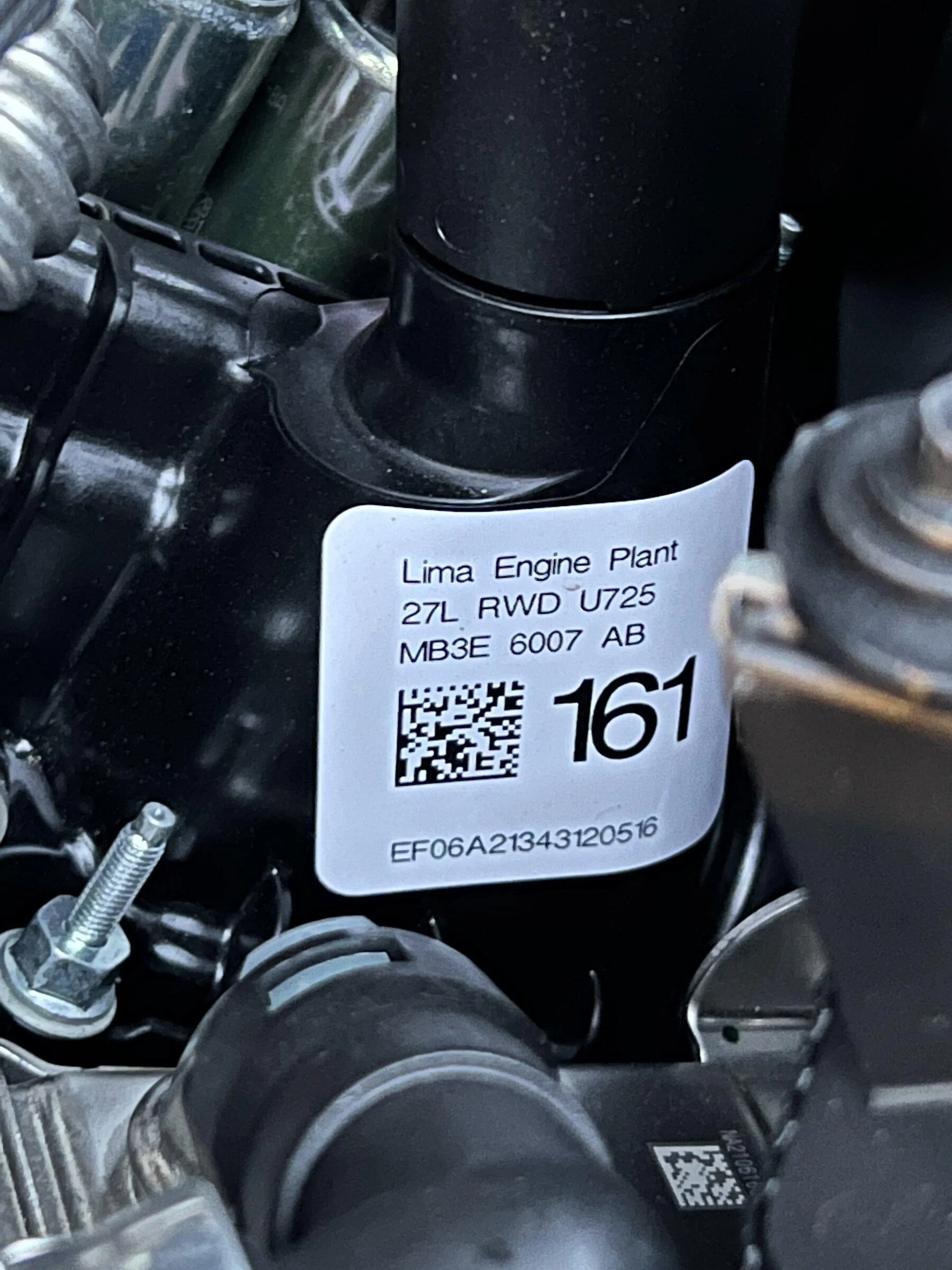

This is very imformative and I'm trying to decide on if I should take the chance buying one from a local dealer...It was built in January 2022 and engine sticker has AB on it and built on day 356. I know nobody knows but this makes me feel like I would have a better chance of it not going out on me.
21BL2DR
JD
Oct 22, 2021
448
902
ohio
2021 BL 2dr, 2021 BB 4dr, 2022 BS 2dr, trifecta
ii guess I need to get the date mine was built and see where it falls. 2222 miles and zero issues so far.

Did he ever post a photo of his engine label?

2022 with a blend date 12/23/21, shipped 1/6/22, delivered 1/24/22. Currently at 995 miles and no hiccups so far.
