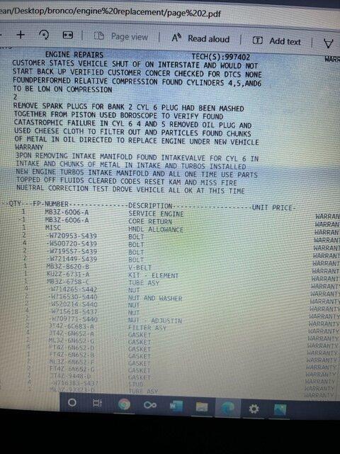

Please look at the pic of the invoice I received from the dealership when I picked up my Bronco after engine was replaced. Mechanic stated pieces of the valve were in the intake manifold!
That's excellent info...and racing has taught me that that is EXACTLY what happens when an Intake valve is dropped at high rpm...remember the other cylinders are still running, and with no intake valve to stop it, debris gets sucked back into the intake, and redistributed to other cylinders. all happens in a millisecond...nothing you can do to stop it
