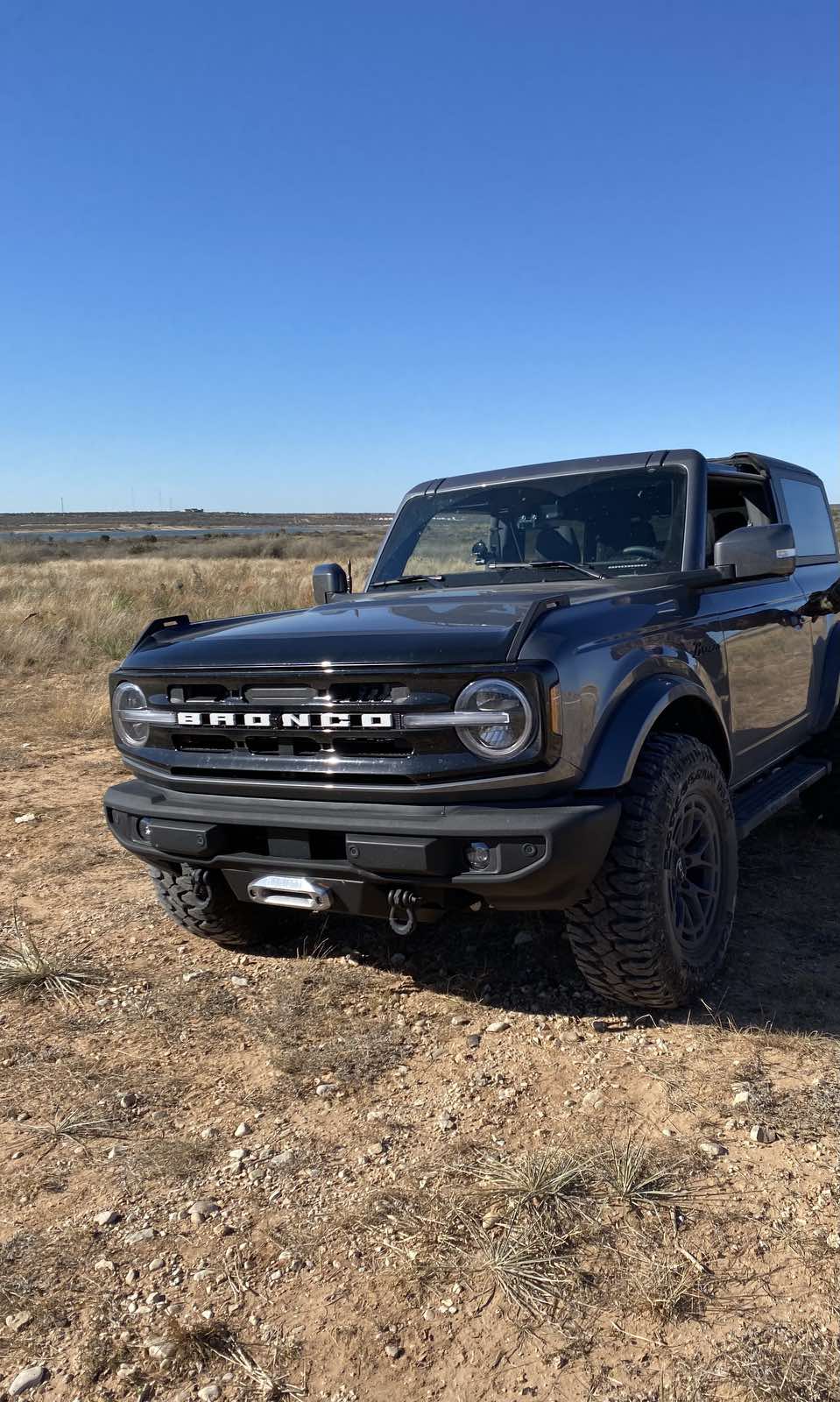

I have a Bronco, that means that I have 2 doors. ;)
Ya, it's a pig normally because I have a heavy foot.
My highway average is about 17 mpg though.
Saved plenty of weight by going 2dr instead of 4dr -- enough to tow a brand new 2.7L crate motor with you wherever you go 🥲
All jokes aside, love the look of your 2dr. The wheel and low-profile winch combo are great.
