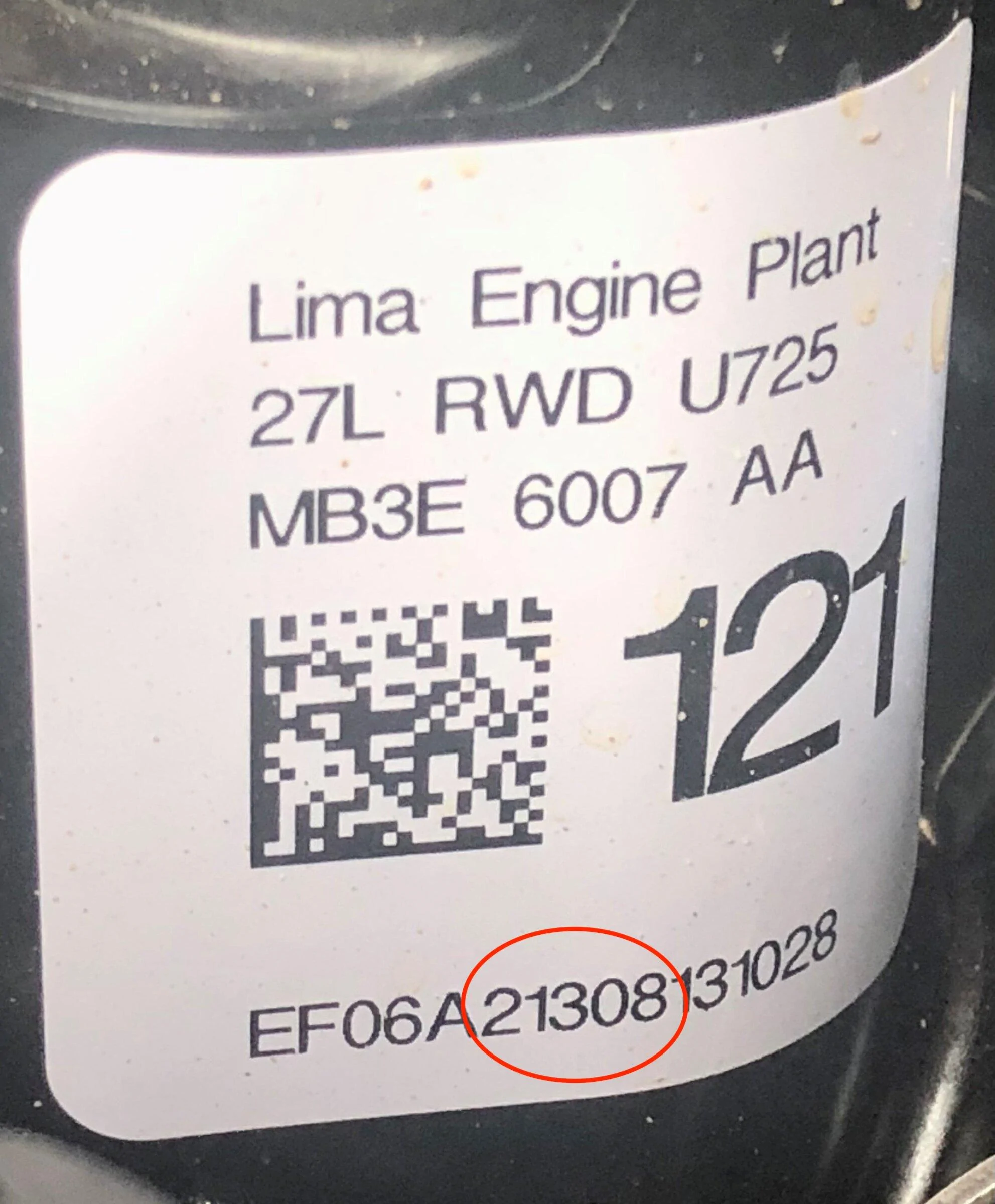

If Your Engine Fails - dealer service of course - also :
- good to call Ford Customer Svc - expedite repair, communication, cover rental
- good to send VIN & full name to @Ford Motor Company here in B6g
- and the engine ser# would be very helpful in B6g build-date tracking efforts
example Engine Ser# Labels -
- B6g trying determine if the failures are confined to a range of engine build-dates
- maybe they were all built in same couple months ? - see also 2.7 Failed Engine Tracking Thread
- for eleven of the engine failures we have the build-date info
