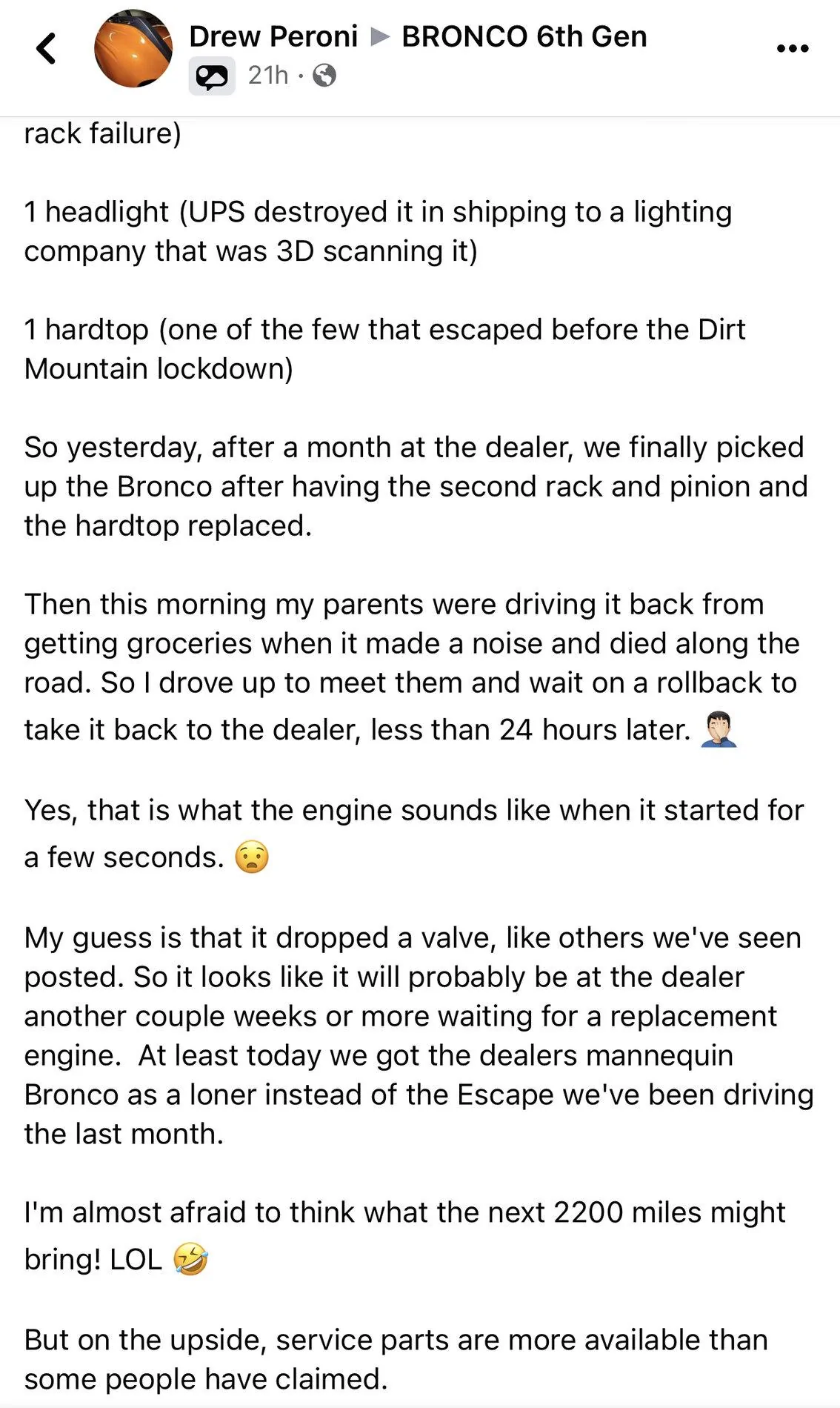

Anyway, I asked if he had heard anything through the grapevine as to what is happening with these select few 2.7L engines dropping valves (I've read at least 8 stories of this happening). I know that this isn't a huge number by any means in the world of statistical significance. He told me that he wouldn't be surprised to hear that Ford puts out something soon about it.
I believe the Bronco I had at the off-roadeo suffered the same thing. It died 100 yards into the trails (really just a dirt road at that point). I was in 4L, no stress on the engine and it made a horrible clanging sound for about a second and died. Had to get towed out. This was probably a pre-prod model with about 400 miles on it.
