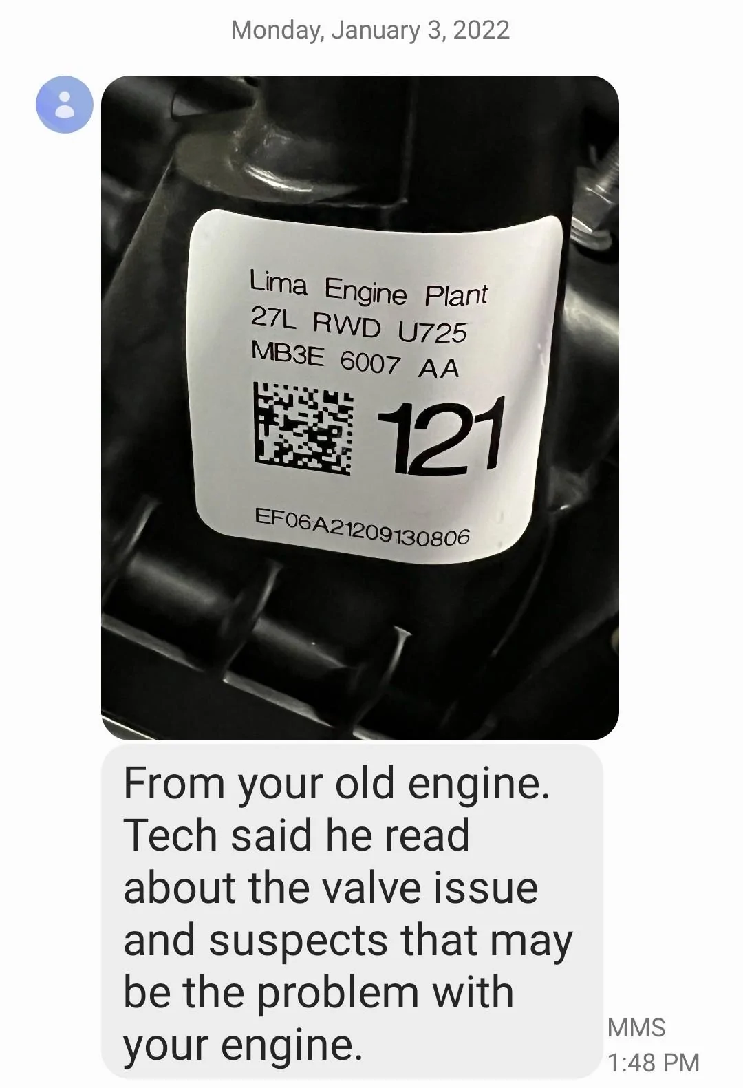

1) @mmcq - thread** - fail~July 21, 1146 mi
2) Jose Hernandez - posted - fail~Dec 2 ?
3) @jeremy.wilson237 - 1st post, further - fail Dec 10, 2012 mi
4) @ToddGinGA - 1st post - fail Dec 5, 1358 mi
5) @Bubbabow - 1st post, further - fail Nov 21, 4000 mi
6) @Nikole - 1st post - fail~Nov 1 ?, 2900 mi
7) @Hailey Jo - 1st post - fail Dec 4, 3581 mi
8) @Lance103222 - 1st post, update - fail Dec 23, 2024 mi
9) father of @Shinoko - 1st post, further - fail Nov 21
10) @estone28 - thread** - fail Oct 21, < 1000 mi
11) Steve Seale - posted - fail Oct 22, 0003 mi
12) @Broncoshrimp - thread** - fail Sept 10, 2400 mi, new 2.7L
13) fbf of @bytheway - 1st post - fail Oct ?
14) @yogi_stvl - 1st post, further - fail Sept ?
15) charr124 @BN - posted - fail Oct ?, 1524 mi
16) @roofone - posted - fail Sept ?
17) @69 Mach I - thread** - fail Nov 14, 2744 mi, new 2.7L**
18) @Broncitis - posted, further - fail~Nov 5, 2200 mi
19) @Broncitis - replacement also failed - Dec ?
20) @International_George - 1st post, thread - fail Dec 24, 1795 mi
** threads covering their repair experiences - (lines 17, 10, 12, & 1)
- so far the engine build-dates run 21160 - 21216 - see how to read Engine Ser#
- ? corrections ? other posts overlooked ?
- the frequency of failures seems less than last month
- in October a Ford employee (@Jay3630, deleted soon after) made five posts re 'bad batch of brittle valves' - 'April batch' - see posts #1, #2, #3, #4, #5
- if the failures are caused by 'bad valves', maybe that 'April batch' has been working its way thru the system - then the problems could subside
If Your Engine Fails - dealer service of course, also :
- good to call Ford Customer Svc
- good to send VIN & full name to @Ford Motor Company here in B6g
- and the engine ser# would be very helpful in B6g build-date tracking efforts
example Engine Ser# Labels -
Called the dealer and got my Ser#. I hope this helps!

I picked mine up my two door Black Diamond today and my date code on the engine is 21166 with 50 miles. wish me luck
