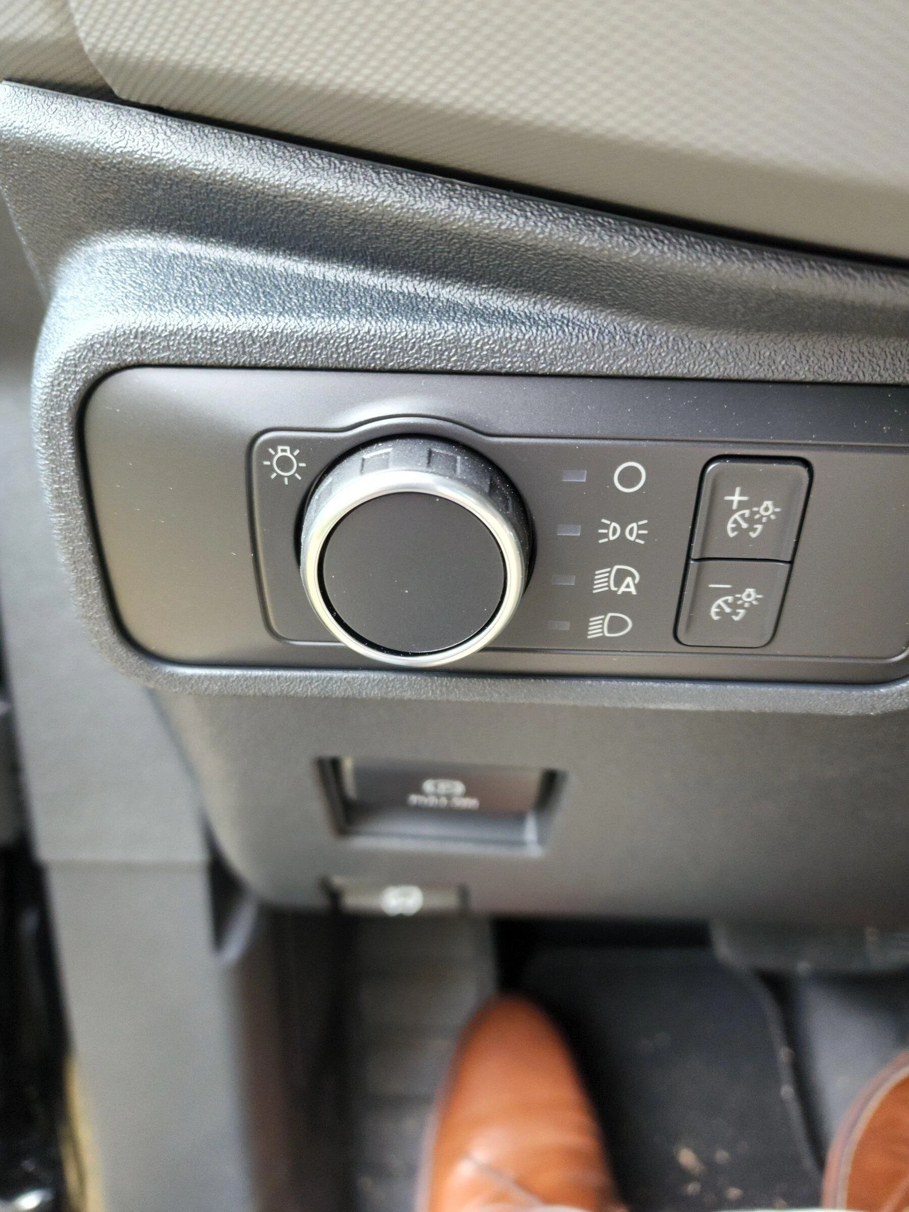

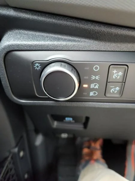

My Headlights will automatically switch to "On" every 3 days. I will open my door and the lights on chime will start going off. I look at my Headlight selector switch and it will Not be illuminated. The photos below show what it looks like for me vs what it is supposed to look like. When the switch is not illuminated, the headlights will be on until I turn the switch to turn them off. When it is in this state the headlights will never turn off and the dash/infotainment system it on as well. Is there anyone having the same issue?

Loose fuse? If on auto maybe the fuse for the sensor isnā€™t in so the headlights default to on?
do you leave it on auto headlights? I havenā€™t had the same issue, but have noticed that although I leave it on auto headlights, often the dash shows it is regular headlights (the A is not shown) until I toggle the switch away from and back onto the auto headlight location.

I always keep it on auto, I never touch the knob. I do know that the Bronco's default to Auto every time you start it.
Like this morning when I first opened my door, it will chime like I had the headlights on and I haven't even been in it yet. That's when the selector switch will not be illuminated.
