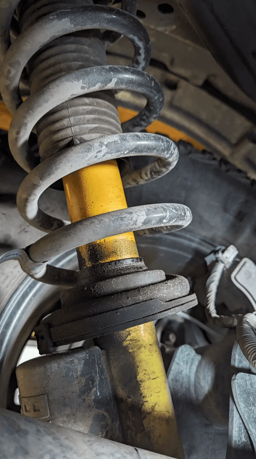

I’m a tech by trade and understand what everyone is suggesting and agree residual oil is normal given many factors. Residual fluid leaks would be from two components that would be moving/contacting one another correct ? ( ie piston shaft of the shock & the lip seal), NOT from something that should be a solid / sealed and/or welded component? The shock is charged with nitrogen and a form of lubricant.
Really it’s not the end of the world, just disappointing

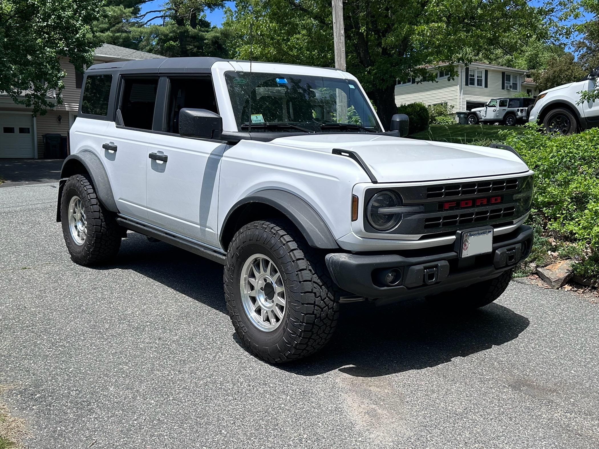

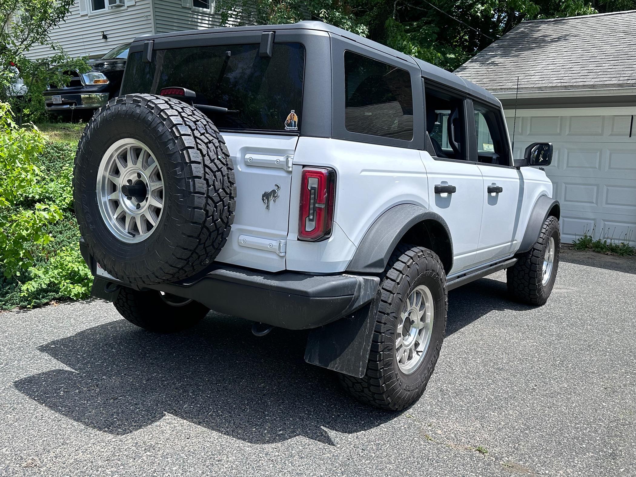

Here’s a shoot of the tire wheel setup
Is that grill unpainted in the middle? I'm looking to do the same painted surround on a Black Diamond grill but I'm not sure if the transition from paint to unpainted plastic would look weird.

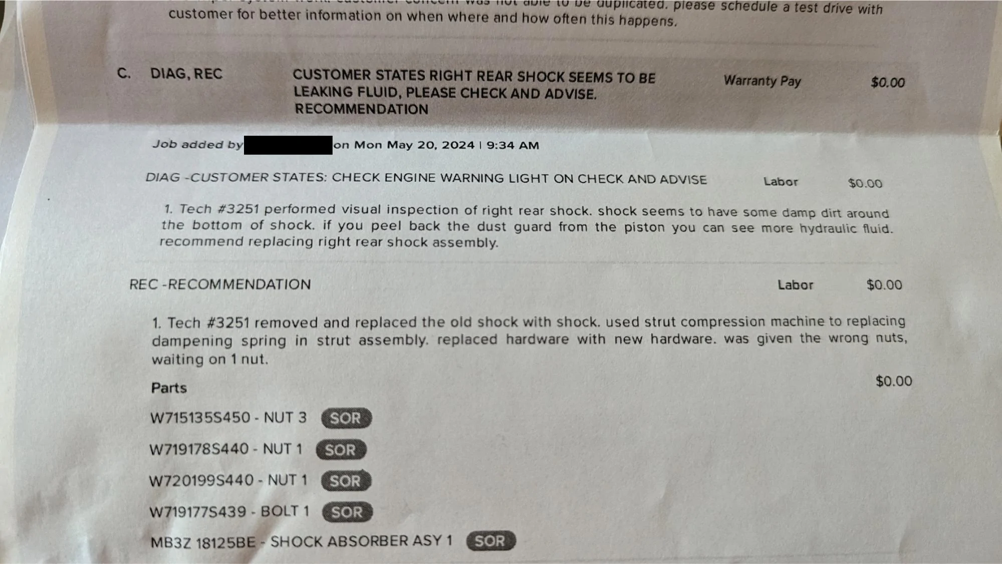

The rear right shock on my 2-door had been leaking since it passed the 10k mark. It has 15k miles now. When I was dropping it off at the dealer for another hardtop replacement (I'm on my 4th hardtop now), I asked a service writer to have the shock inspected. Luckily, Ford agreed to replace it under warranty.

Honestly, the stock Bilsteins are not premium shocks. They are a wear item, and some items wear faster than others. They are cheap if you just want to replace it, or better yet take the opportunity to upgrade.

Seepage IS a leak
I’ve swapped the grille for an OEM Heritage with matching red ford lettering. The center color is acutally sprayed carbonized grey with Oxford white on the outer perimeter. I’m also doing the center dome of the hood, side strips and wrapping the rollbar.
22k highway miles, 4 months parked in the winter, 30 days at the dealer and not even seeing dirt yet is ridiculous to me. Wear item yes, leaking shock oil and nitrogen thru a welded component = NO.
