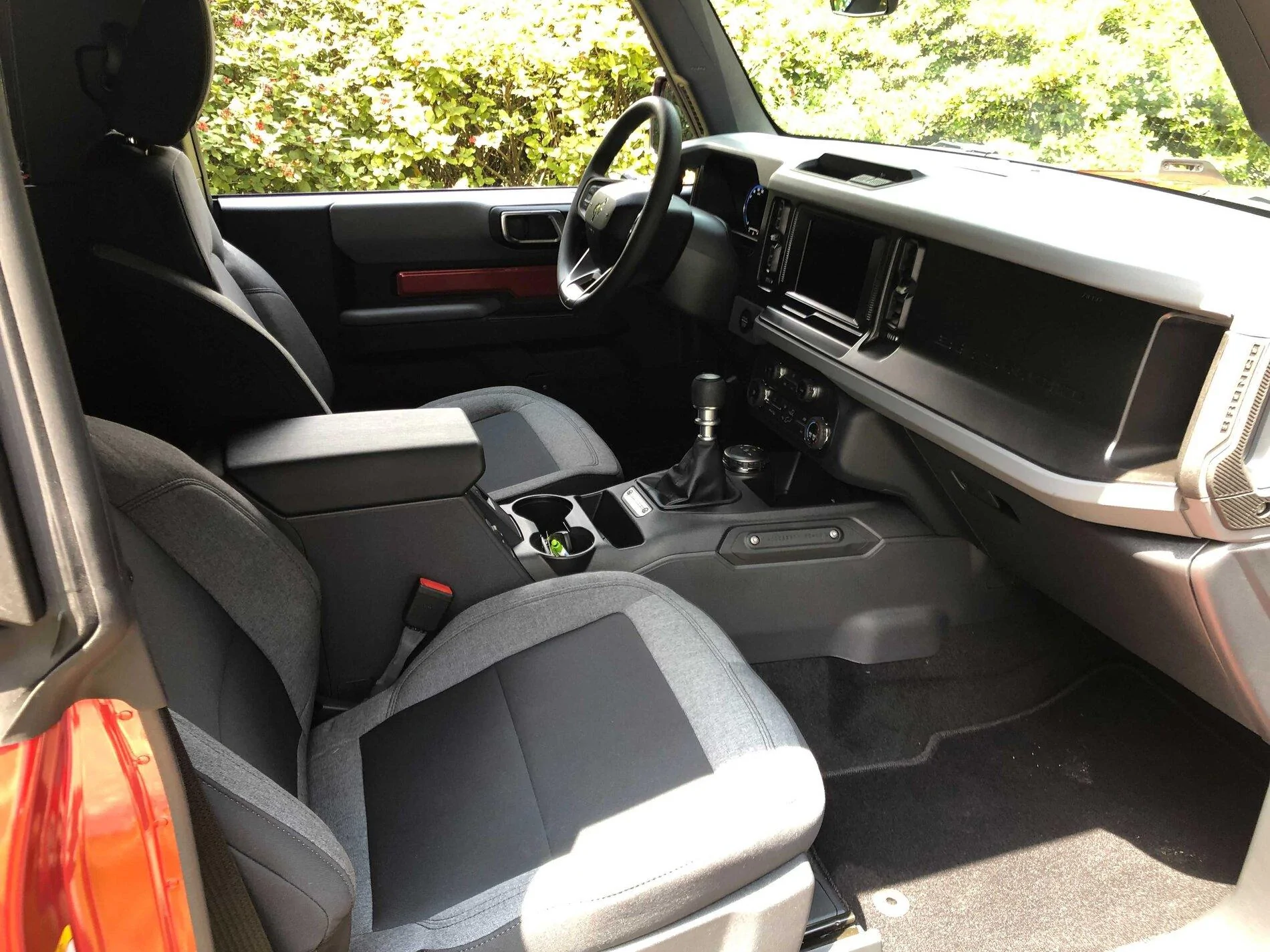

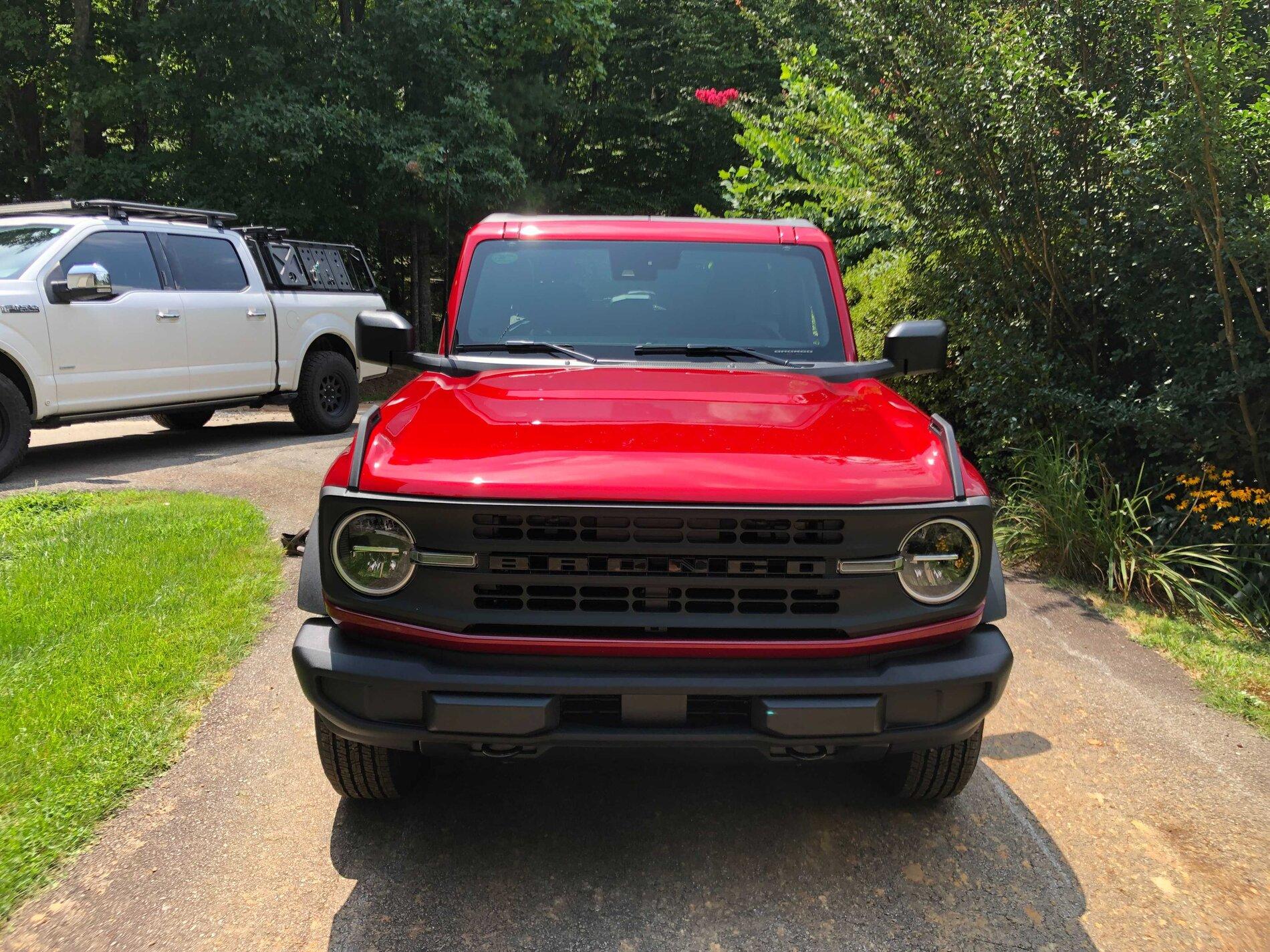

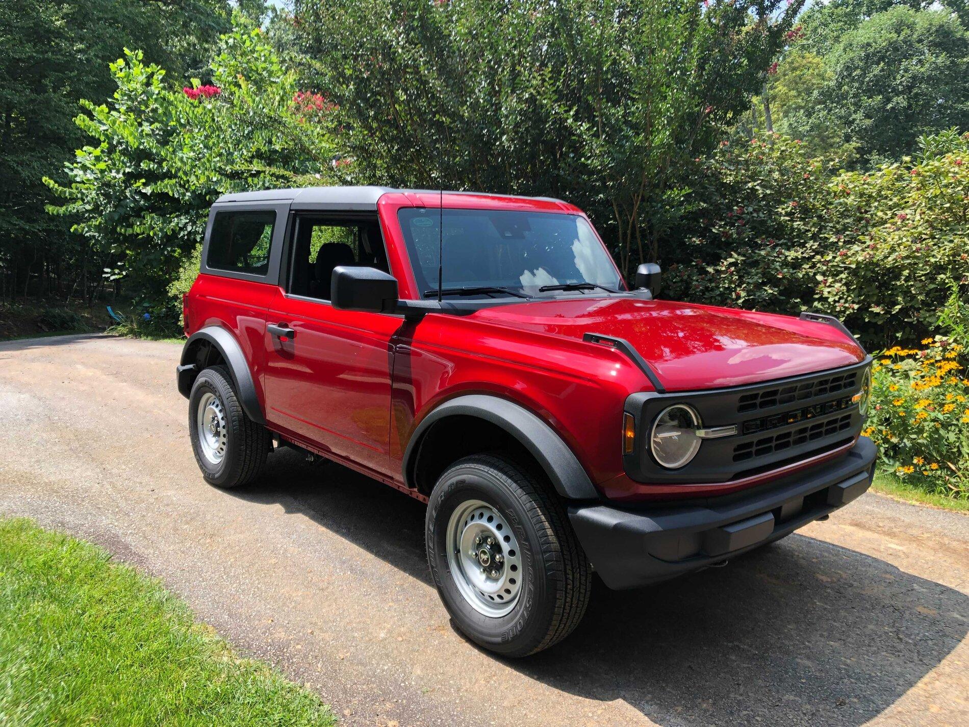

Here are some quick before (as delivered):
Ford Bronco 🦄 Modified my unicorn Base Bronco 2-Door: BFG A/T KO2, Upgraded Speakers, Rear Seat Delete, Sasquatch Flares, Stripes & CB Radio Image from iOS (1)
Ford Bronco 🦄 Modified my unicorn Base Bronco 2-Door: BFG A/T KO2, Upgraded Speakers, Rear Seat Delete, Sasquatch Flares, Stripes & CB Radio Image from iOS (2)

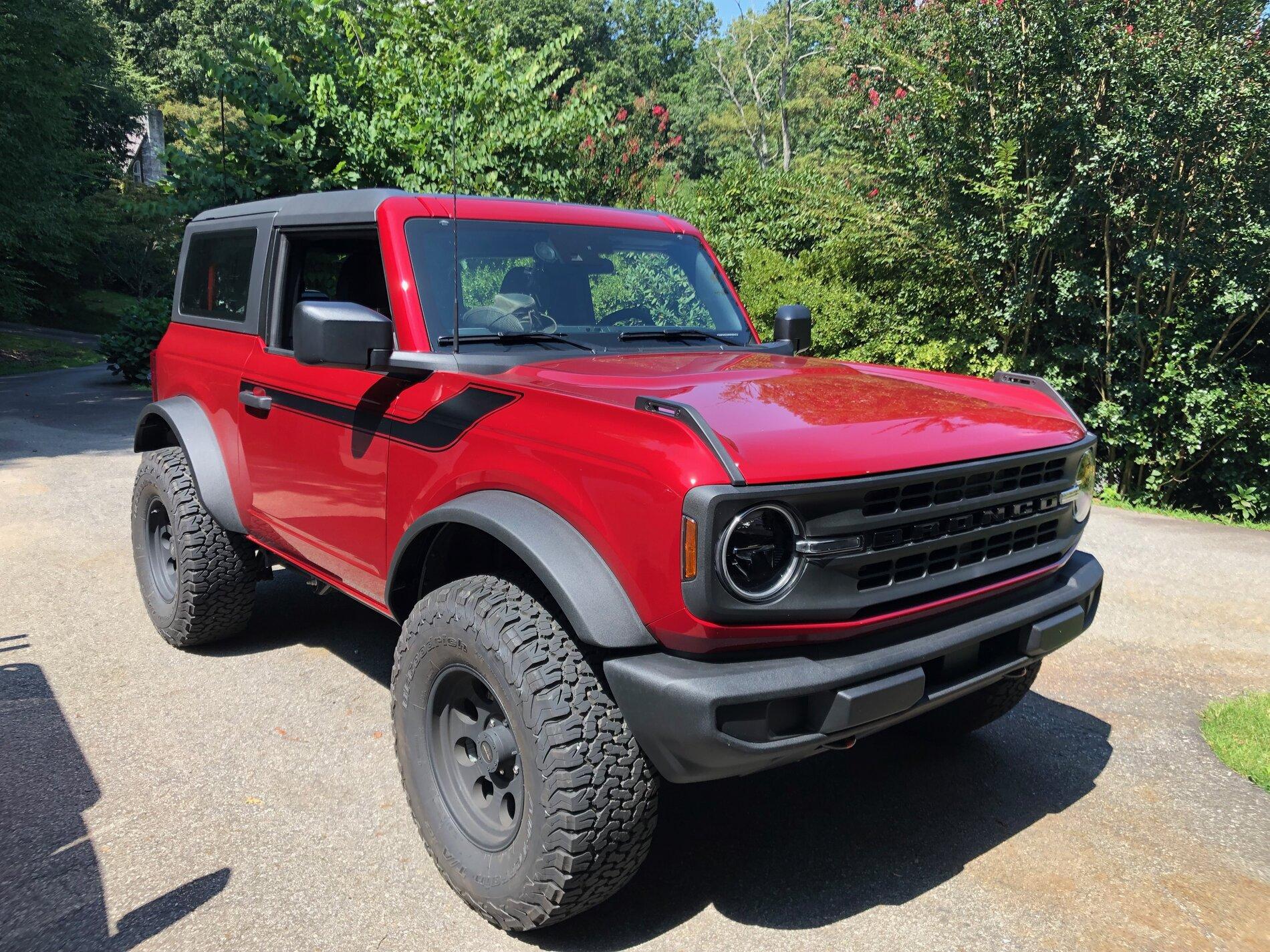

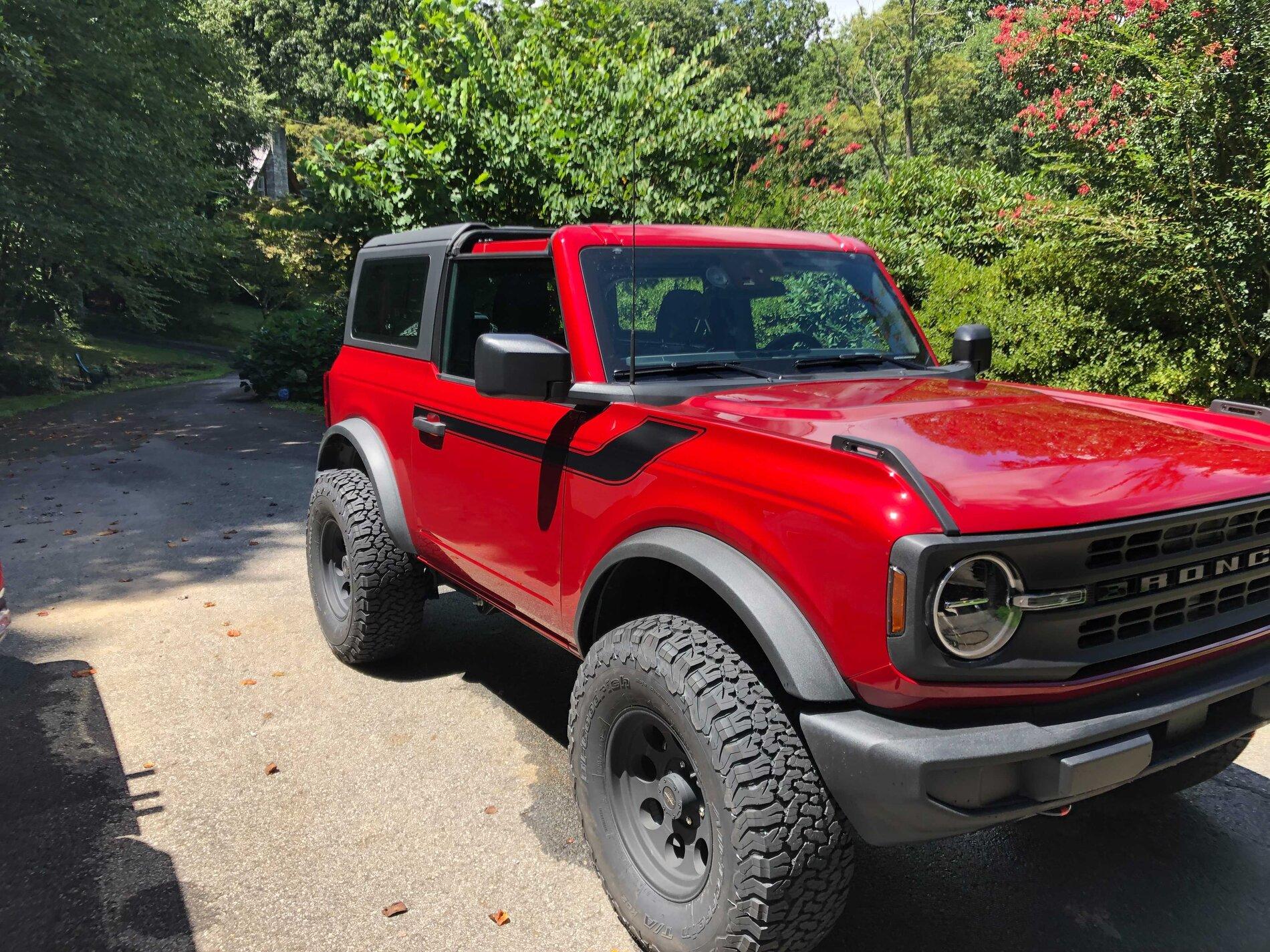

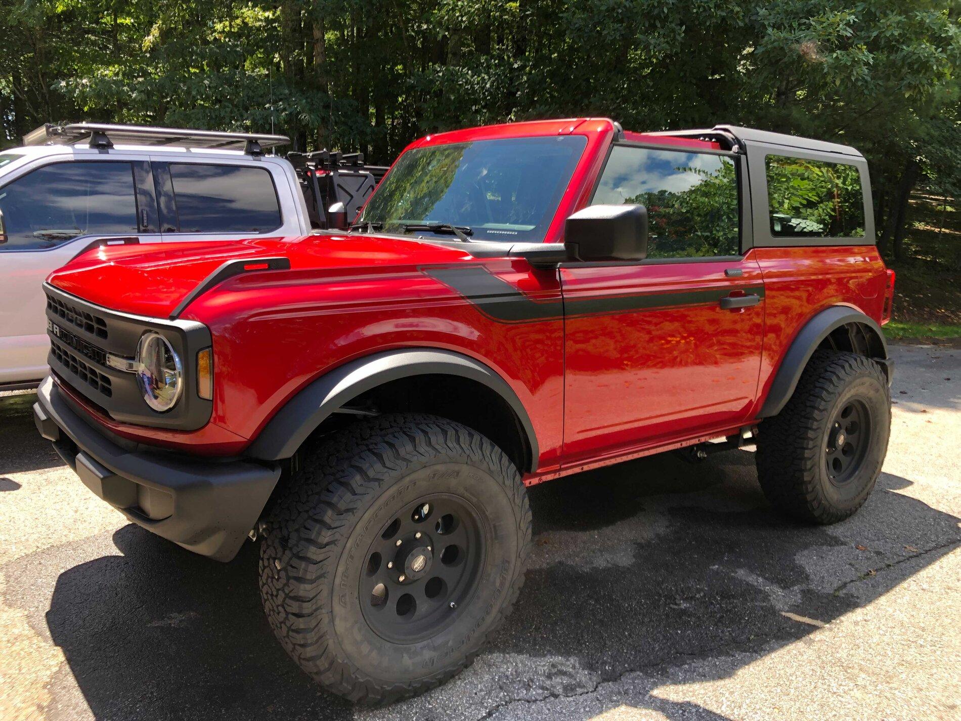

and then after (as of today):
Ford Bronco 🦄 Modified my unicorn Base Bronco 2-Door: BFG A/T KO2, Upgraded Speakers, Rear Seat Delete, Sasquatch Flares, Stripes & CB Radio IMG_4532
Ford Bronco 🦄 Modified my unicorn Base Bronco 2-Door: BFG A/T KO2, Upgraded Speakers, Rear Seat Delete, Sasquatch Flares, Stripes & CB Radio IMG_4545
Ford Bronco 🦄 Modified my unicorn Base Bronco 2-Door: BFG A/T KO2, Upgraded Speakers, Rear Seat Delete, Sasquatch Flares, Stripes & CB Radio IMG_4539

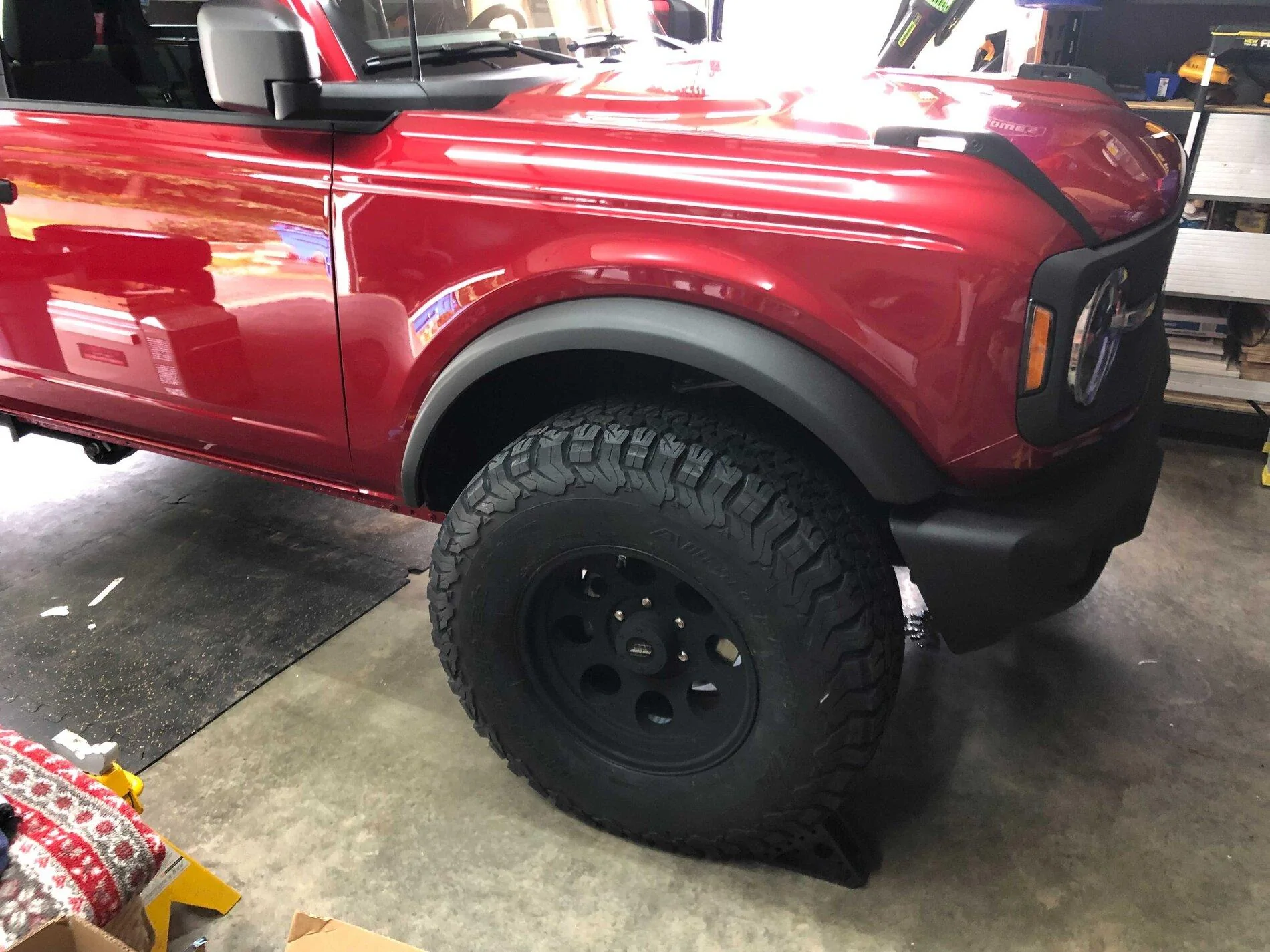

The new wheels and tires were the first thing that I did. The wheels are 17" ProComp with a -6 offset, and a classic design (~700$ total for 5x wheels). UPS dropped them off about a week prior to delivery of the Bronco. The tires are BFG All Terrain KO2 in 35x12.5, were ordered through Discount Tire for about $325/tire, and they also mounted and balanced them on the wheels. I also elected to buy new TPMS sensors for about $60/each, since I want to powder coat the old wheels white and add 33" tires (later).
I did the actual tire installation myself. Removing the front crasher was by far the most annoying part, since my Bronco has the base plastic bumpers (not really bumpers at all, more like bug catchers). Unlike the modular factory bumper, I had to complete remove the plastic "skid plate" in order to unbolt the outer part of the plastic bumper, so I could bend it back enough to slide out the front crash bars. The rear crash bars were nicely removed without any similar drama.

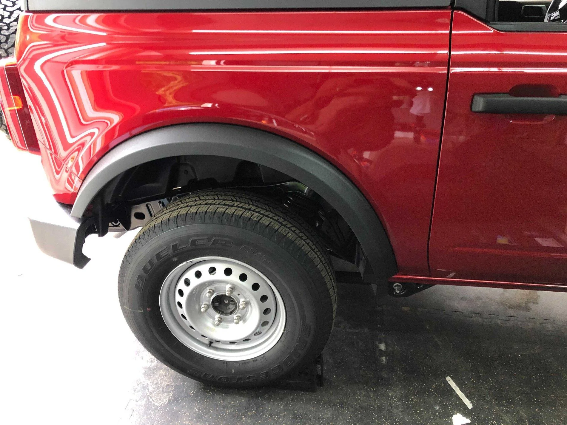

Here is a photo of the front with the new wheels/tires, and the rear with the old ones:
Ford Bronco 🦄 Modified my unicorn Base Bronco 2-Door: BFG A/T KO2, Upgraded Speakers, Rear Seat Delete, Sasquatch Flares, Stripes & CB Radio Image from iOS (3)
Ford Bronco 🦄 Modified my unicorn Base Bronco 2-Door: BFG A/T KO2, Upgraded Speakers, Rear Seat Delete, Sasquatch Flares, Stripes & CB Radio Image from iOS (4)
The larger tires actually fit just fine, without any lift required (at the time). Clearance wasn't great in any direction, but it did fit.
There was a LOT of tire poke with the -6 wheel offset and the standard fender flares:
Ford Bronco 🦄 Modified my unicorn Base Bronco 2-Door: BFG A/T KO2, Upgraded Speakers, Rear Seat Delete, Sasquatch Flares, Stripes & CB Radio Image from iOS (5)
I didn't have a problem with this at first, because it fits the aggressive off-road look of the Bronco. However, the large uncovered area does throw a fair bit of dirt and mud. Even worse, in the rain the tires were throwing water spray not just backwards but straight UP into the side windows and mirrors. After a day of driving in the rain and looking like an idiot with water flying everywhere, I immediately ordered the Sasquatch fenders. Problem solved.

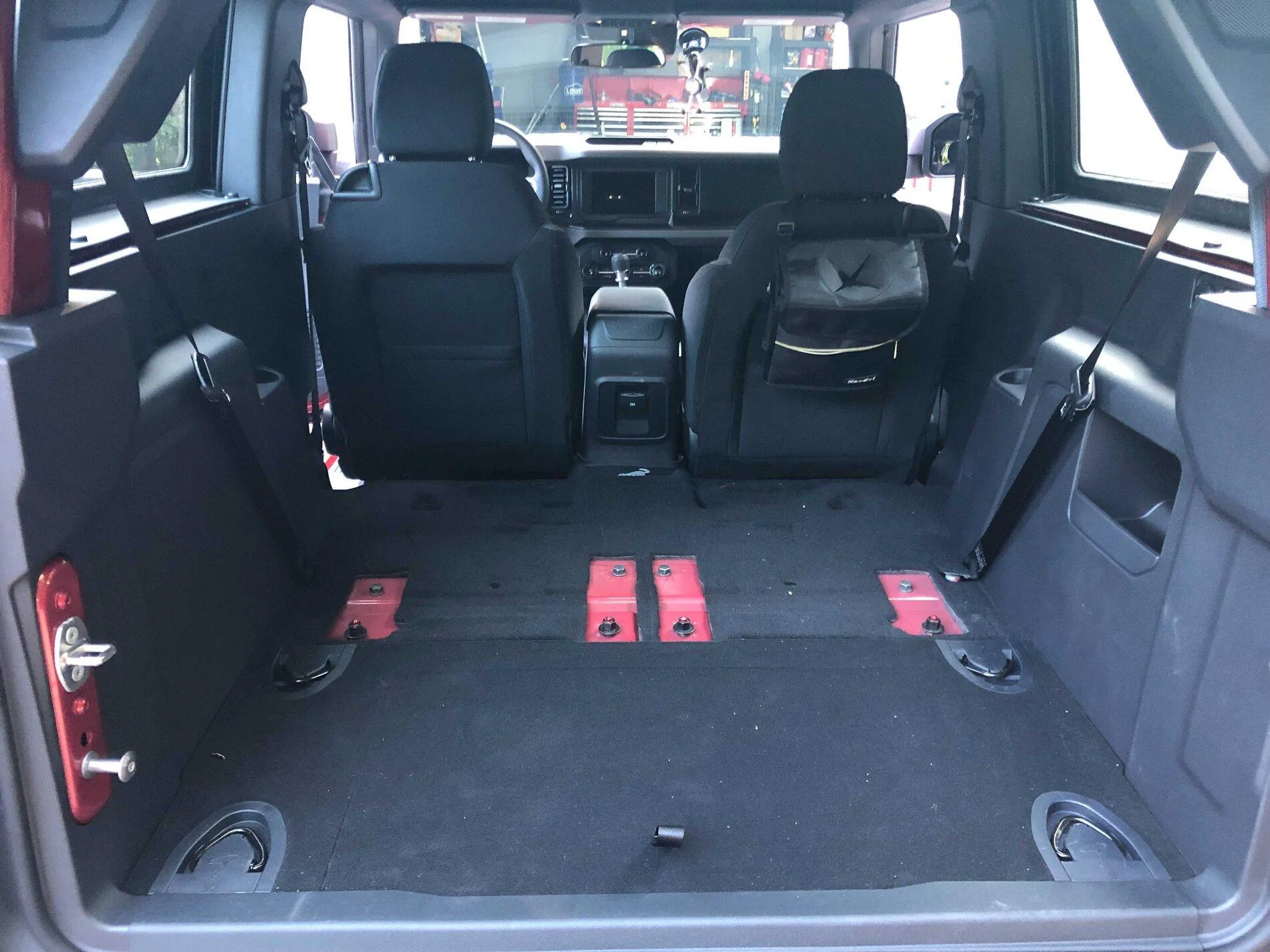

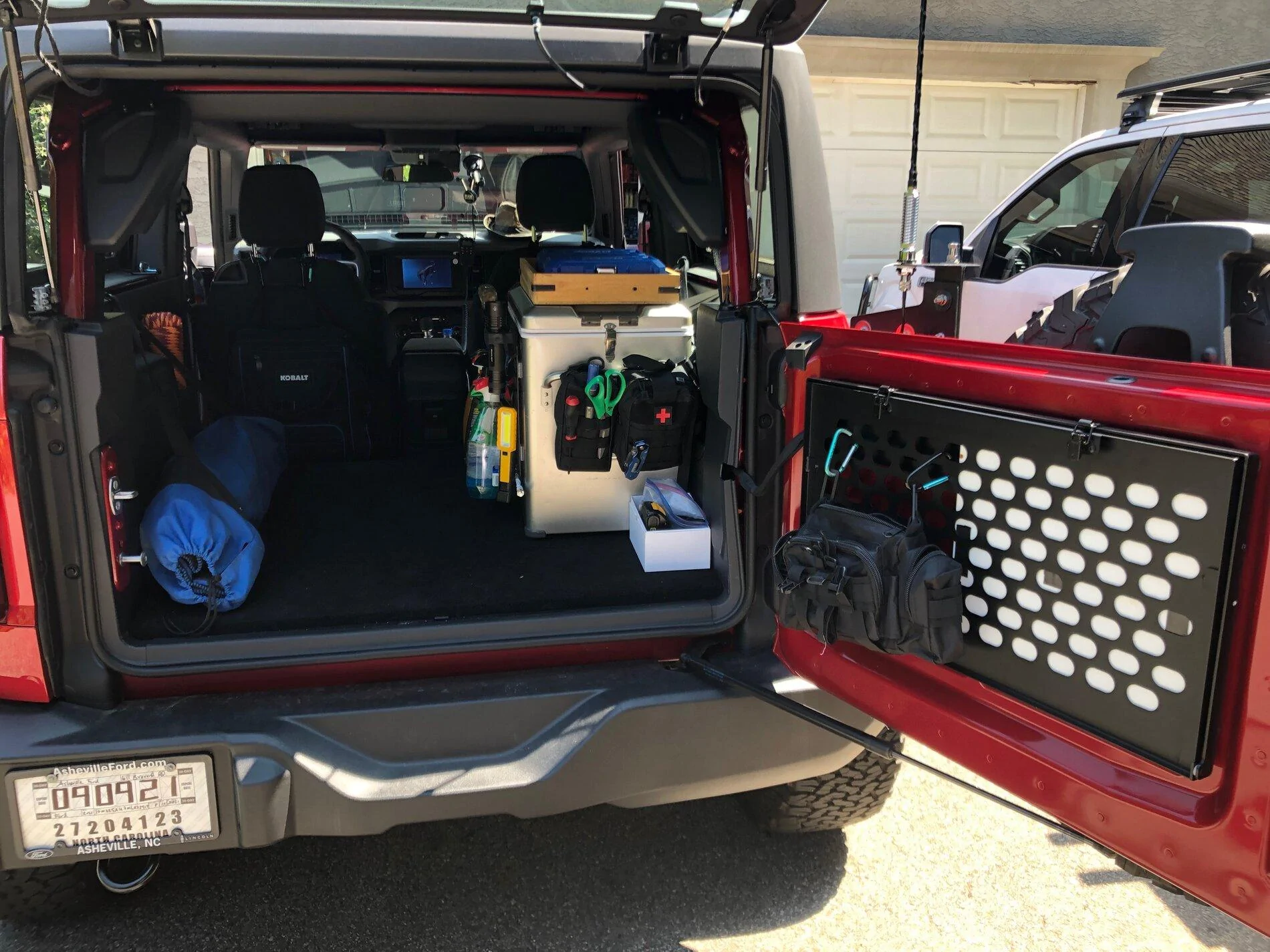

The next modification was to strip out the rear seats:
Ford Bronco 🦄 Modified my unicorn Base Bronco 2-Door: BFG A/T KO2, Upgraded Speakers, Rear Seat Delete, Sasquatch Flares, Stripes & CB Radio Image from iOS (6)

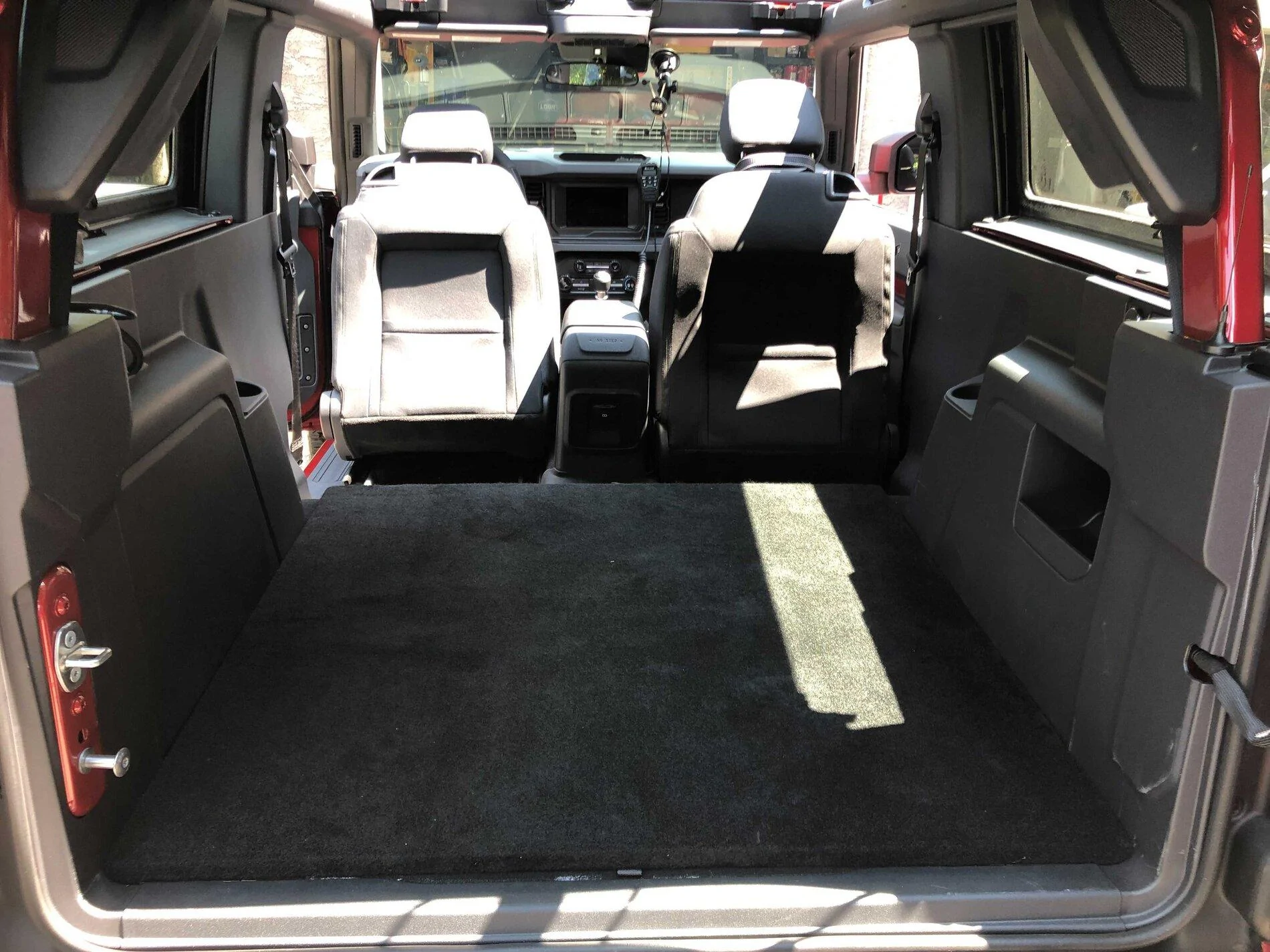

With those gone, the 2 door Bronco has a surprising amount of cargo space. Given that the rear seats in the 2 door are basically unusable anyways, it's really a no-brainer for me. The seat removal left some unsightly bolts and holes in the carpet, which I covered up with a moving blanket for a few days before making a false floor out of plywood and carpet:
Ford Bronco 🦄 Modified my unicorn Base Bronco 2-Door: BFG A/T KO2, Upgraded Speakers, Rear Seat Delete, Sasquatch Flares, Stripes & CB Radio Image from iOS (7)
This one was pretty easy: take a 3/4" sheet of plywood, cut it to 40"x42.5", drill some 1/2" holes to fit around the 4x seat bolts that stick up, and then glue down some auto carpet to give it that factory fresh look.

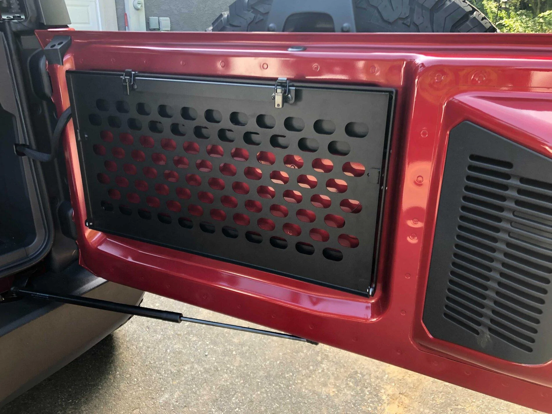

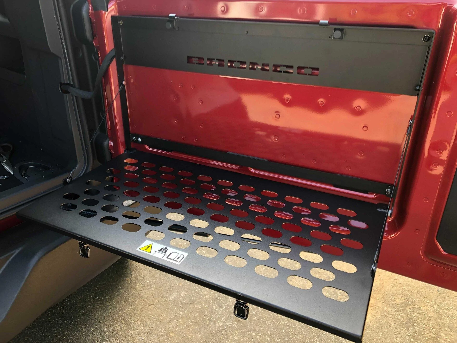

After the false floor, I installed the tailgate door. Not much to talk about there. It's a factory accessory. Installation instructions are crap, though. I hope you like trying to decipher pictures. Here is what it looks like freshly installed:
Ford Bronco 🦄 Modified my unicorn Base Bronco 2-Door: BFG A/T KO2, Upgraded Speakers, Rear Seat Delete, Sasquatch Flares, Stripes & CB Radio Image from iOS (8)
Ford Bronco 🦄 Modified my unicorn Base Bronco 2-Door: BFG A/T KO2, Upgraded Speakers, Rear Seat Delete, Sasquatch Flares, Stripes & CB Radio Image from iOS (9)

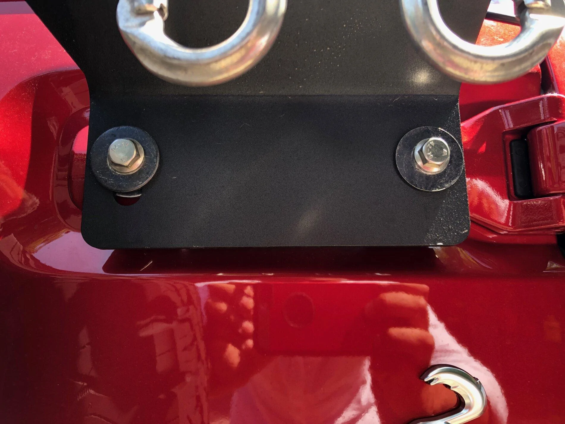

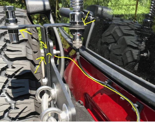

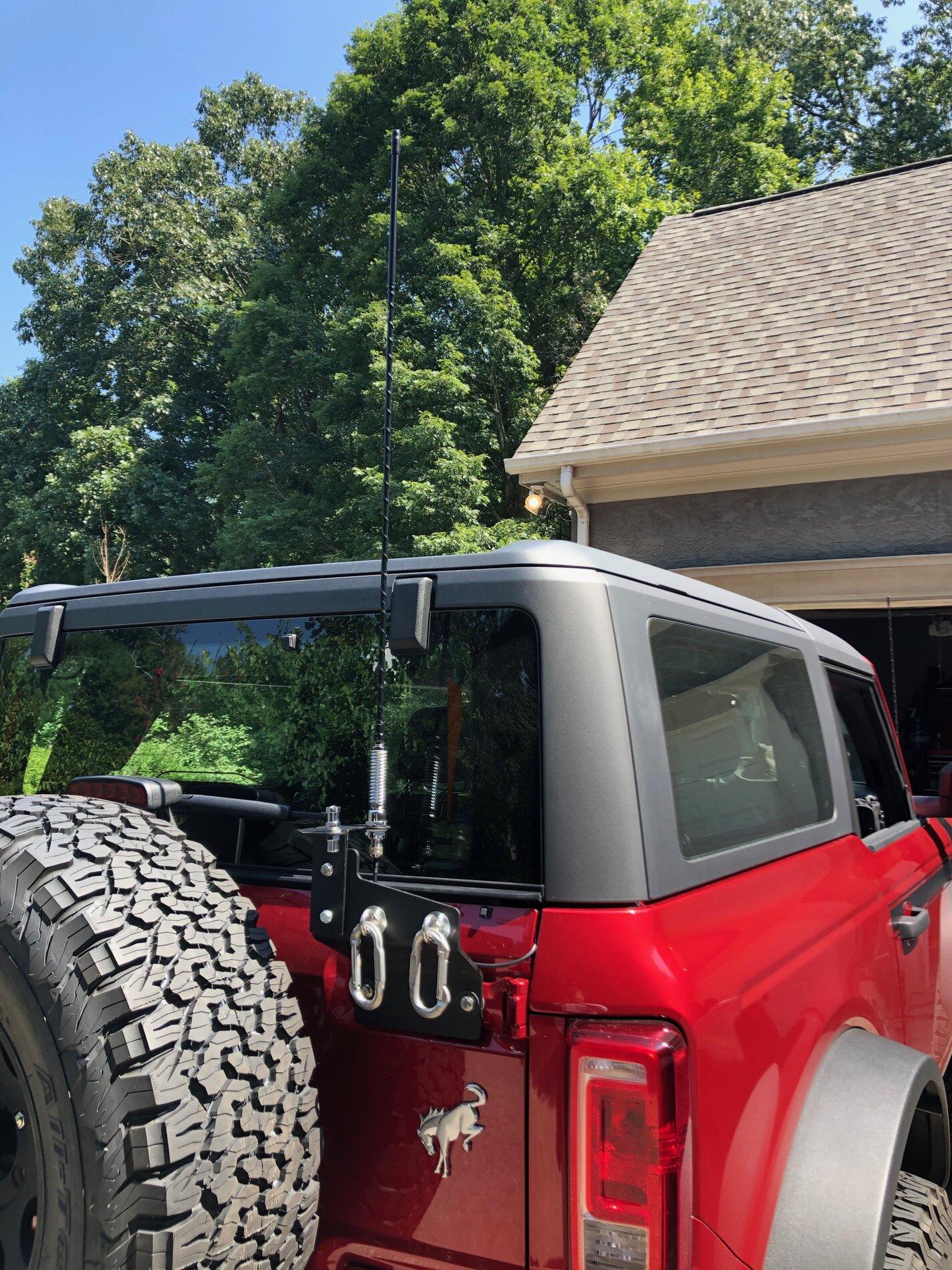

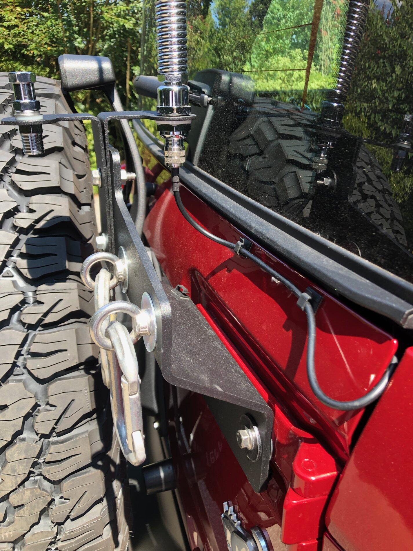

The next modification was a multi-purpose antenna mount for the rear tailgate. I happened to have some leftover pieces of powdercoated steel from something else, and the existing bolt holes in one piece lined up perfectly with the two bolt holes for the top tailgate hinge. The factory bolts here are M8 (by 20mm or something), so I ran to Lowes and grabbed a few different stainless steel M8 bolts with some plastic washers for compression.
For safety, I removed the spare tire first to minimize the weight, then unbolted the top hinge, put everything together, and torqued it down to about 35 lb/ft. Once the main support bracket was attached to the tailgate hinge, I found some other spare metal bits, cut them to size, drilled some holes to fit more M8 bolts and also the antenna mounts, and bolted that all down. The CB antenna wire was routed around the edge of the tailgate and up into the trim panel. The current GMRS antenna is a tiny one that is stuck to the inside of the Bronco, but eventually I will replace it with a long-range antenna on the second external mount.
Here is the final install:
Ford Bronco 🦄 Modified my unicorn Base Bronco 2-Door: BFG A/T KO2, Upgraded Speakers, Rear Seat Delete, Sasquatch Flares, Stripes & CB Radio IMG_4534
Ford Bronco 🦄 Modified my unicorn Base Bronco 2-Door: BFG A/T KO2, Upgraded Speakers, Rear Seat Delete, Sasquatch Flares, Stripes & CB Radio IMG_4548
Ford Bronco 🦄 Modified my unicorn Base Bronco 2-Door: BFG A/T KO2, Upgraded Speakers, Rear Seat Delete, Sasquatch Flares, Stripes & CB Radio IMG_4549
Ford Bronco 🦄 Modified my unicorn Base Bronco 2-Door: BFG A/T KO2, Upgraded Speakers, Rear Seat Delete, Sasquatch Flares, Stripes & CB Radio IMG_4550

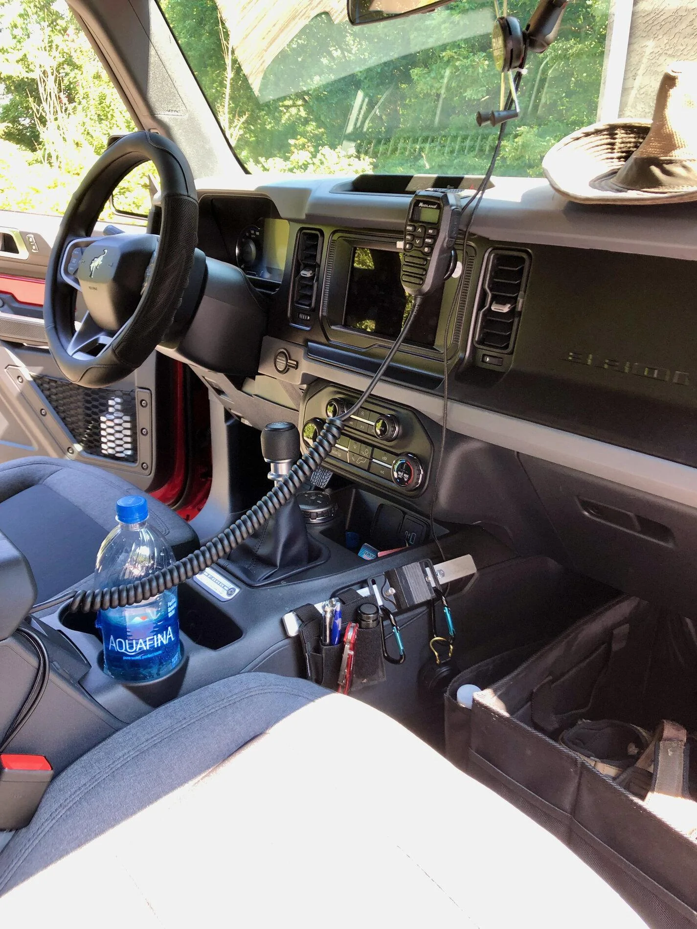

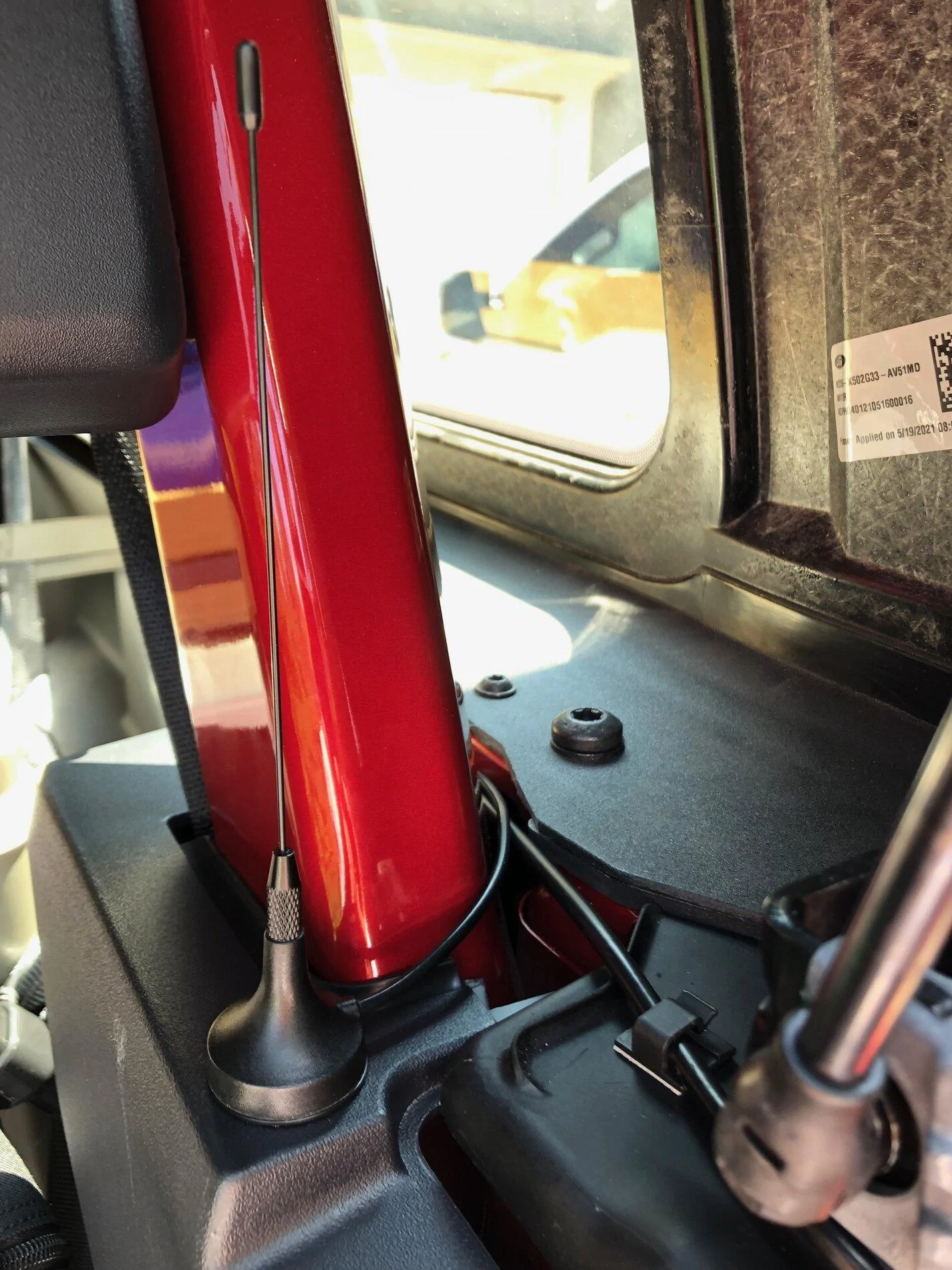

The antenna wire was routed around the right side of the vehicle behind the trim, down the door trim, under the floor mat behind the passenger seat, and up inside the console rear trim panel. I pulled off the rear console trim, drilled a 3/4" hole through to the inside of the console, and ran the cable through there to the GMRS radio mounted inside. (No pictures of this at the moment).

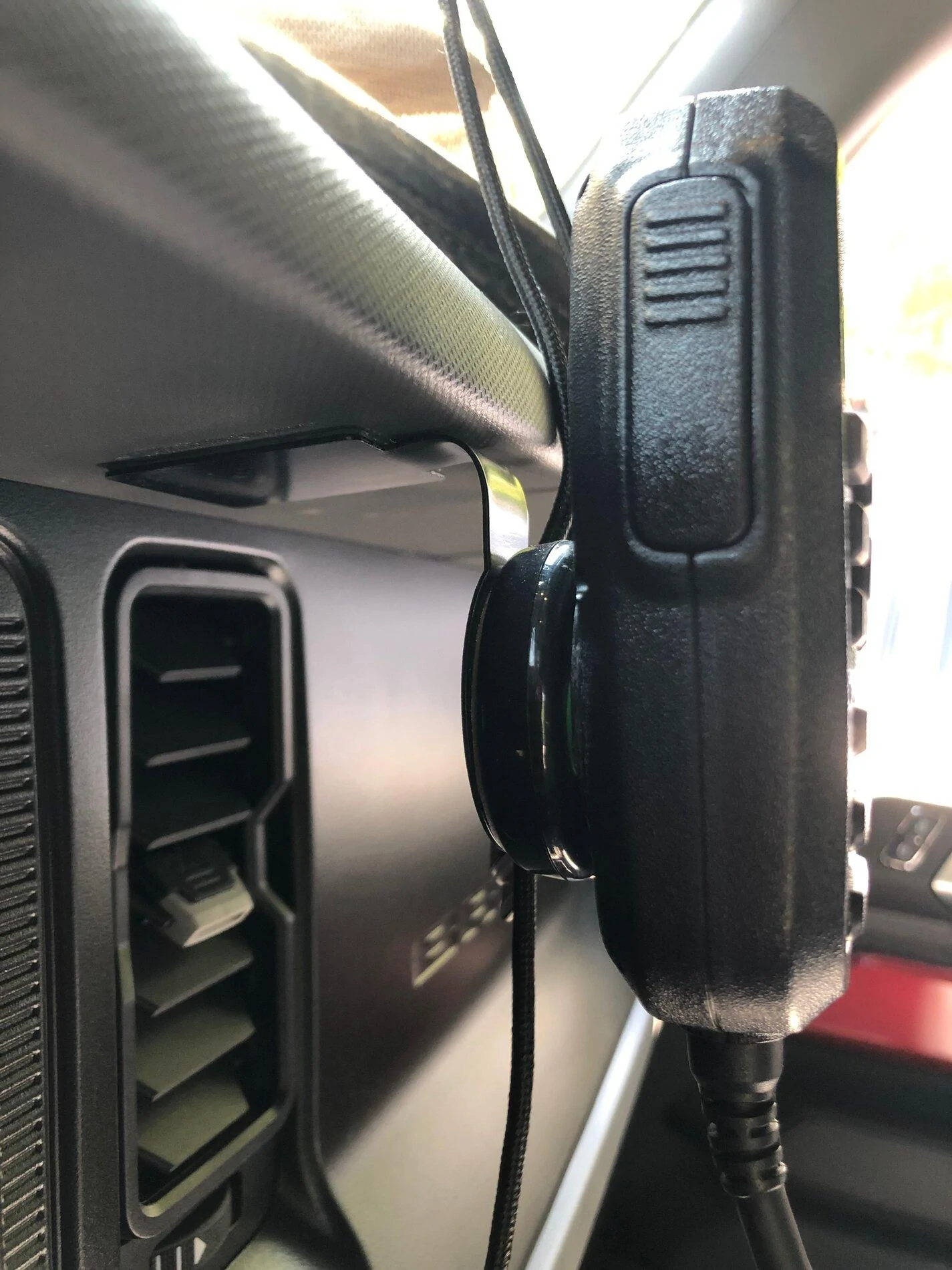

The Midlands GMRS radio I'm using (a very popular option on Amazon) has all the controls on the handset itself, so I removed the regular handset "button" and replaced it with a metal disk. Underneath the Bronco dash, I superglued a magnetic phone mount so it extends out and down:
Ford Bronco 🦄 Modified my unicorn Base Bronco 2-Door: BFG A/T KO2, Upgraded Speakers, Rear Seat Delete, Sasquatch Flares, Stripes & CB Radio IMG_4561

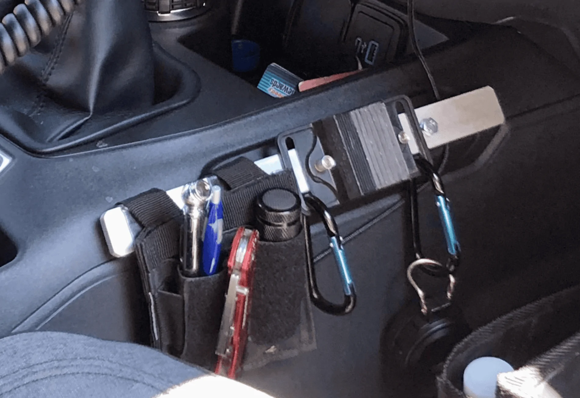

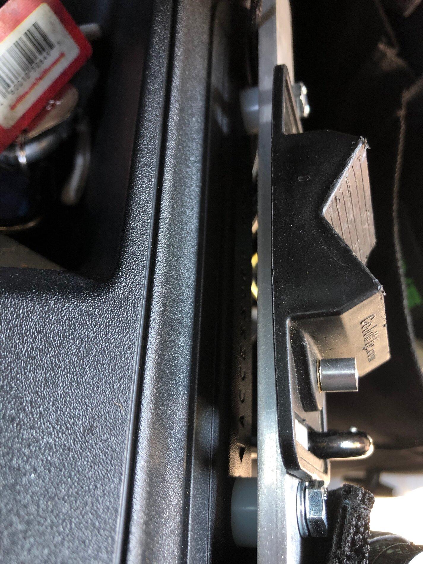

The Bronco (Base) doesn't come with a handle in the middle, so the next change I did was to remove the "Accessory Port" bolts, run to Lowes to get longer ones (I think these were M6 and I needed something like 45mm, along with some plastic spacers), cut and sand about 12" of aluminum bar and then mount the thing into the accessory port bolt holes. That gave me a frame for adding more useful things, in this case a magnetic pistol mount and some magazine pouches that double as pen and flashlight holders.
Ford Bronco 🦄 Modified my unicorn Base Bronco 2-Door: BFG A/T KO2, Upgraded Speakers, Rear Seat Delete, Sasquatch Flares, Stripes & CB Radio Screen Shot 2021-08-25 at 3.24.39 PM
Here is the rail from the top looking down, showing the bolts going to spacers going into the factory bolt holes:
Ford Bronco 🦄 Modified my unicorn Base Bronco 2-Door: BFG A/T KO2, Upgraded Speakers, Rear Seat Delete, Sasquatch Flares, Stripes & CB Radio IMG_4551

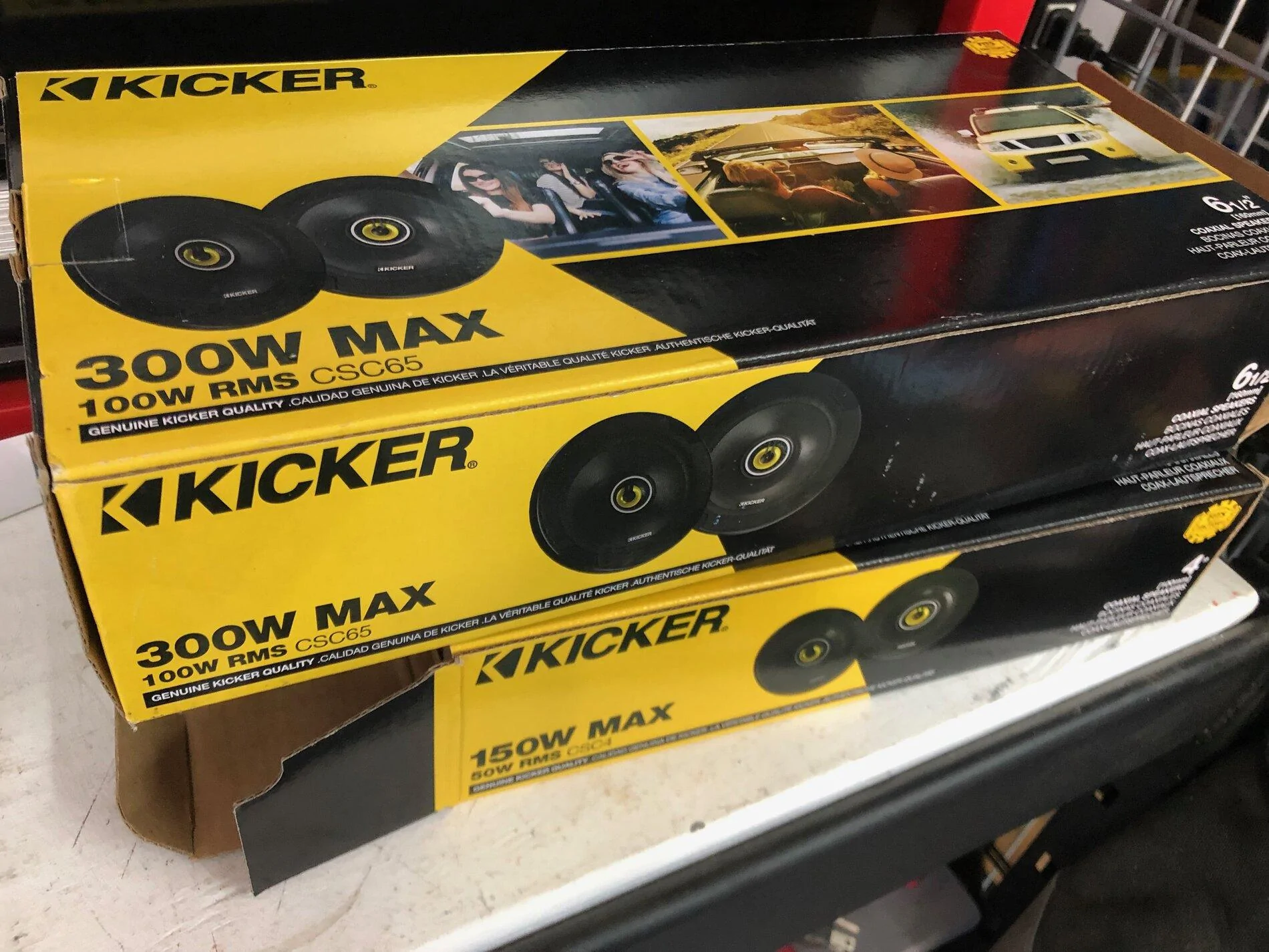

Next, I replaced all the factory speakers, because the factory sound system on the Base model is just terrible. I started out buying some cheap Pioneer speakers at Best Buy. The 4" speakers installed without any drama at all. The 6.5" inch speakers were a pain. I had to remove all the door trim (made worse by the fact that you have to remove trim within trim on the driver's side to get to some extra bolts in the footwell), only to find that the factory 6.5" speakers don't use a standard 4 hole mount pattern. So I went online and ordered a plastic adapter and put the factory speakers back while I waited.
The sound with the new 4" speakers was terrible. The inputs for the front dash 4" speakers come from the lower 6.5" speakers, and the factory speakers must have internal bass blockers. The resonance was awful. After rereading the speaker forum thread here, I immediately ordered some bass blockers from Crutchfield. I also gave up on my Pioneer speakers and ordered a full set of Kicker 4" and 6.5" speakers (since I've been happy with that same upgrade in my F150).
Everything arrived, was installed, and I'm much happier. The clarity of the sound with a full Kicker system is SO much better than the factory. However, there is limited bass, so this system absolutely will need an additional subwoofer. Personally, I'm planning on building a custom subwoofer box later on, but for now this upgrade is perfectly acceptable. Here are my speaker selections:

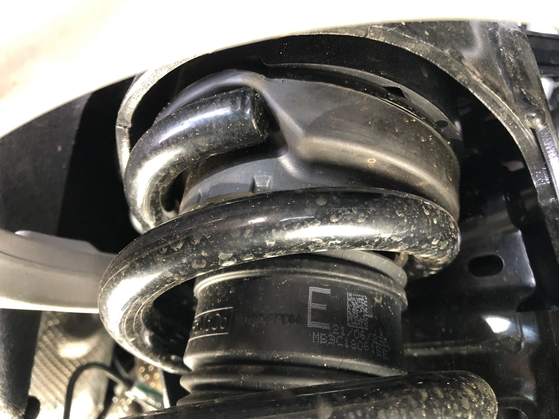

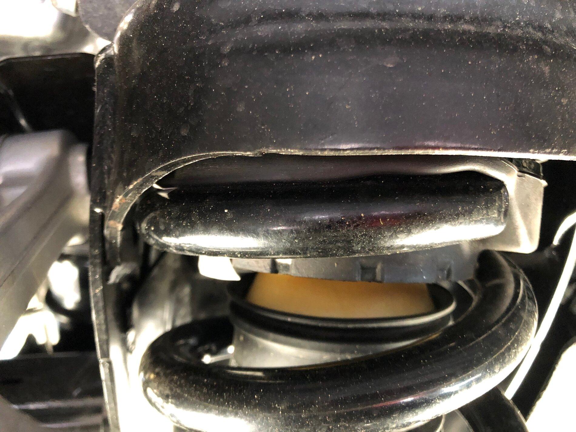

Moving back to the outside... my installation appointment date for the ZoneOffroad spacers arrived. The spacers themselves cost $100, and the installation was about $250 plus an alignment fee of about $100. I wasn't happy with the initial result. The front camber was all wrong, and the Bronco felt very unstable and wandered around the road. I took it to a 2nd alignment at an actual Ford dealership, where I found out that the Bronco is so new the alignment specs don't even exist in the dealership's alignment software system. They ended up using the specs from a Ford Escape (something to do with the wheelbases being pretty close) and in the end the alignment turned out well.
Just a heads up if you are lifting the truck: make sure to talk to the alignment shop because they may have to "best guess" it.
Here are some closeup photos of the ZoneOffroad spacers on the front suspension:
Ford Bronco 🦄 Modified my unicorn Base Bronco 2-Door: BFG A/T KO2, Upgraded Speakers, Rear Seat Delete, Sasquatch Flares, Stripes & CB Radio IMG_4552
Ford Bronco 🦄 Modified my unicorn Base Bronco 2-Door: BFG A/T KO2, Upgraded Speakers, Rear Seat Delete, Sasquatch Flares, Stripes & CB Radio IMG_4553

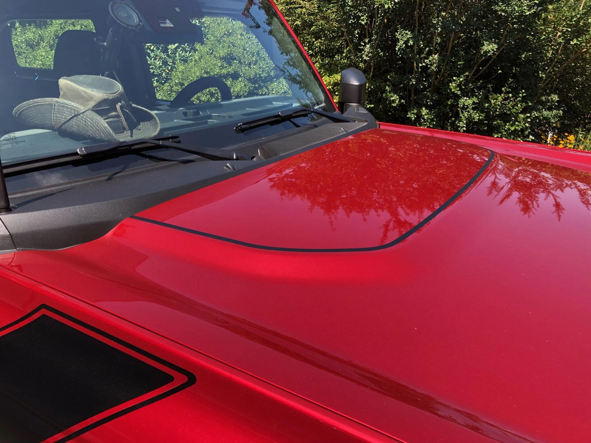

The next update was the stickers: I ordered the Ridergrafix side stripes and the hood wrap. I tried installing the hood wrap first and was very frustrated. With the new lift and the larger tires, it is actually really tricky reaching the top middle of the hood (even with a ladder) without feeling very off balance or wanting to put pressure on the middle of the hood for support (and denting it).
Also, it didn't help that I tried to do a dry wrap installation (like I've done for other wraps in the past) which failed miserably (bubbles everywhere). I finally read the directions and it clearly says "WET APPLICATION" so whoops. I ripped off the center wrap but kept the pinstripes on the hood since those turned out pretty well.
Ford Bronco 🦄 Modified my unicorn Base Bronco 2-Door: BFG A/T KO2, Upgraded Speakers, Rear Seat Delete, Sasquatch Flares, Stripes & CB Radio IMG_4559
Side stripes turned out VERY well. I actually read the instructions thoroughly this time, took my time, and it all worked out peachy. I elected to leave off the rear portion of the stripe kit, since I actually like how it looks with the front portion only.

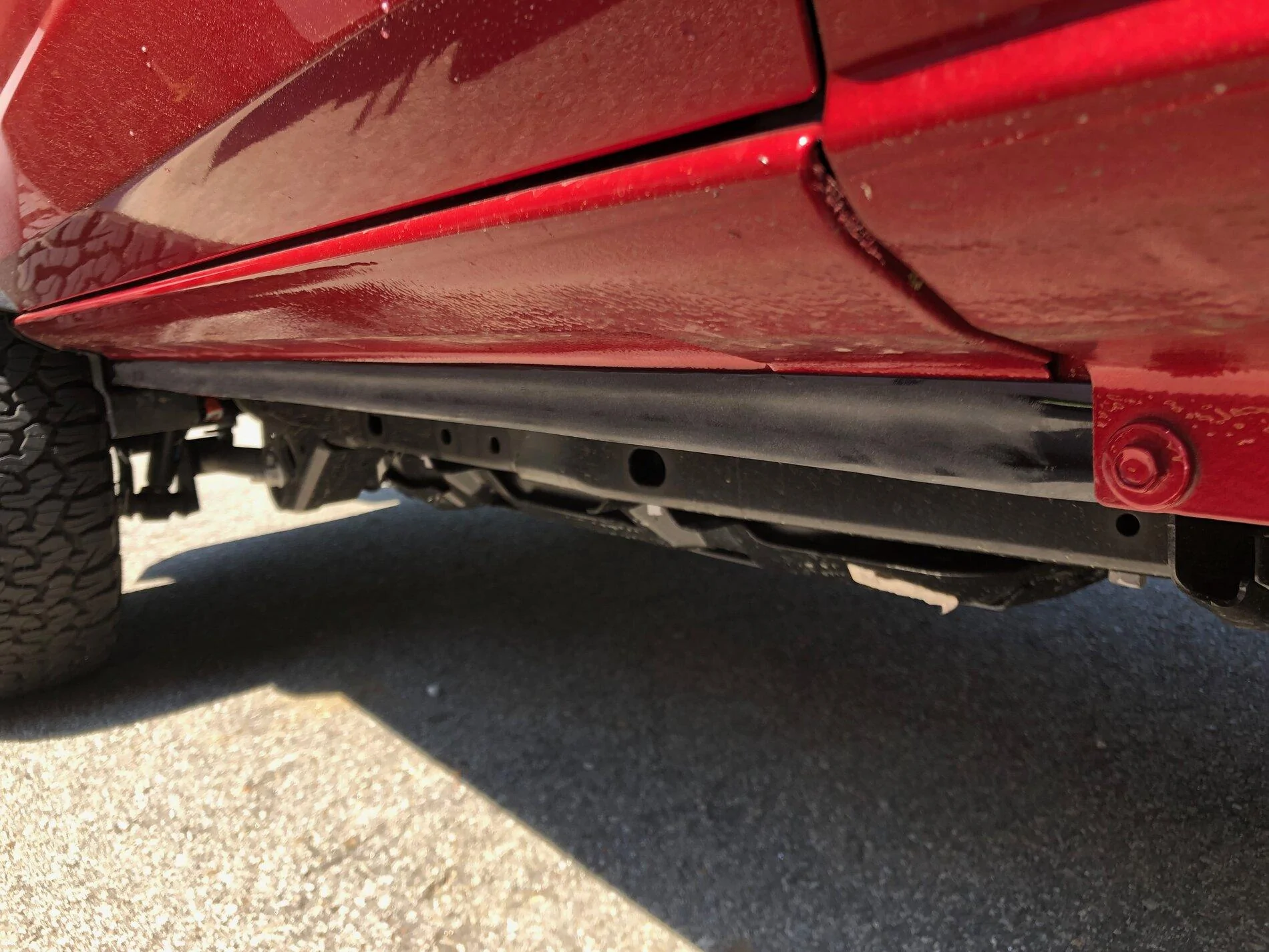

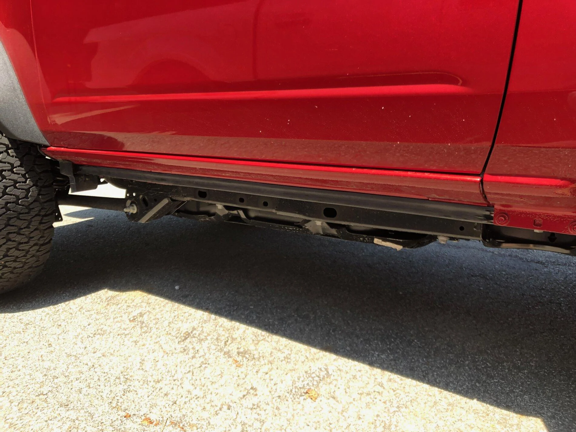

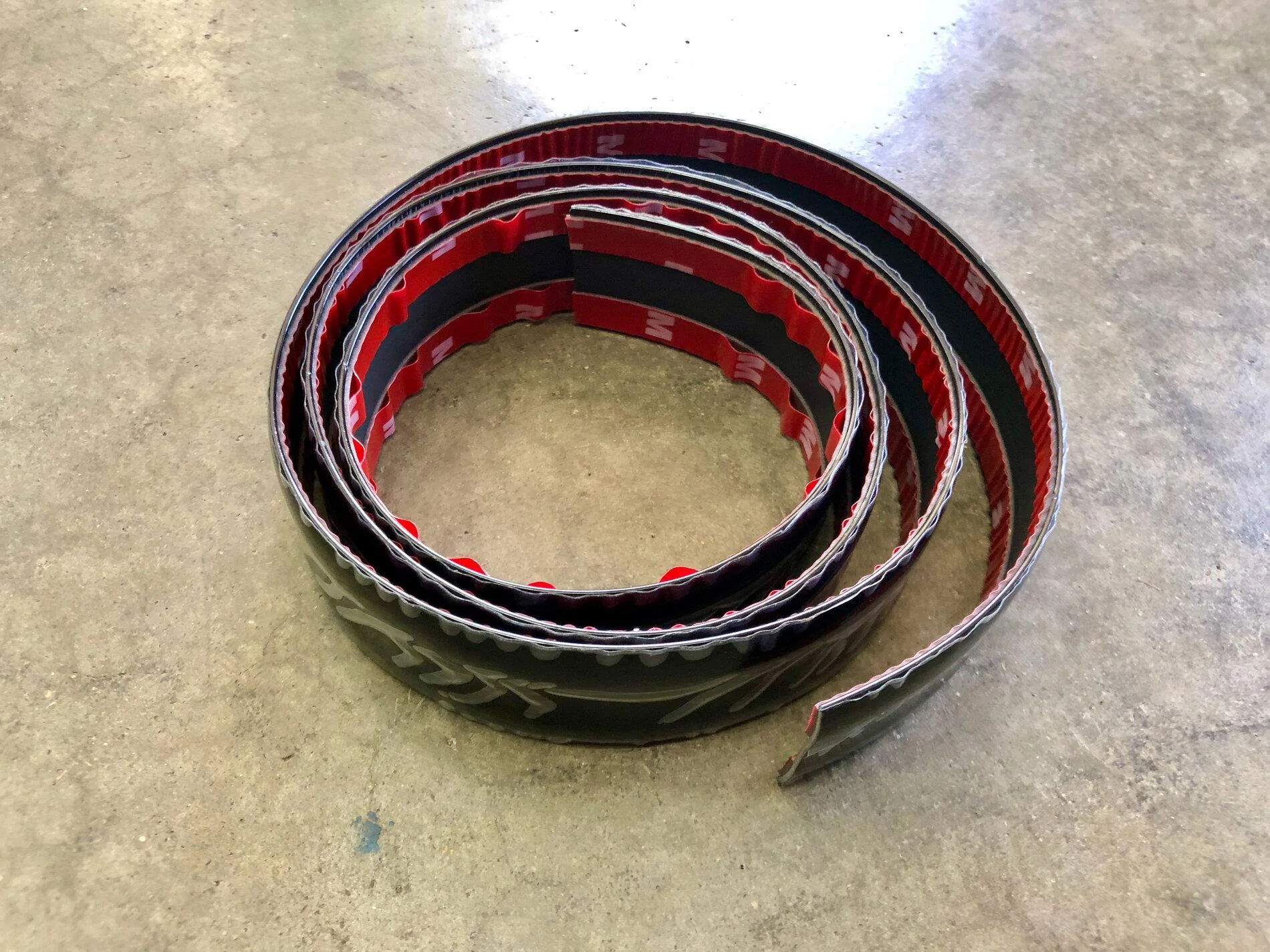

I also hid the ugly pinch seams below the doors (at least until I add steps). I measured the height of the seam, bought a strip of sticky rubberized trim with the same width, and then installed the rubber over the pinch seam. Out of the box, the rubber trim is a bit glossy, so I roughed it up with the sandpaper and now it looks much more factory.
Ford Bronco 🦄 Modified my unicorn Base Bronco 2-Door: BFG A/T KO2, Upgraded Speakers, Rear Seat Delete, Sasquatch Flares, Stripes & CB Radio IMG_4554
Ford Bronco 🦄 Modified my unicorn Base Bronco 2-Door: BFG A/T KO2, Upgraded Speakers, Rear Seat Delete, Sasquatch Flares, Stripes & CB Radio IMG_4555
Ford Bronco 🦄 Modified my unicorn Base Bronco 2-Door: BFG A/T KO2, Upgraded Speakers, Rear Seat Delete, Sasquatch Flares, Stripes & CB Radio IMG_4556

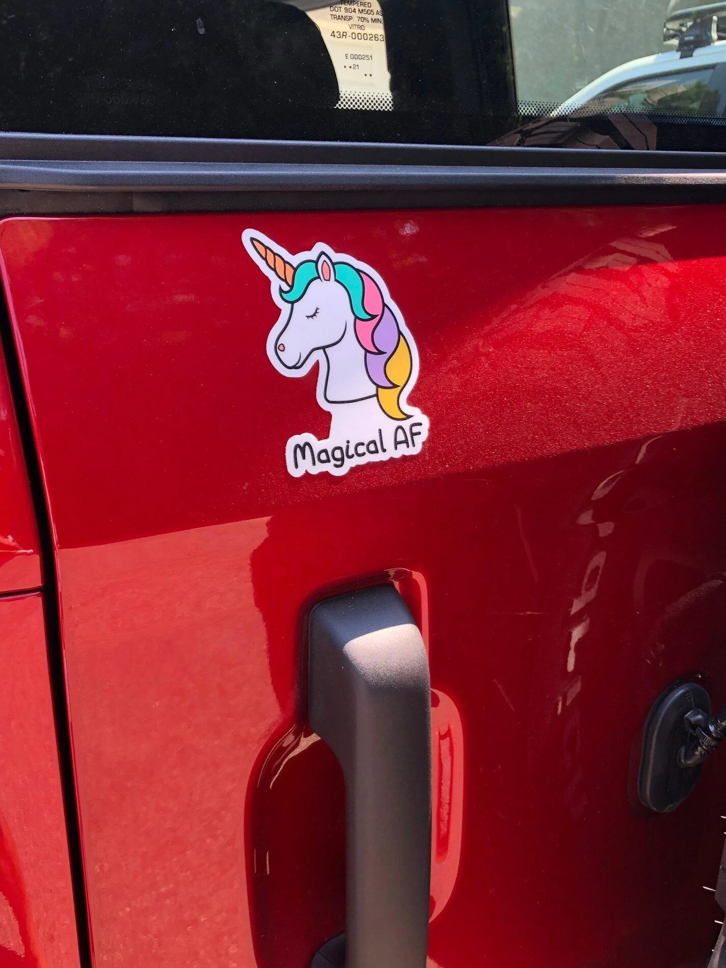

Finally, since this truck really is a unicorn (MY2021, Base, MIC, 2dr, Manual, Rapid Red, and it narrowly escaped being stuck on Dirt Mountain...), I added an appropriate sticker :)
Ford Bronco 🦄 Modified my unicorn Base Bronco 2-Door: BFG A/T KO2, Upgraded Speakers, Rear Seat Delete, Sasquatch Flares, Stripes & CB Radio IMG_4547

Man you've been busy that thing looks great everything you did
I like the stripes kind of wish it went further towards the back but everything looks great especially the ugly pinch weld thanks for the idea I'm taking it LOL

Love the radio antenna install! If you didn't do any grounding for the antenna just scrape off some paint on the mount where I have arrows and run a ground wire off that one bolt to somewhere like a door/gate hinge. Add some dielectric grease where paint has been scratched off to slow down rust. Also, I'd verify the proper placement of the plastic white ring on the antenna mount. For the CB antenna, in my experience, the white plastic ring usually goes on the top.
Ford Bronco 🦄 Modified my unicorn Base Bronco 2-Door: BFG A/T KO2, Upgraded Speakers, Rear Seat Delete, Sasquatch Flares, Stripes & CB Radio 1629921450041
This guy does a good job talking about grounding the antenna and testing with a multimeter
**EDIT: Found this on another forum about grounding:
" This is an excellent low-resistance DC ground (as measured with a good multimeter), and would be great for grounding auxiliary lights, etc. However, it it almost useless as an effective RF ground. At high frequencies, RF energy flows only on the surface of a conductor (skin effect) so to get a low-impedance ground path you need a use a conductor with lots of surface area (e.g. thin, flat copper mesh strap) and make all connections as short and direct as possible. That would mean one short strap from the antenna mount to the nearest metal on the tailgate, secured with at least two fasteners at each end, and another short strap somewhere near the tailgate hinge from tailgate to body shell. If a solid strap absolutely cannot be used, then a short piece of wide tinned-braided copper strap can be used, with slightly more impedance. If working on a body-on-frame vehicle, the antenna ground should be attached to the body shell, not the frame. The body shell is effectively the antenna's ground plane. "
Ford Bronco 🦄 Modified my unicorn Base Bronco 2-Door: BFG A/T KO2, Upgraded Speakers, Rear Seat Delete, Sasquatch Flares, Stripes & CB Radio 1629981733901
So, perhaps grounding with just a regular wire may help with dissipating static build up from the antenna thus lowering your receivers noise floor but, as an RF ground, it probably isn't doing much.

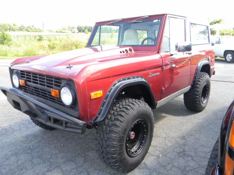

Thanks for reading. Hope you get yours soon.
