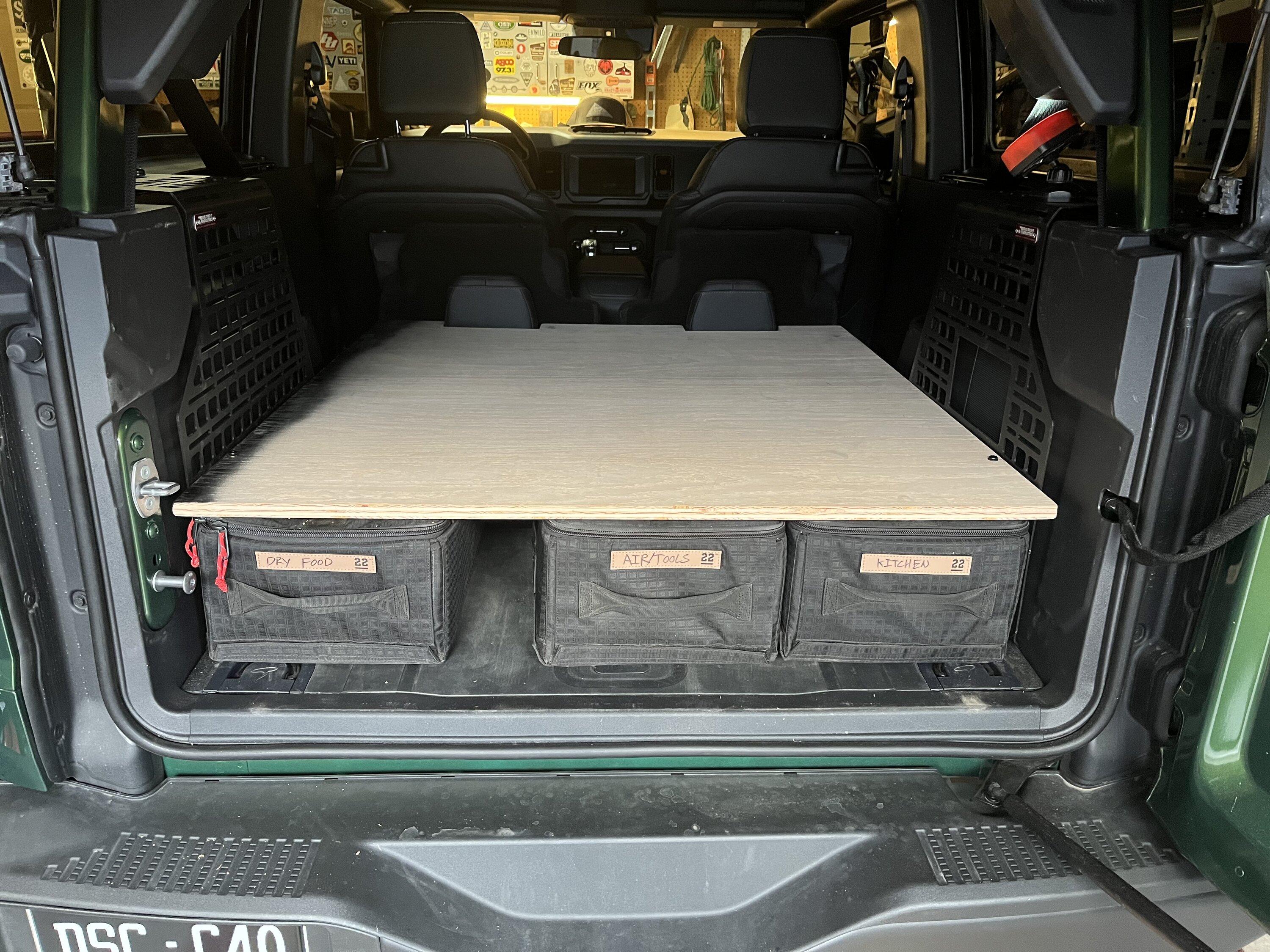

Lots of these starting to pop up, I love seeing all the different solutions!
We still have teenagers in the house so I’m not willing to remove the seats, but as soon as they go to college the rear seats are history.
I’m still in the tinkering phase but this is what I’ve come up with so far. I wanted a simple platform that I could easily install or remove in minutes. Goal being enhanced organization and a carpeted platform for our aging dog.
I’ve got some folding / locking legs in the mail that may do the trick for support and an aluminum L bracket that I can cut up as an option. All will tie into the Builtright Molle panels.
So far I prefer option 2 with the Step22 boxes underneath.

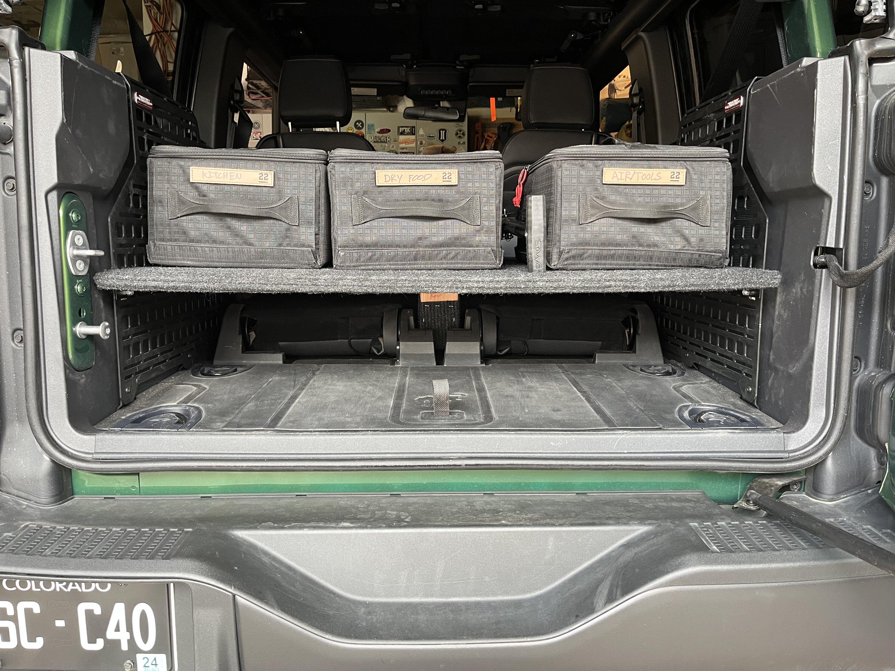

More tinkering this evening.
Folding feet arrived, they were too short. Specs listed them at 8” but we’re about 1/4 inch shy. So for now I’m going with my backup L-bracket plan.

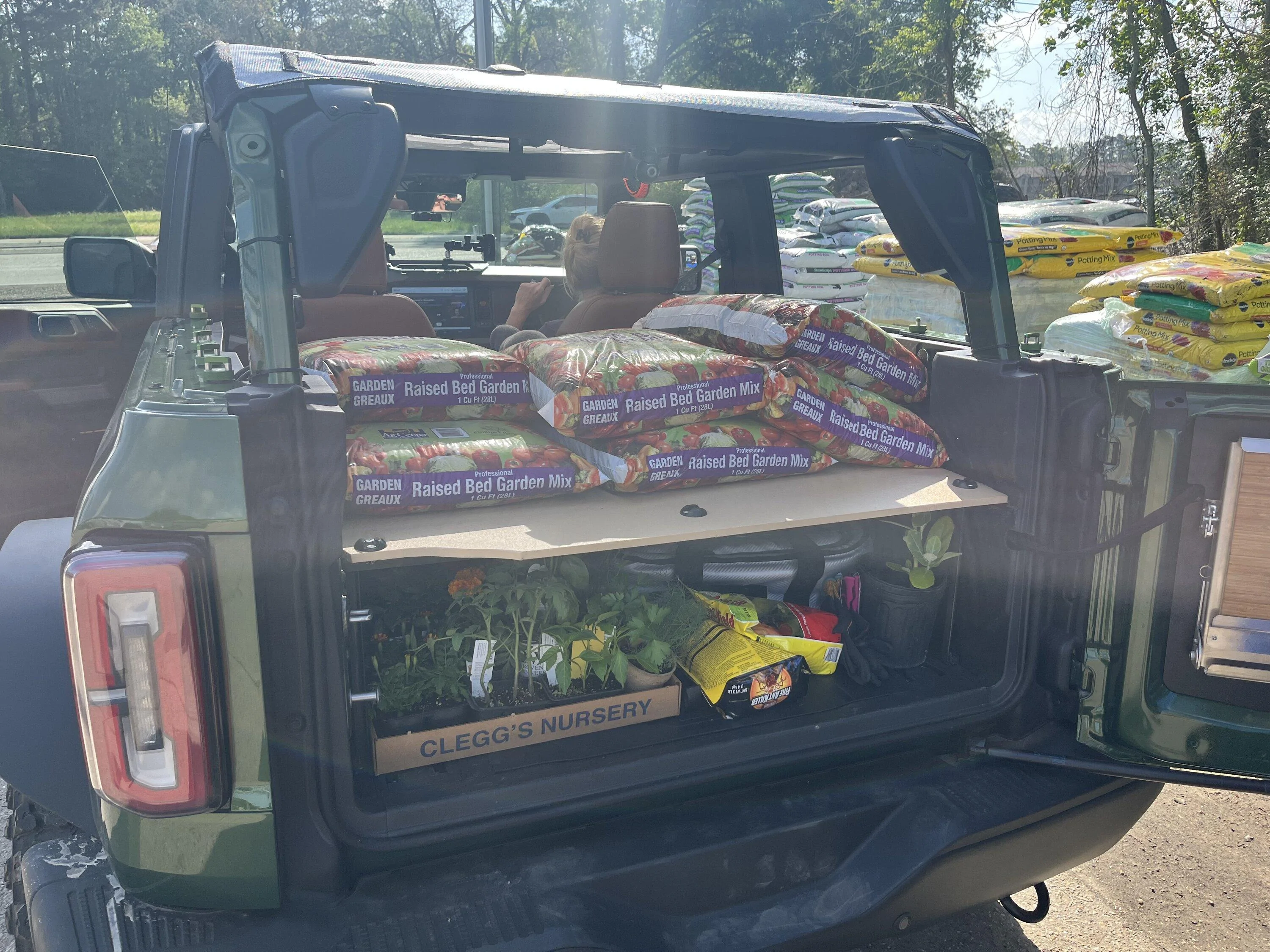

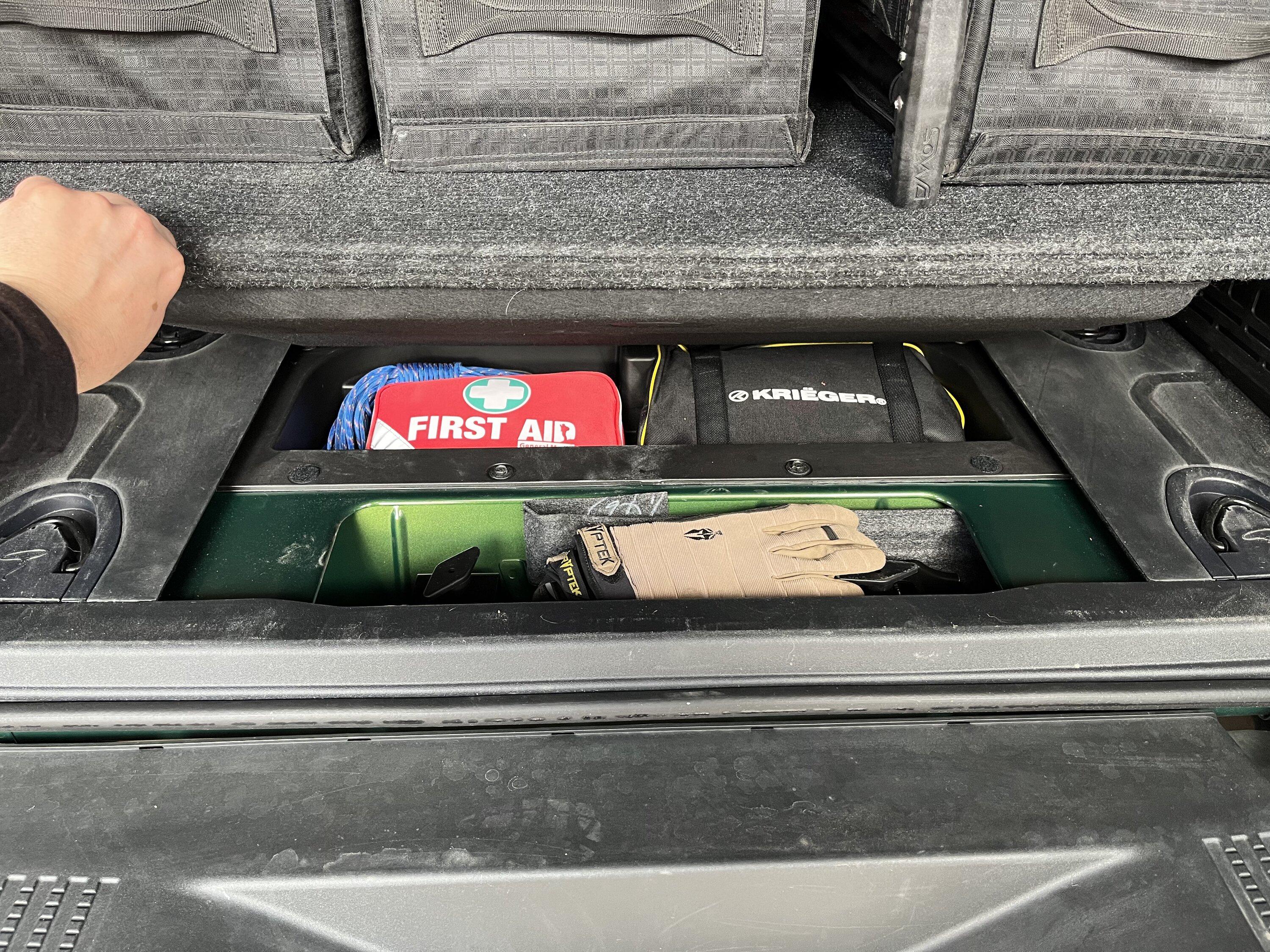

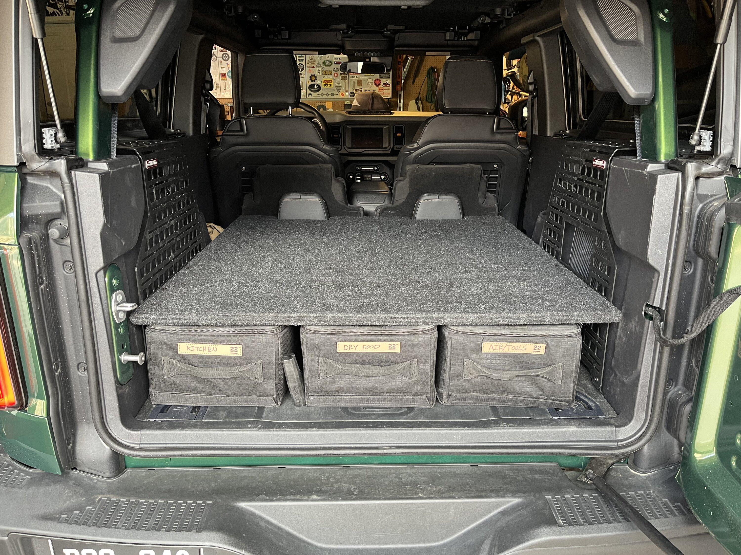

Tinker shelf is shaping up. Ended up using three 4x4 supports, two in the back corners, one dead center between the folded seats. Used some aerosol adhesive (I can hear the colors now) to bond the carpet in place & a handful of staples. Height was spec’ed around my beloved Step22 Stingray boxes. Next step is adding a few tie down anchors for my cooler & jerry (water) cans. Also need to install my Goose Gear tailgate table that I’ve had in my garage for a year. 🤪 Access to the lower / underfloor cubby is good to go.

Set up with cooler & water can tie downs. Still a WIP, but happy with it so far.
