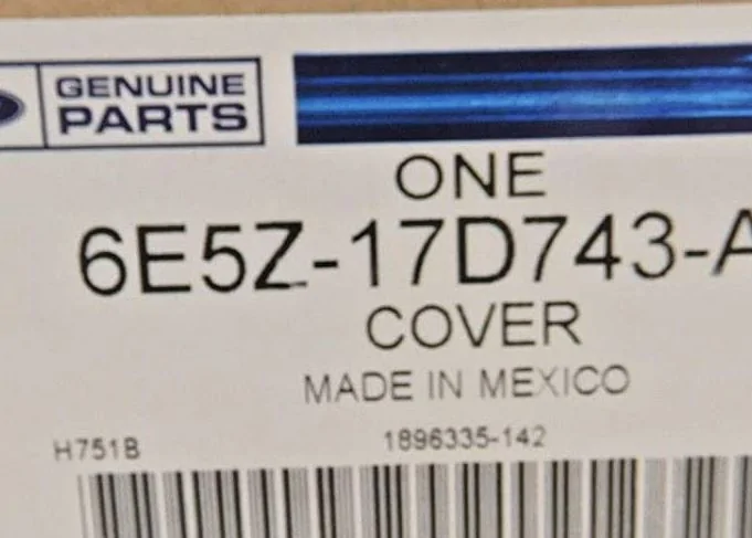

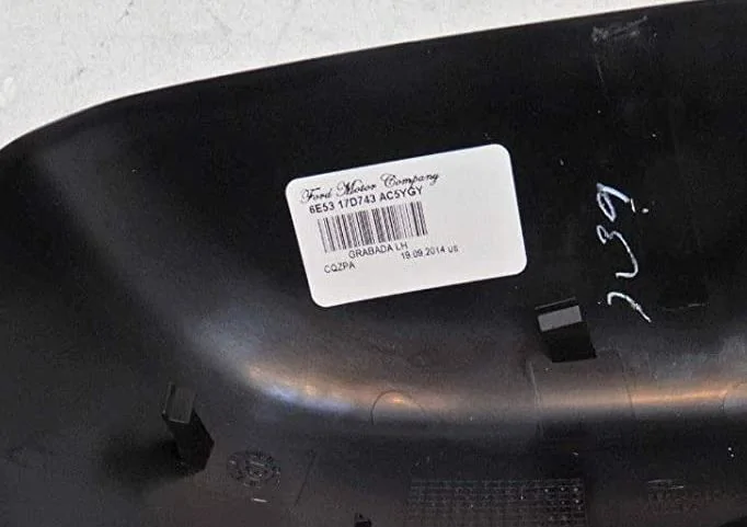

Just released today…
SSM 50324 - 2021 Bronco - Whistle Noise Coming From The Drivers Side Mirror Area - Built OnOr Before 23-Jun-2021
Some 2021 Bronco vehicles built on or before 23-Jun-2021 may exhibit a whistle noise from the driver side mirror while driving. This may be due to an excessivegap between the side mirror and mirror cap assemblies. An improved version of the mirror cap has been released for service. To correct this condition, replace the mirror cap with service base part number 17D743. Refer to the parts catalog for the VIN specific application.

Good news - I have that whistling, annoying AF. Hope there is a recall to fix. Is the fix a DIY type? I can probably remove and replace it, but can I buy the part and where? TIA

It’s a service message so I’d imagine they need to fix it and document it.

I wonder how much of a pain it will be to source out a painted mirror cap in a discontinued color, such as antimatter.
