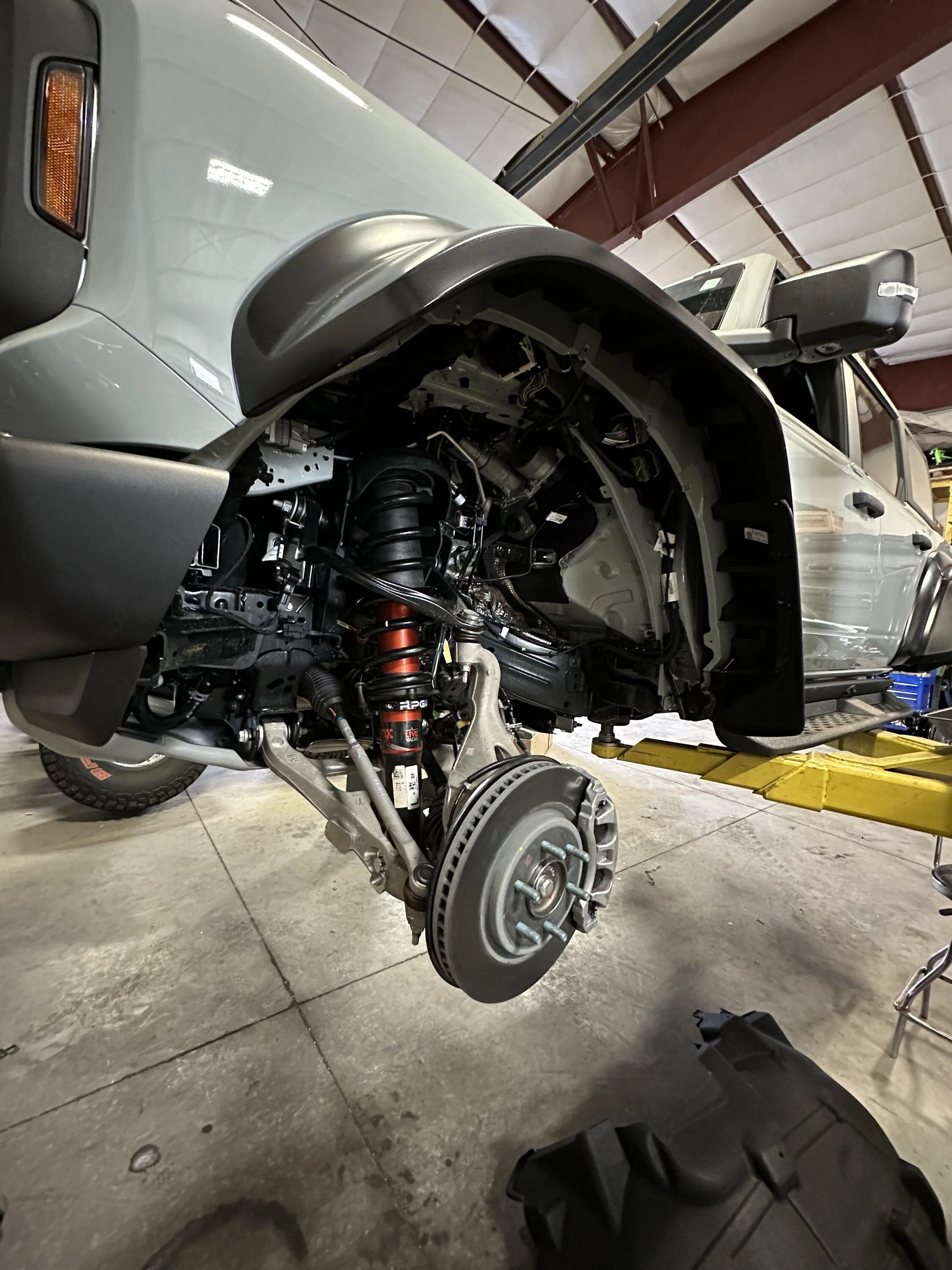

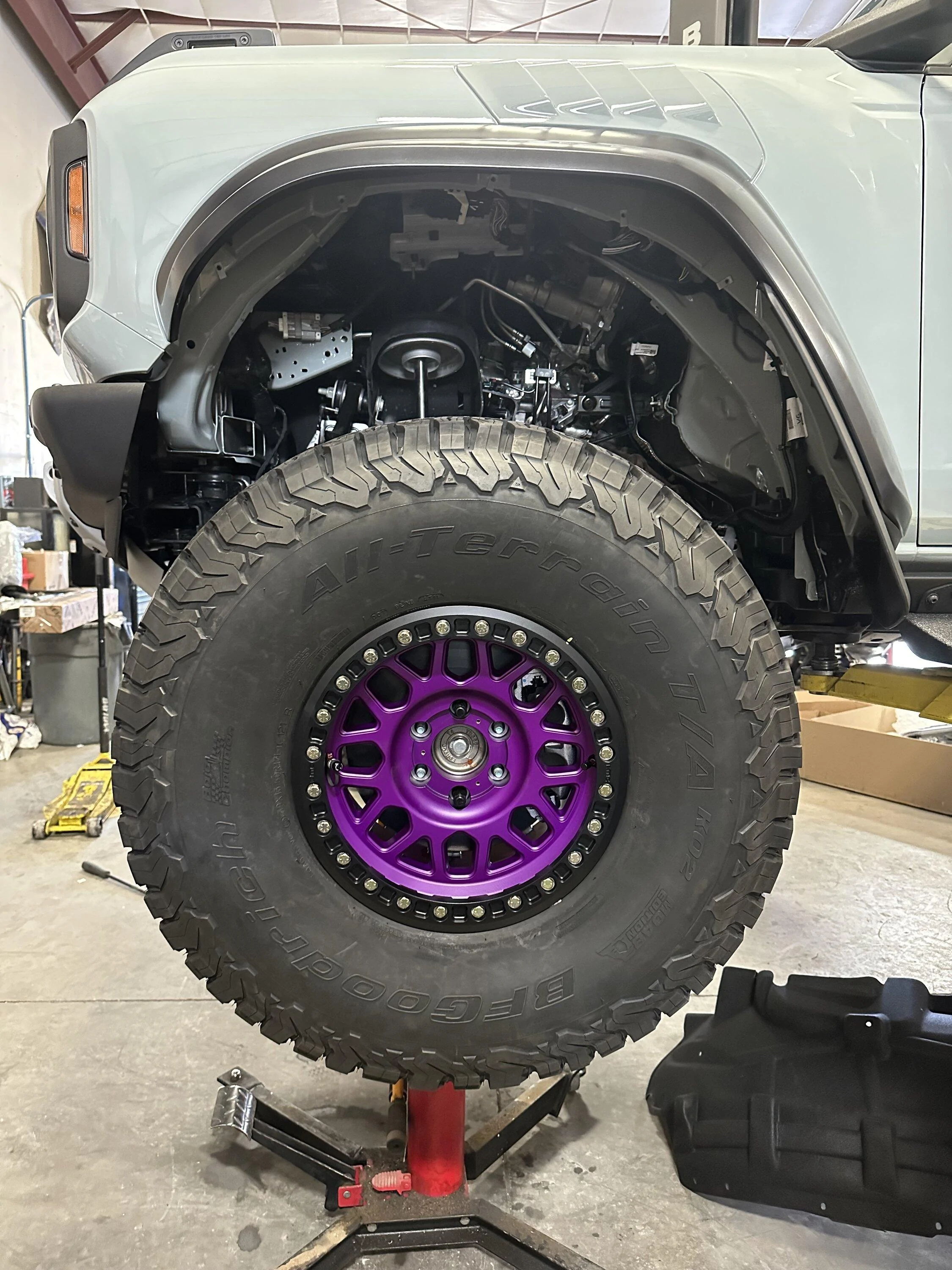

I put 39" BFG KO2s on. Lifted it with RPGS coil collars. Steering wise they they didn't rub too much stock height. but at full bump they did.

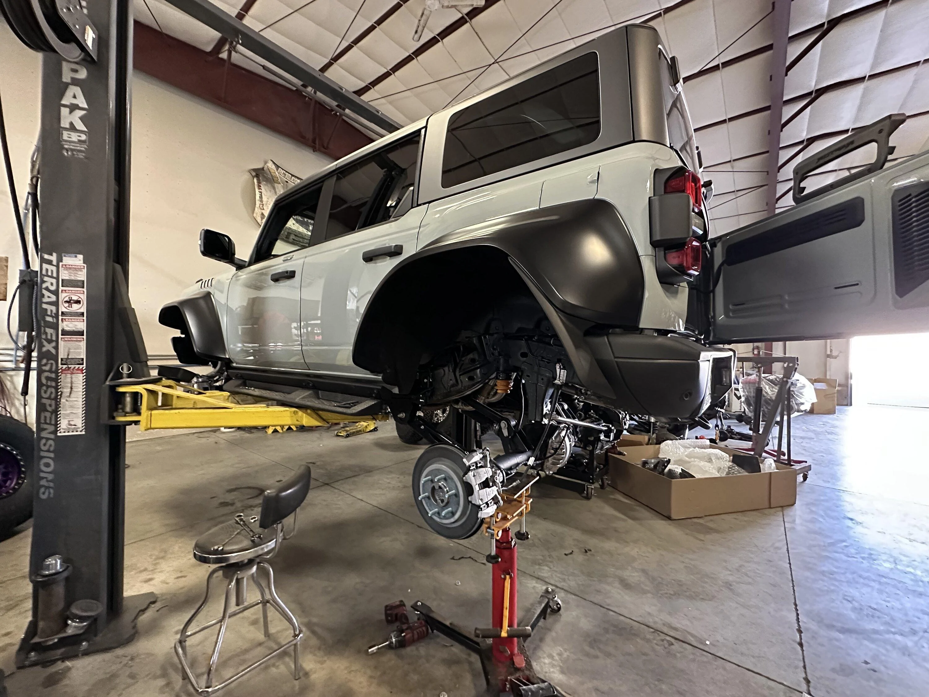

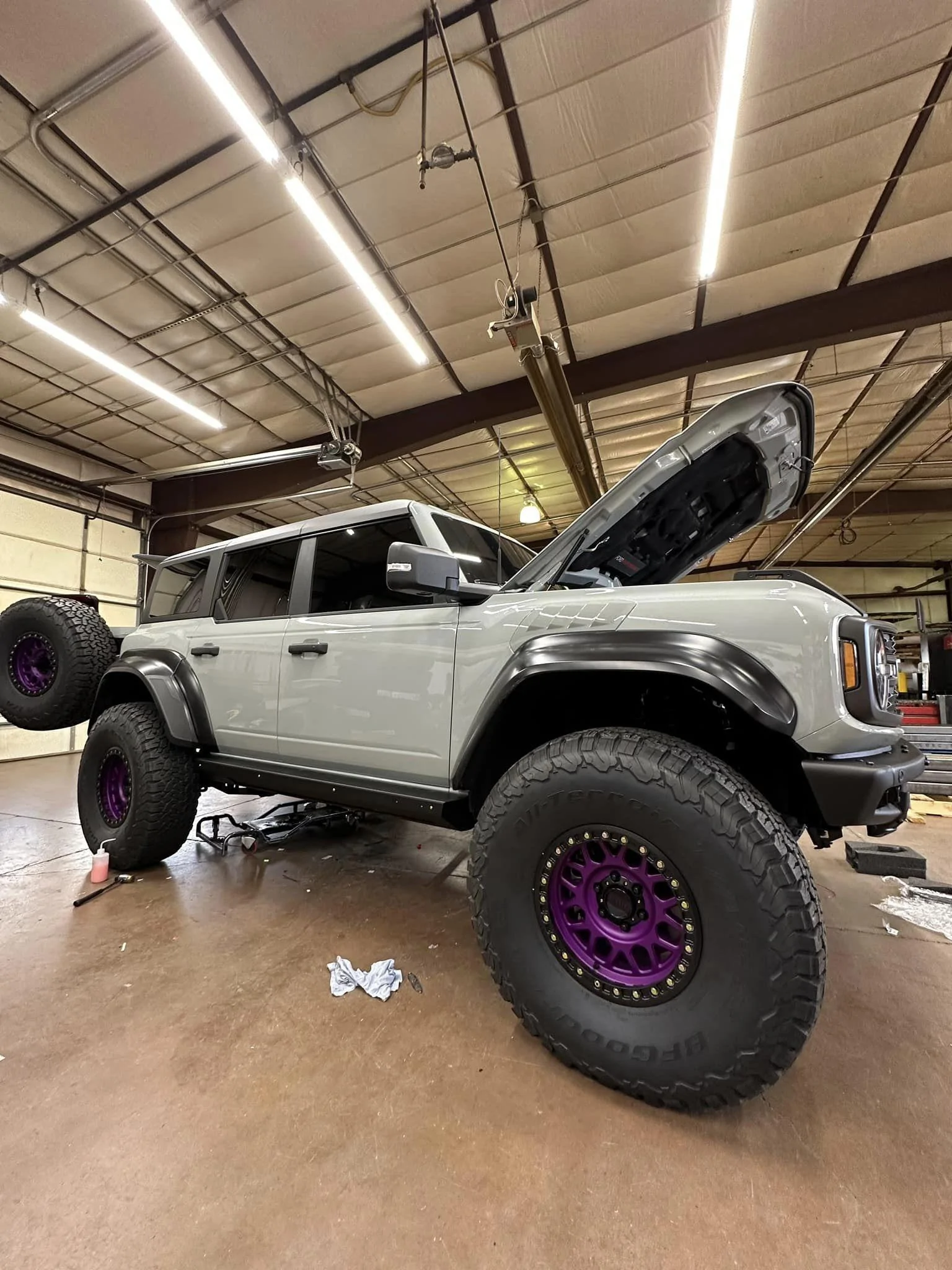

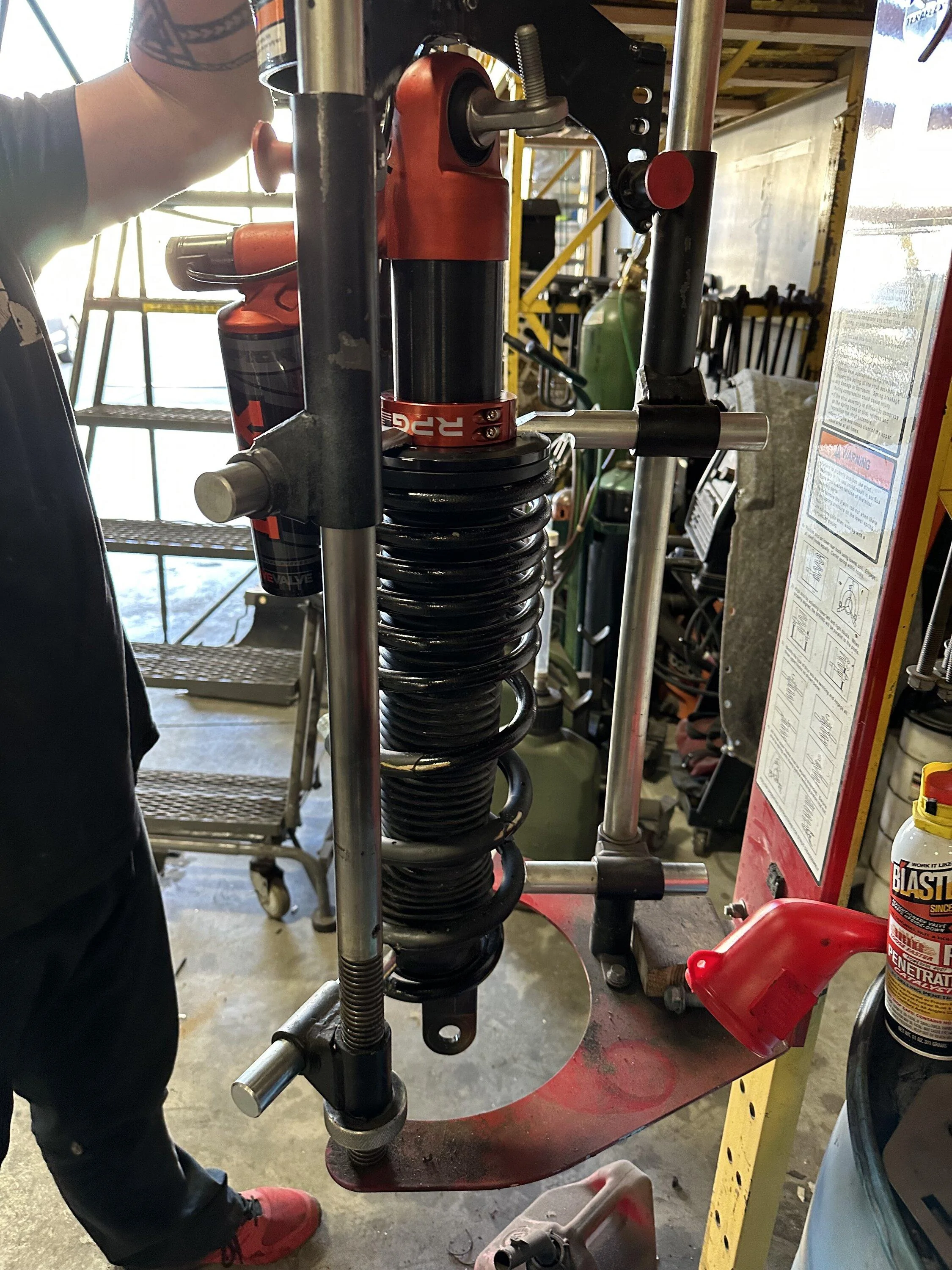

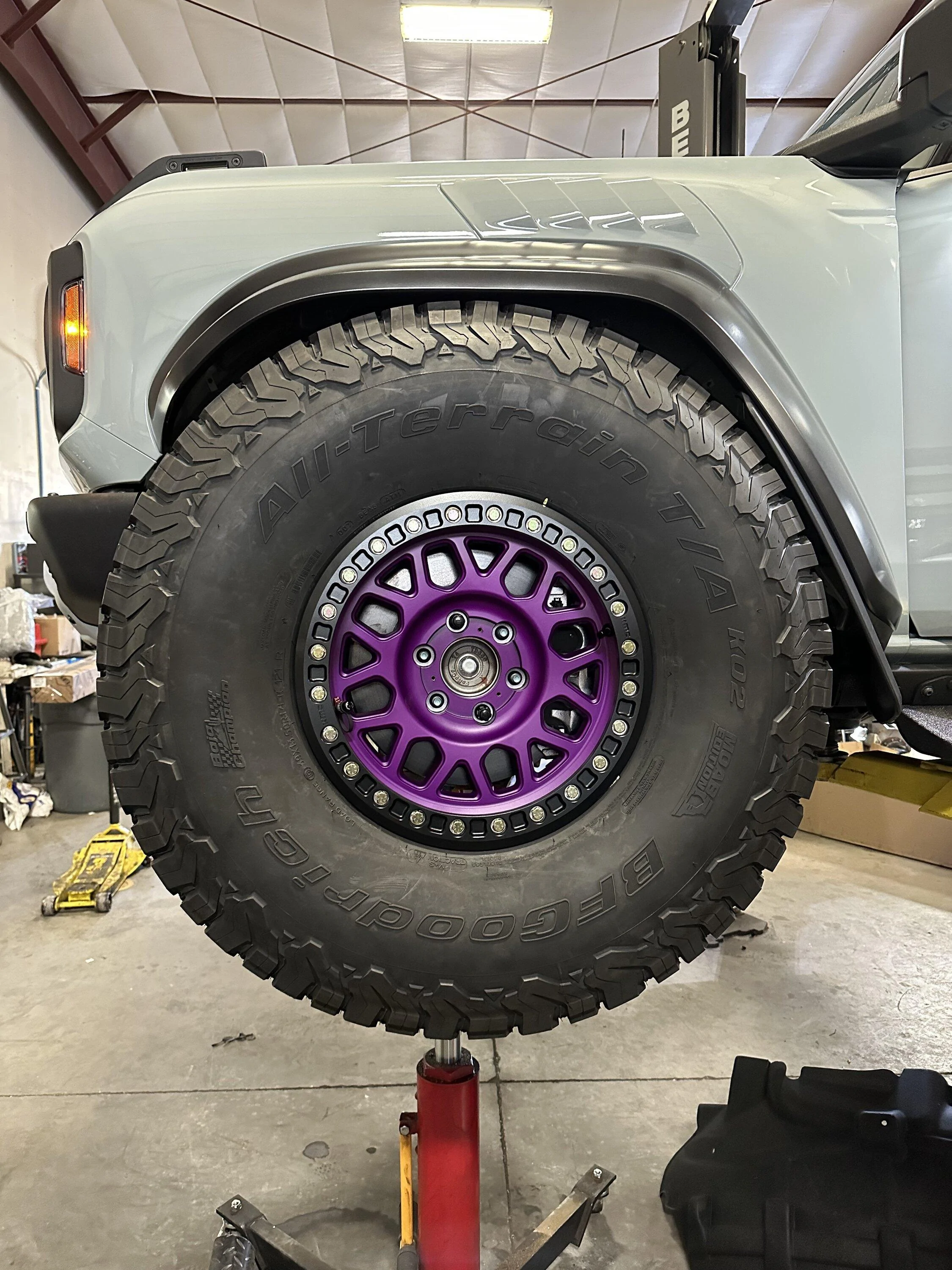

Yes keeping them on, the past tense was I put them on over a week ago. Here are more pics, fully tested clearance and measured for new really go fast fox shocks. I put on the RPG Coil collars until the new fox coilovers show up.

This is it next to a bronco with 37S
Ford Bronco 40" tires on a Bronco Raptor? IMG_1075
here is full droop and full stuff,

That's awesome, looks great. Where is it rubbing when it is rubbing?
What lift bump do the collars give you?
What shocks are you swapping to and assuming you will lose electronic shock sensors or are they somehow maintained? If lost how will that impact on board electronics ?
