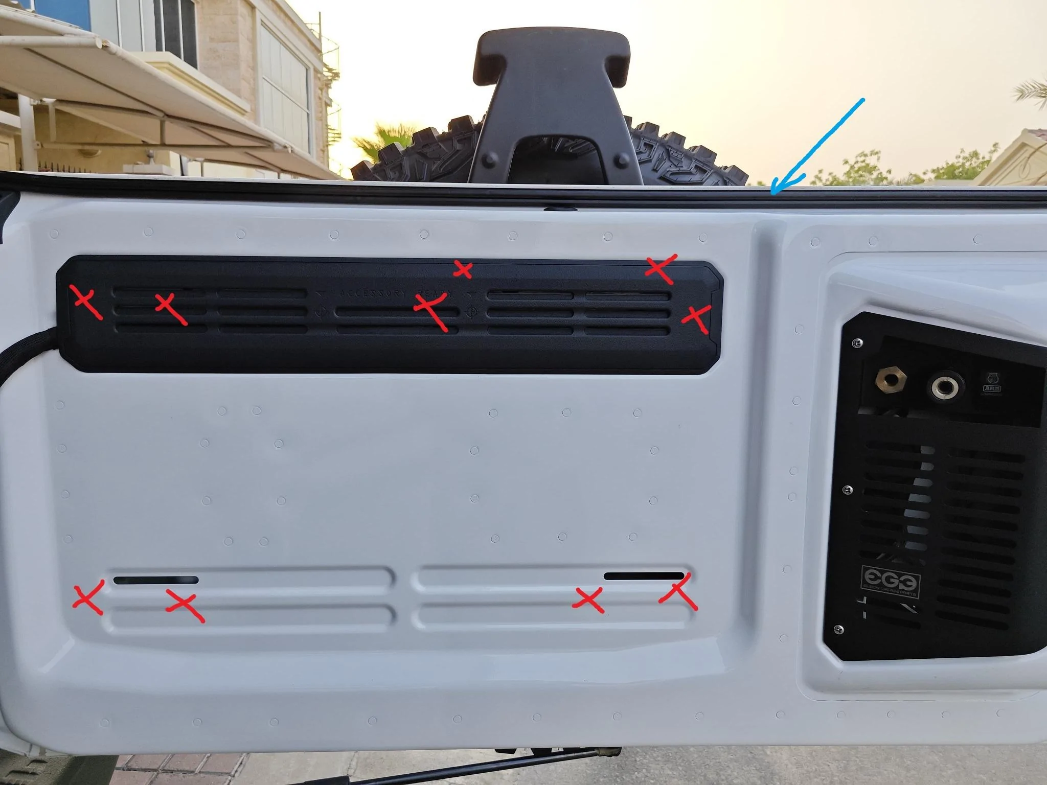

Hey guys,
So I had this same issue. Damn annoying but thankfully I have managed to 100% remove the sound. With the help of this forum ofcourse.
To save you time from all the reading, basically getting the replacement tailgate may or may not help. It seems to be more of a design flaw and some people have got a replaced tailgate with the problem persisting.
For me personally, I am living in the UAE and this whole tailgate replacement thing is a massive massive hassle. Specially when I too have custom tailgate support bracket similar to the hammer built one and PPF on the car. I have to go to several difference garages to fix everthing so essentially going to the dealer is out of the question.
- First step is to go to local DIY/Hardware store and buy some lithium grease as well as a window gasket or seal. Any basic hardware store should have these.
- Second, open the tailgate and fit the gasket in the position shown in the photo(Blue arrow) This will stop the rubber to rubber contact creaking sounds.
- Third step, get your lithium grease with the straw and spray it in the marked locations (Red crosses). You will need to remove the black plastic piece, fairly easy. The marked locations are the main bolts that are causing the metal to metail ticking sounds. Some of them you will be able to see, the others are not so visable, but you can sort of figure out where they are by looking at the outside of your tailgate and just following the pattern.

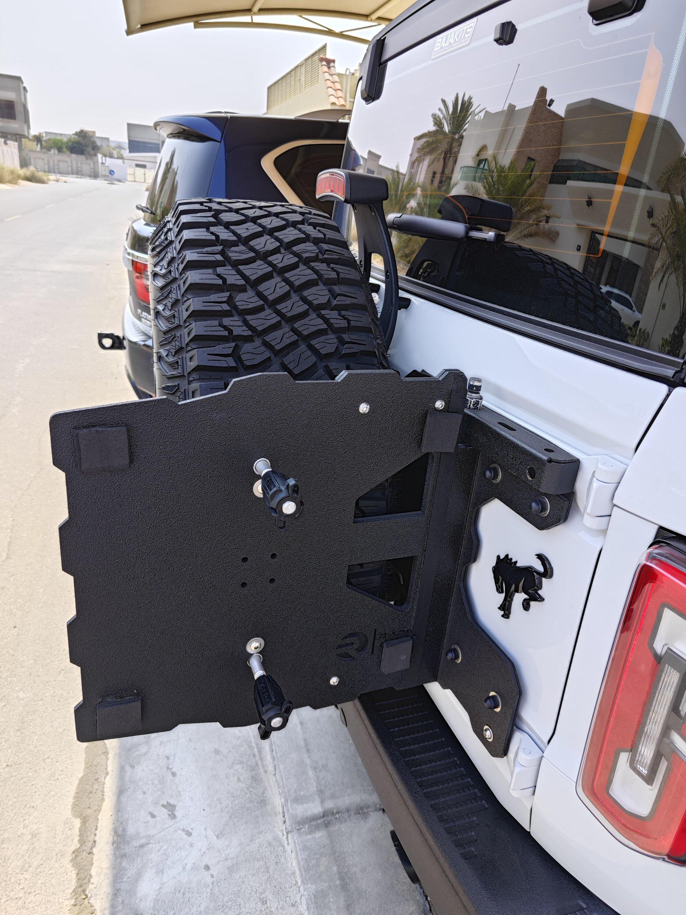

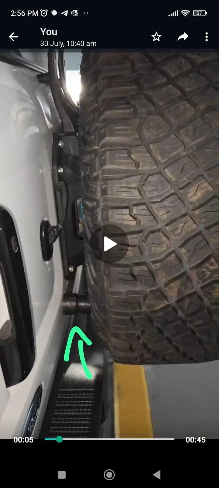

- Fourth step is to check and see if your spare wheel has enough support, because if you are running a minus offset on your rims, it is likely the spare wheel will be sticking out a bit, and the lower bumpstop supports are not enough to keep it in place. This means spare wheel will flex and cause all the tailgate bolts to flex and this just makes the noise worse. I managed to find a rubber peice used to put under chairs or something in the DIY store, seemed to fit perfect. You can also look at a little PVC pipe, anything that just extends the bump stop to keep that spare tire secure and limit movement. (Picture attached with green arrow pointing to it)
Then you may enjoy... perfect silence :)

Hey guys,

Thank you. Also there is a Ford bump stop that you can order that perfectly fits a zero offset. It is about $25 each you will need 2. Exact same as oem but sticks out further for perfect zero offset fit. Search this forum and there is a part #. I guess I will try the grease and see. It is so hard to tell tailgate vs all the soft top rattles.

Hey guys,

Thanks for this. One question -- What's the best way to check to see if the spare wheel bump stop needs extra support? I'm running the stock Black Diamond wheels and tires. The bump stops seems solid, but I'm not sure how best to test them to see if I need to put a rubber piece under them. Any suggestion on that?
Lak34ers
Troy
Oct 4, 2021
97
1,203
1,092
Seattle
If the bump stop is touching against the spare tire you are good. Factory should be fine with no mods. It's when you go to a lesser aftermarket offset wheel and there will be a big gap between bump stop and spare tire. Zero offset is getting more common in aftermarket with is about 1.5 inches out vs stock wheels.
