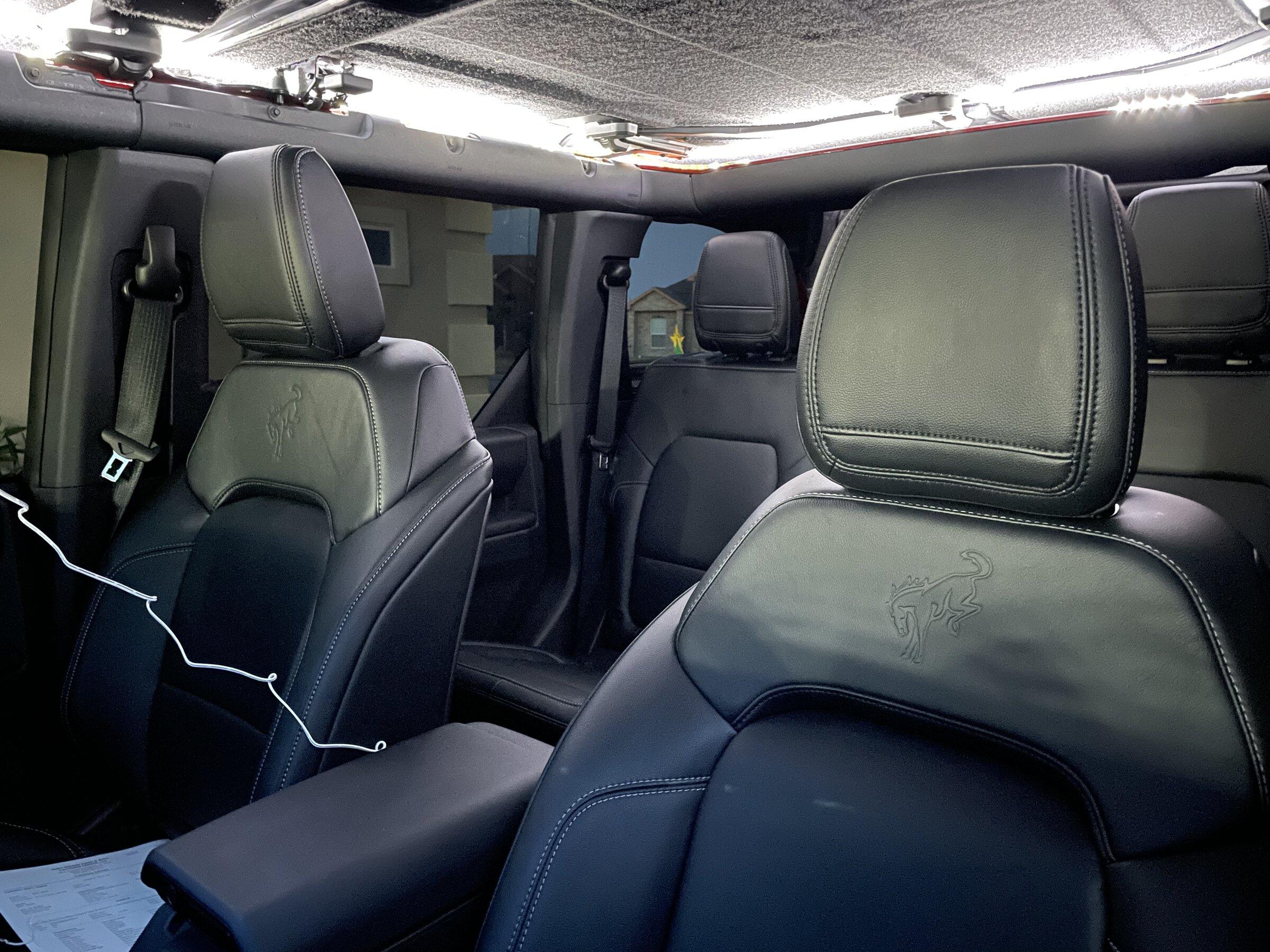

If I could figure a way to halfway hide the wires I’ll use that spot
Any idea where my closest AUX switch wire is for this location?
(How did you hide your wires?)
I ran them behind the airbags. I'm sure our 80's has-been who's never going to give you up or let you down will find some imminent safety concern for that as well. :ROFLMAO:

So you screwed into the plastic?
Yep, there's a decent cavity behind the pillar covers, so using 1/2" screws didn't interfere with anything. 2 holes for the screws, one in the center for the wire to pass, and Bob's your Uncle.

Ksjrb03, did you ever finish your LED strip version? That's my favorite concept so far.
No, I refuse to use an aux switch and am on pause working on other projects. I was hoping a vendor I reached out to would be interested. I still have them taped up there lol. It’s a perfect solution and the only way I would go, I’m staying away from the airbags personally.

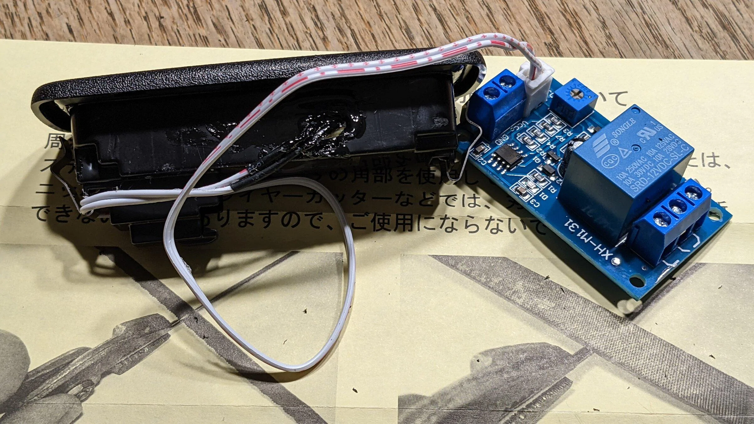

Light sensing relay showed up today and the sensor is being glued into the light housing.

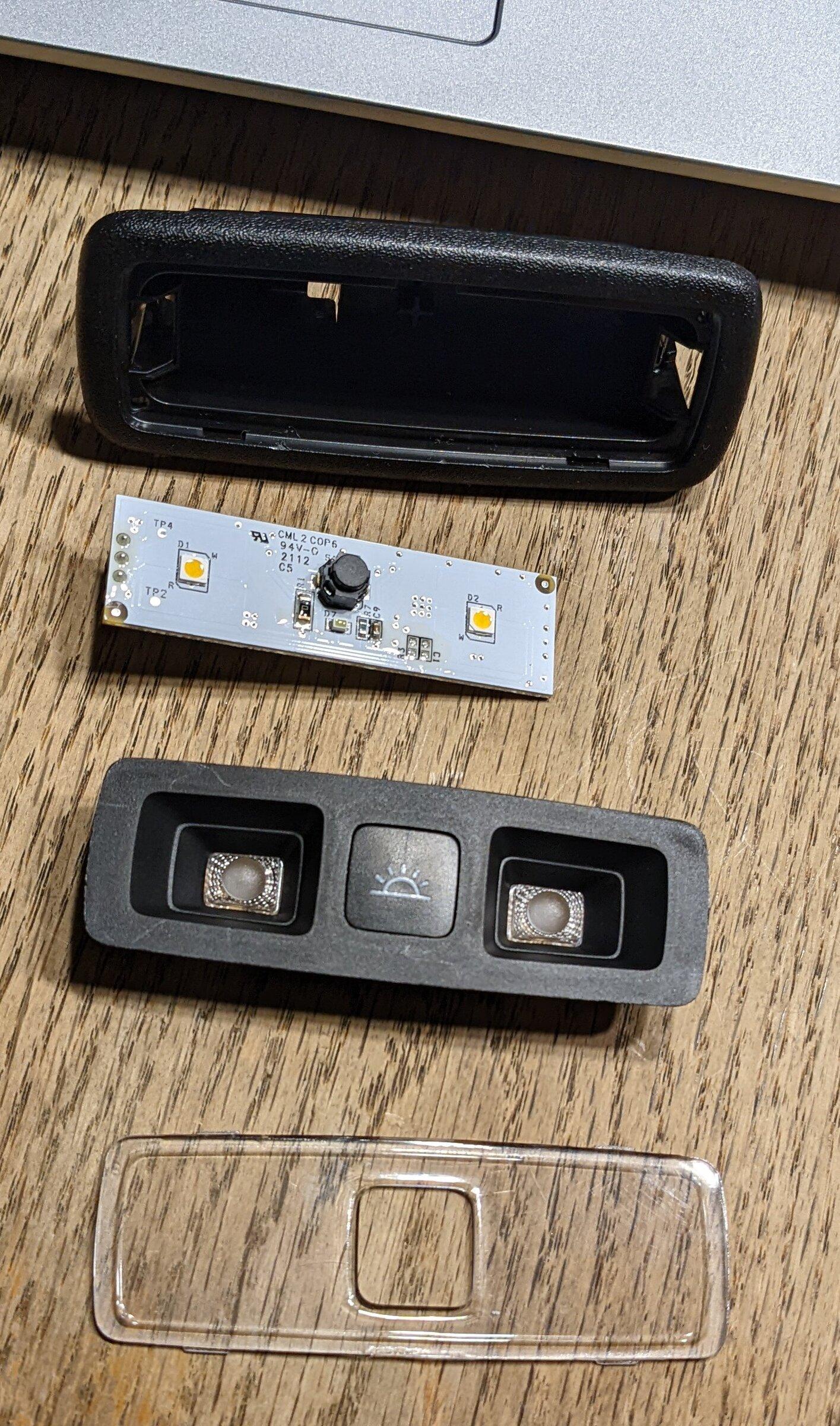

For those curious, this is what the dome light looks like (there's more components on the back of the board):
Ford Bronco Additional dome lighting, Jim style PXL_20220311_011115529

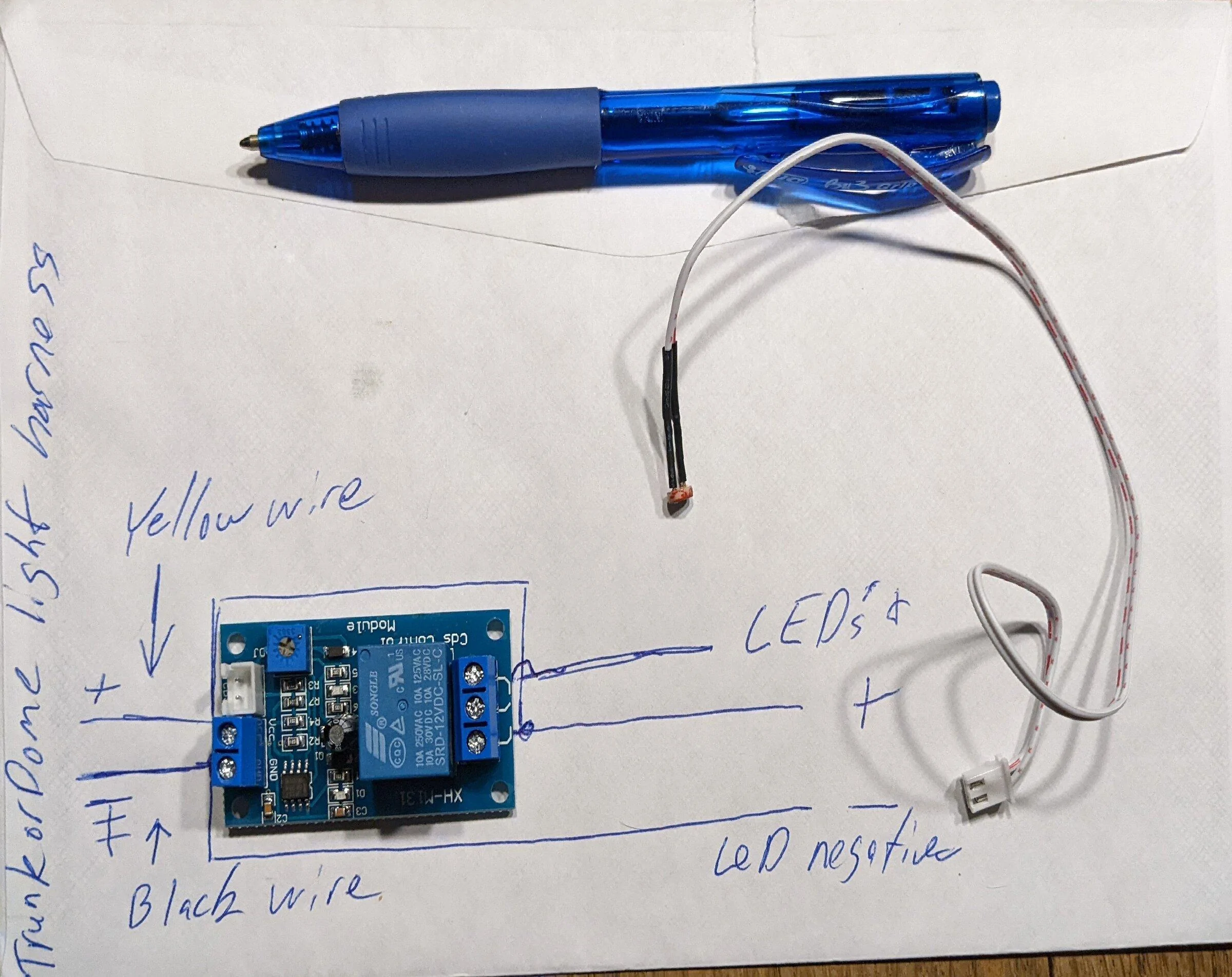

Can't wait to see the "How to" on getting this done!
Not much to it. Just used the constant 12v (yellow wire) to feed power to the relay, then jumpered that wire to the relay's input, then hooked the additional LEDs power wire to the other side of the switched side, grounded the relay and additional LEDs to the black wire, glued the light sensor in the dome light, wrapped the circuit board with electric tape, and Bob's your uncle.
Photocell relay

And correct me if I’m wrong but your set up seems to work like this:
the light-sensing relay senses the dome light is on….and in turn…that turns on your after market LED’s?
