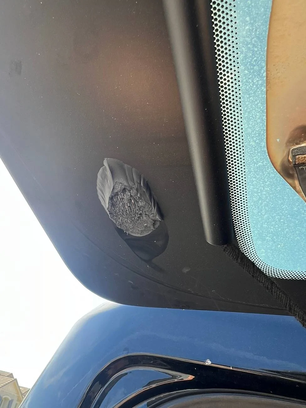

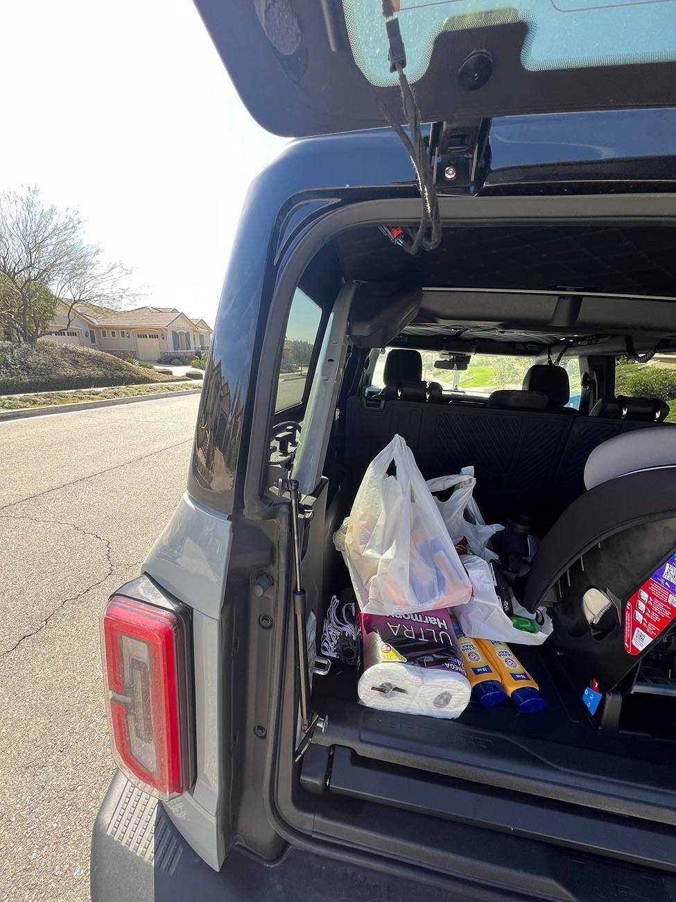

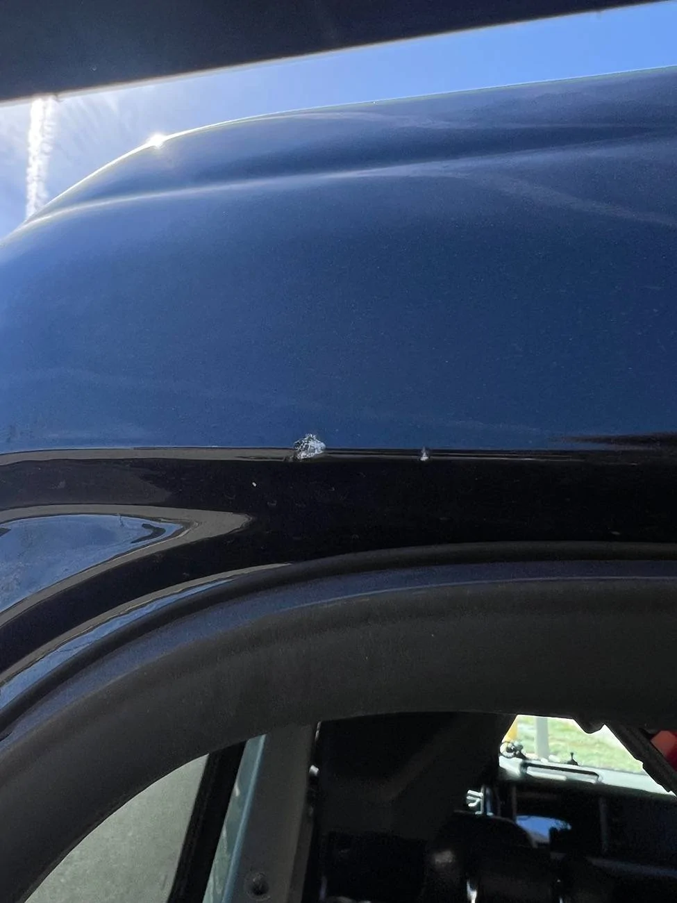

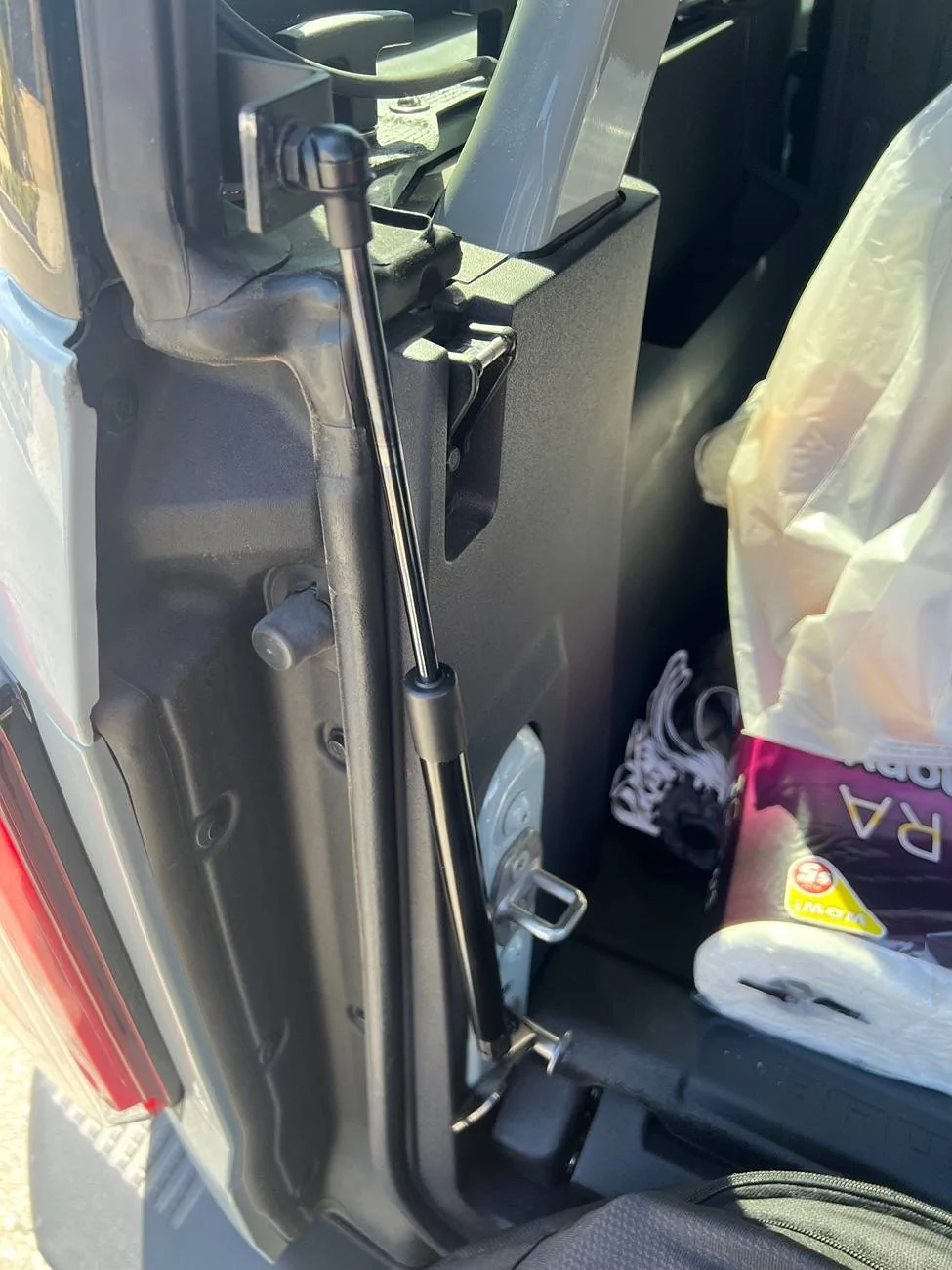

Just changed my vote to No
Literally just now went out opened my rear glass to put stuff in the trunk and the adhesive on the driver side strut FAILED. The strut then scratched the paint above the rear glass on the top since nothing was holding it in place.
Going to call Anderson to give them a chance to make it right.
If they do I’ll change my vote back to yes. It’s been less than a year of me owning the thing smh

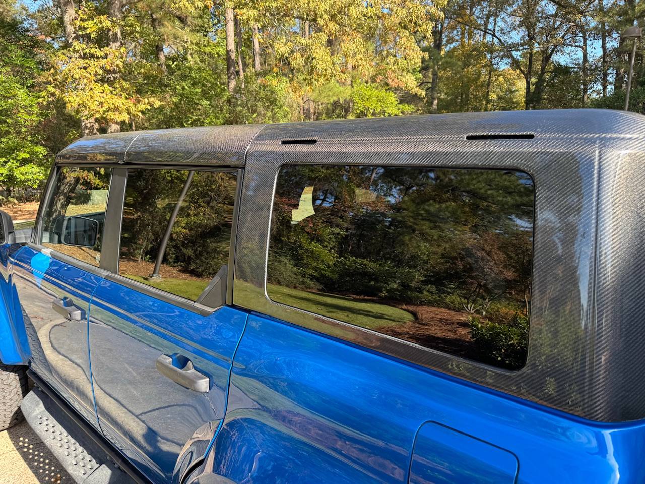

1) Yes. I bought the carbon fiber version for my Raptor.
2) Yes, I really like it so far. I damaged my OEM MIC top in a rollover crash. At the time I ordered it (Dec. 2022), there were no other options on the market that I liked, so I went with the CF. I don't regret it at all. It looks amazing in person and is a much nicer top than the OEM MIC top.
3) Yes, I'd recommend it. The fitment of the panels and overall quality is much better than the OEM MIC top. I'll also offer a caveat similar to @BroncoBoy22 - be prepared to request replacement rear hinge covers. Mine broke within a month of installation, as has happened with several other owners. Still wouldn't stop me from buying another one.

Sorry to hear that man. Please let us know what Anderson says/does for a strut replacement

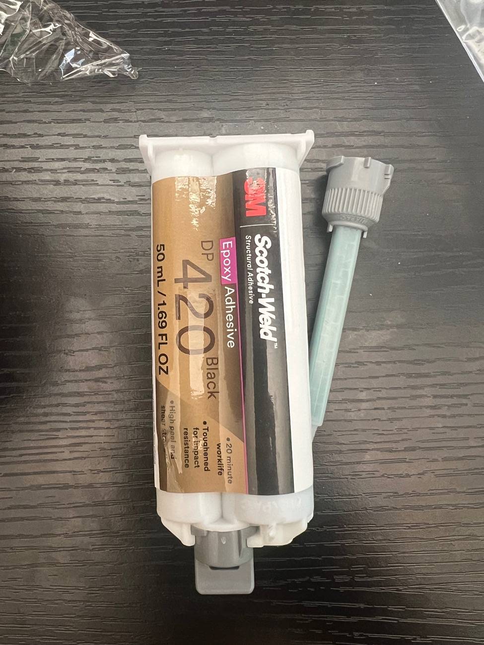

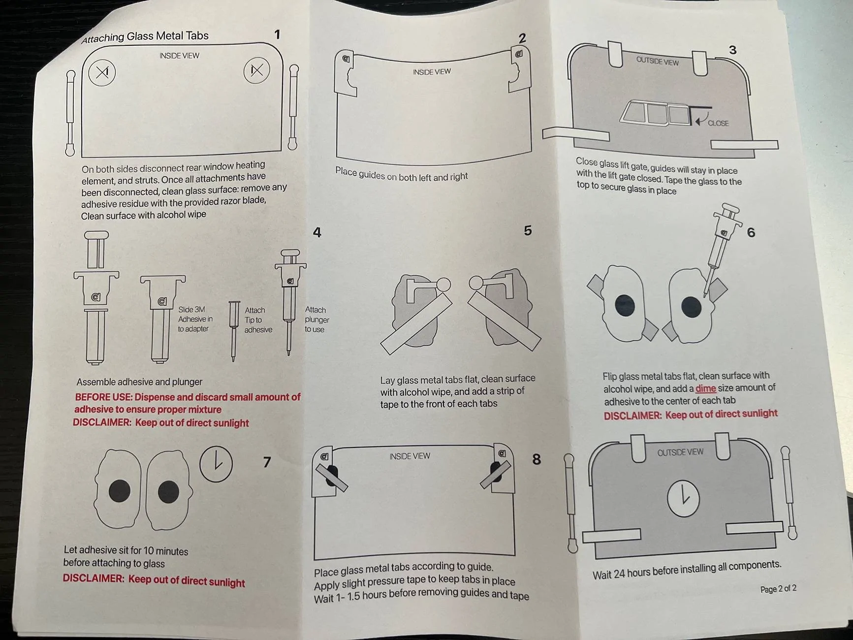

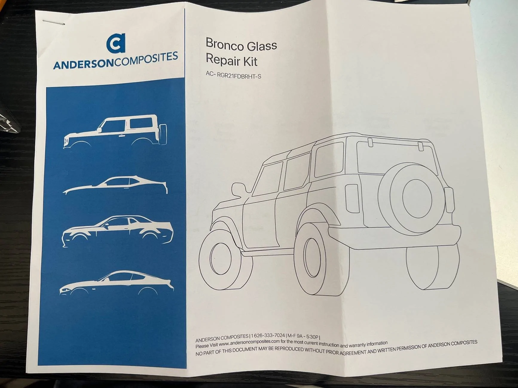

I got the kit in from Anderson! Going to attempt the repair this week. Does this type of Adhesive look good for this application by your experience?
I am appreciative of them because mine is out of warranty and they sent the kit without issue

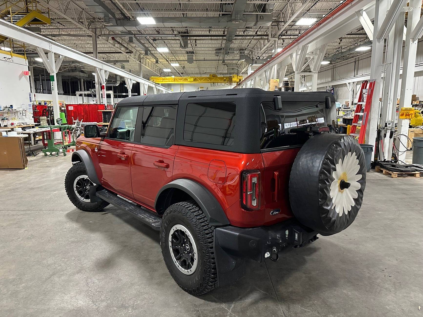

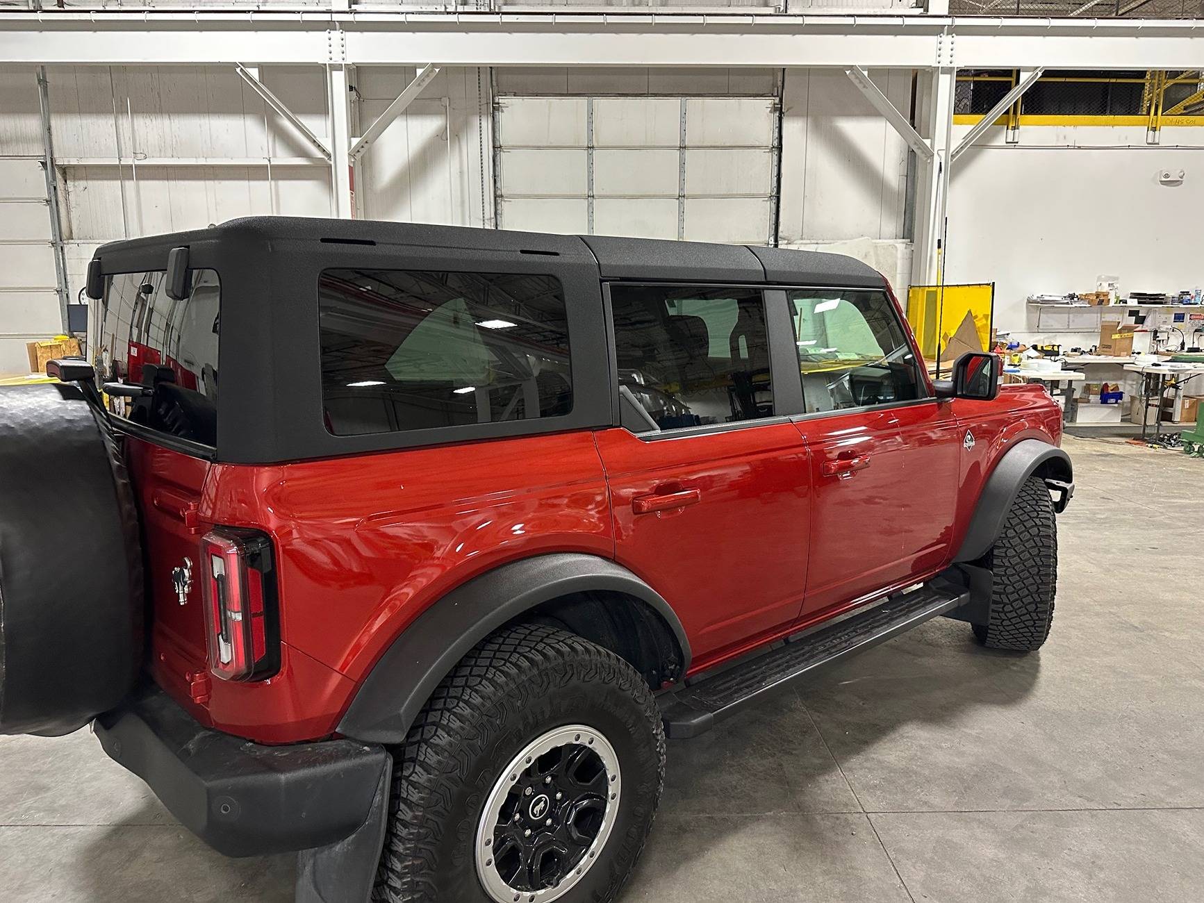

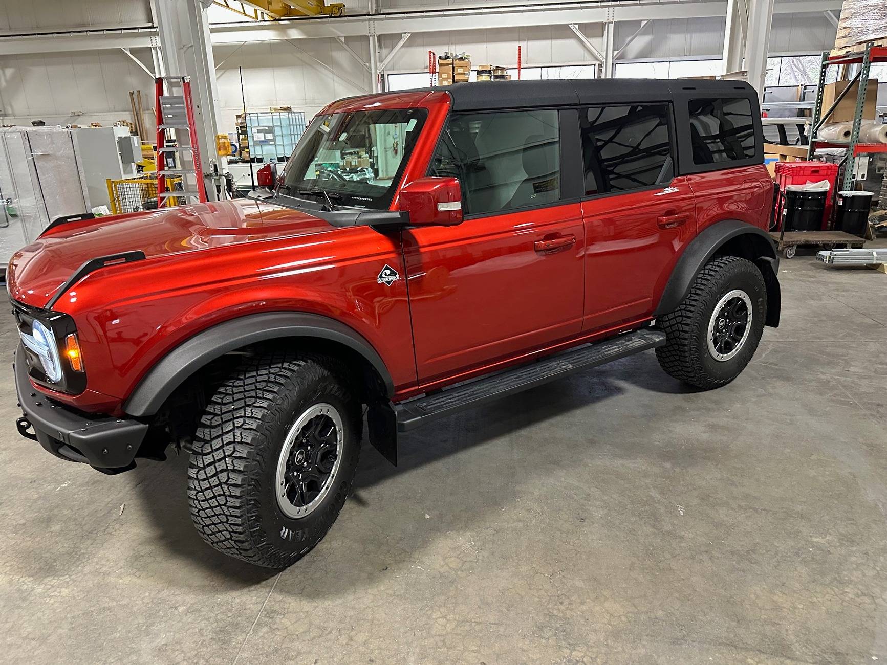

Just received ours and installed it today. The alignment isn't perfect but I will let it settle before I make any adjustments. Overall we are happy with the purchase so far.

Update: finally got around to fixing the shock mount with Anderson kit. I followed @Big Boss and Anderson’s instructions to a T. Made sure all adhesive was removed and wiped down with the alcohol wipes they gave me. Gave it 2 days to cure without direct sunlight exposure. Then put the hardware back on and all is well!
I prob did a B+ job with the touch up paint but that’s ok it is a truck after all haha.
All is well that ends well. I thank Anderson for the kit
