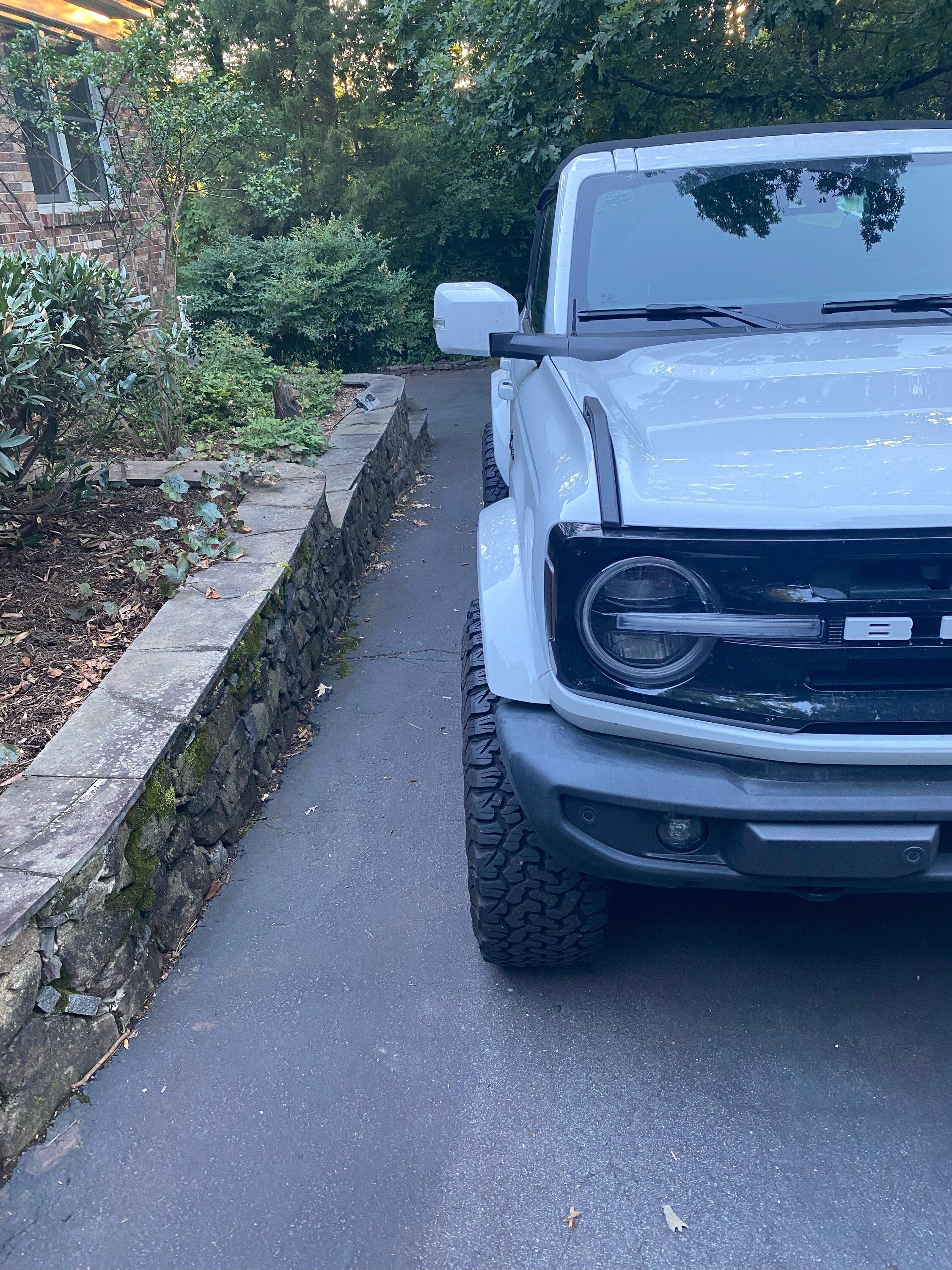

I am getting a non Sasquatch Outer Banks and want to put new wheels and tires on it. Anyone know where the current wheel sits in line with the stock flares? Based on pictures I have seen it looks like the wheel/tires might be about flush with the flares. The wheels I want to get say they will poke 1.73” out from the stock wheels. Wondering if this will equal about 1.25-1.50” of poke when all is said and done. Thoughts?

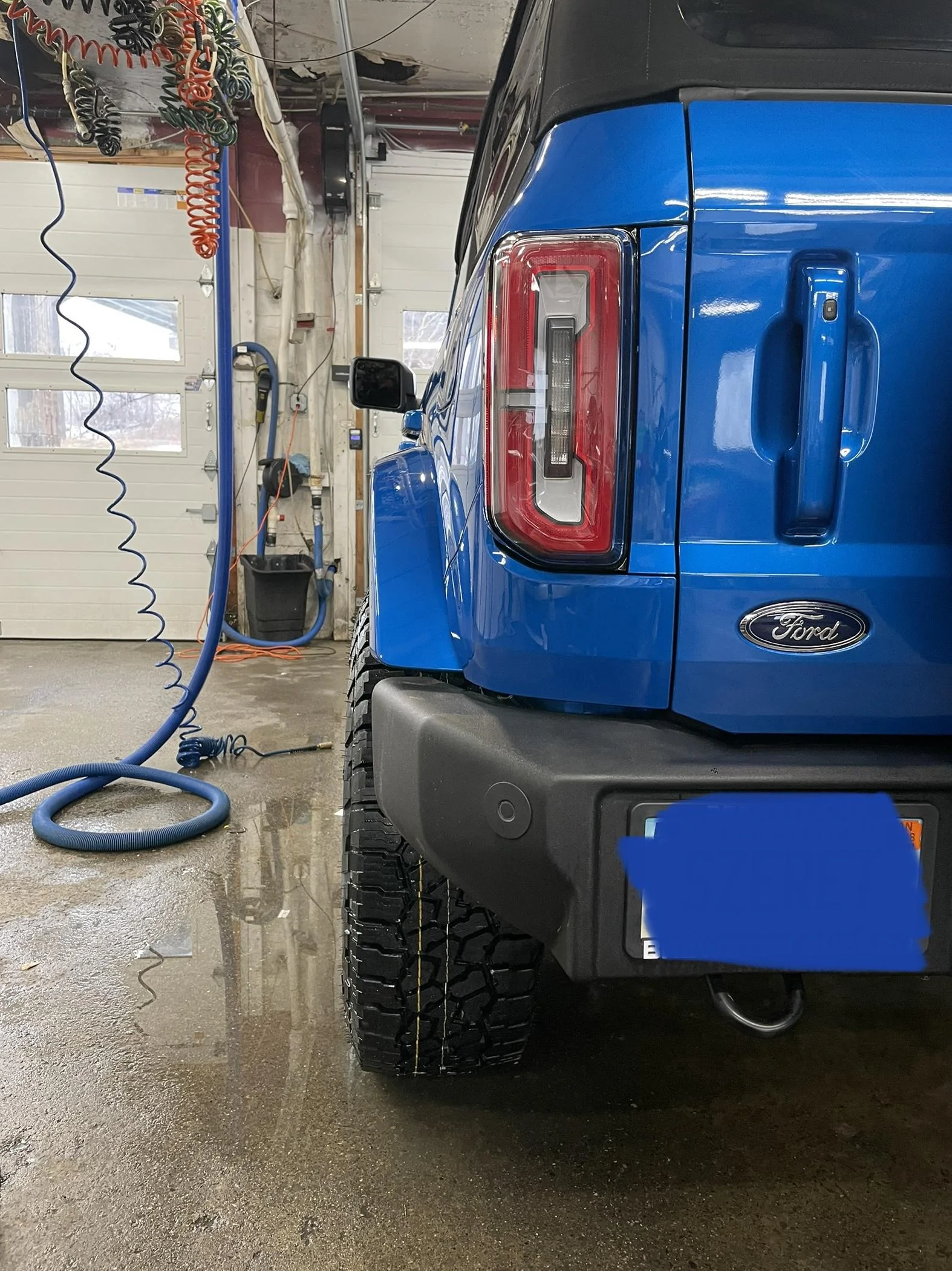

I was wrong my wheels are +25 offset KMC Mesa 18x9, tires are 35x12.5x18 BFG KO2s, with a 2 inch lift.

I am looking at a 17x9 wheel with 12 offset so based on where your is, I should have about 0.5” more poke. Yours looks great, I am ok with a little more poke. Just don’t want to go over 2”. I am lifting mine 2” as well and putting on 35’s too

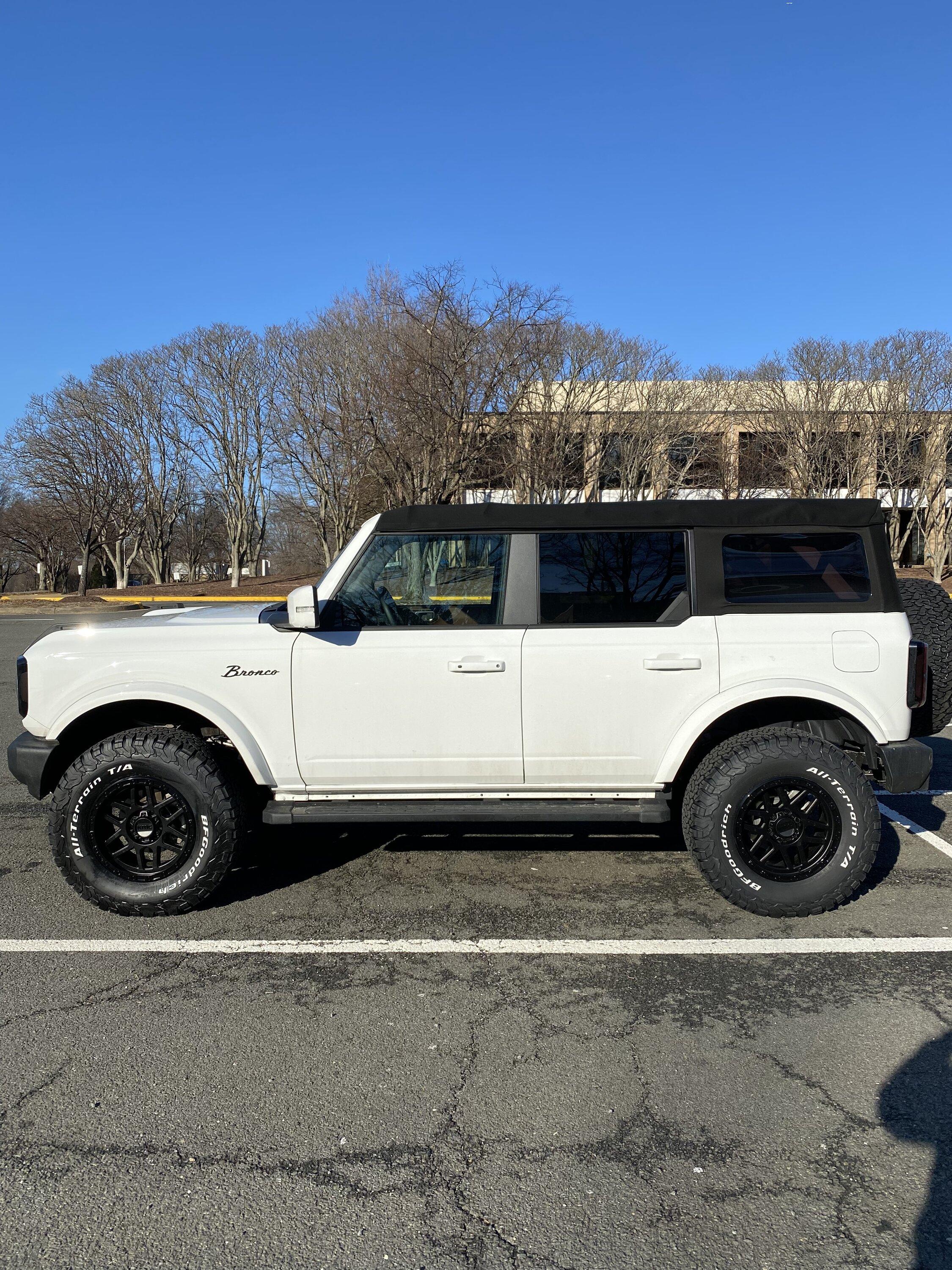

You got any side photos of your bronco? Curious to see what your wheels look like. Thx

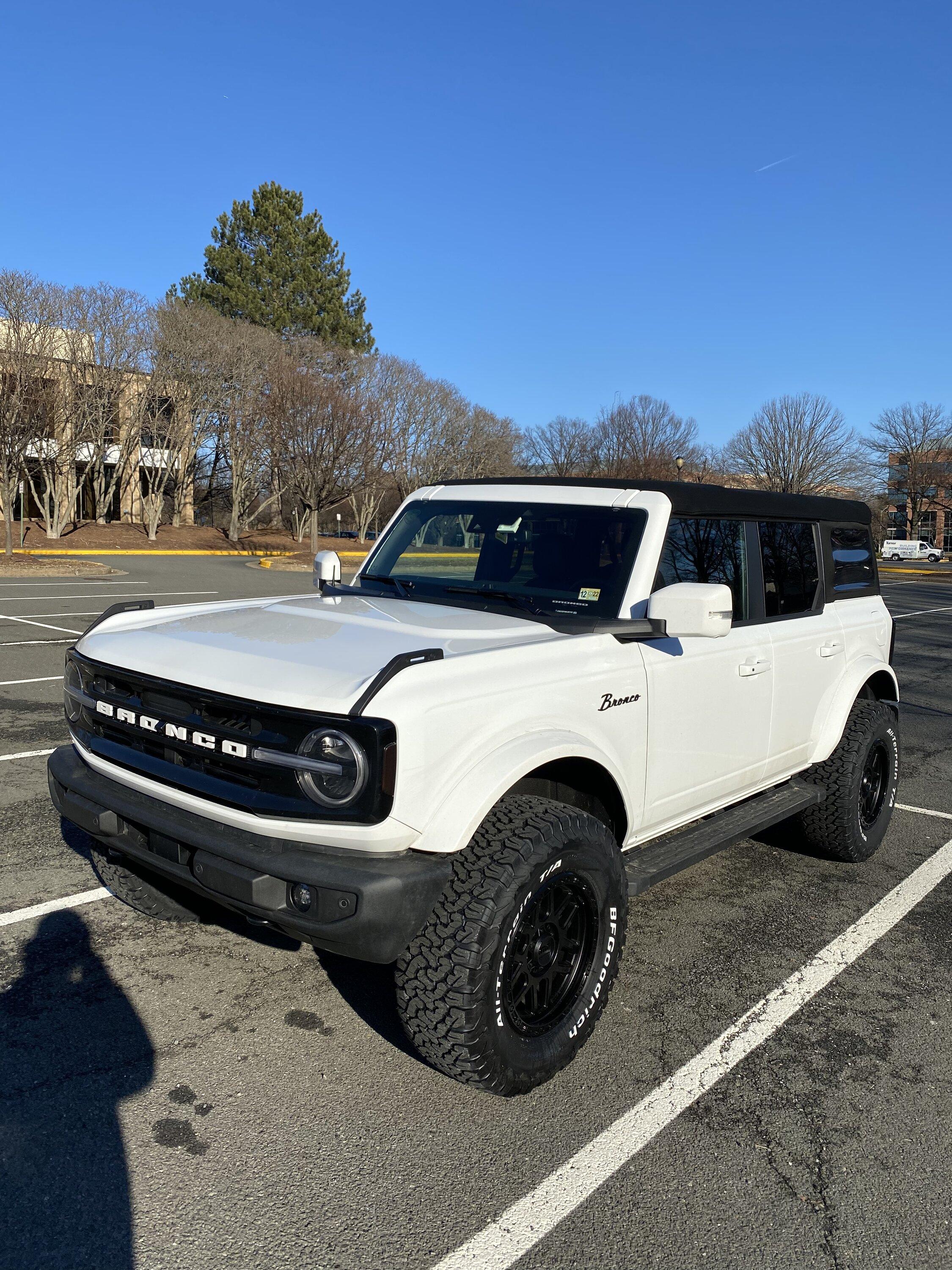

I’m running a +30 on my OBX. Here’s what it looks like.
Ford Bronco Any poke on non squatch Outer Banks? 6D1E903F-C327-4AC4-AF5B-2C1FF07C06A5
You absolutely nailed it. This is what a proper set up should look like and won't ruin the paint down the side of the truck. I will be shooting for this on my Badlands if and when Ford ever sends a golden ticket my way. There is always the ability to back up and punt a set of squatch flares if you bodge the wheel purchase and need to cover up a bit more. Doesn't the OBX lose painted flares with squatch anyway?
The OBX with Sasquatch does not have painted flares.
I prefer the look of the painted flares and didn’t need the Sasquatch package for what I’ll be doing.
The only thing about the OBX I didn’t like was the OEM tire/wheel combo.

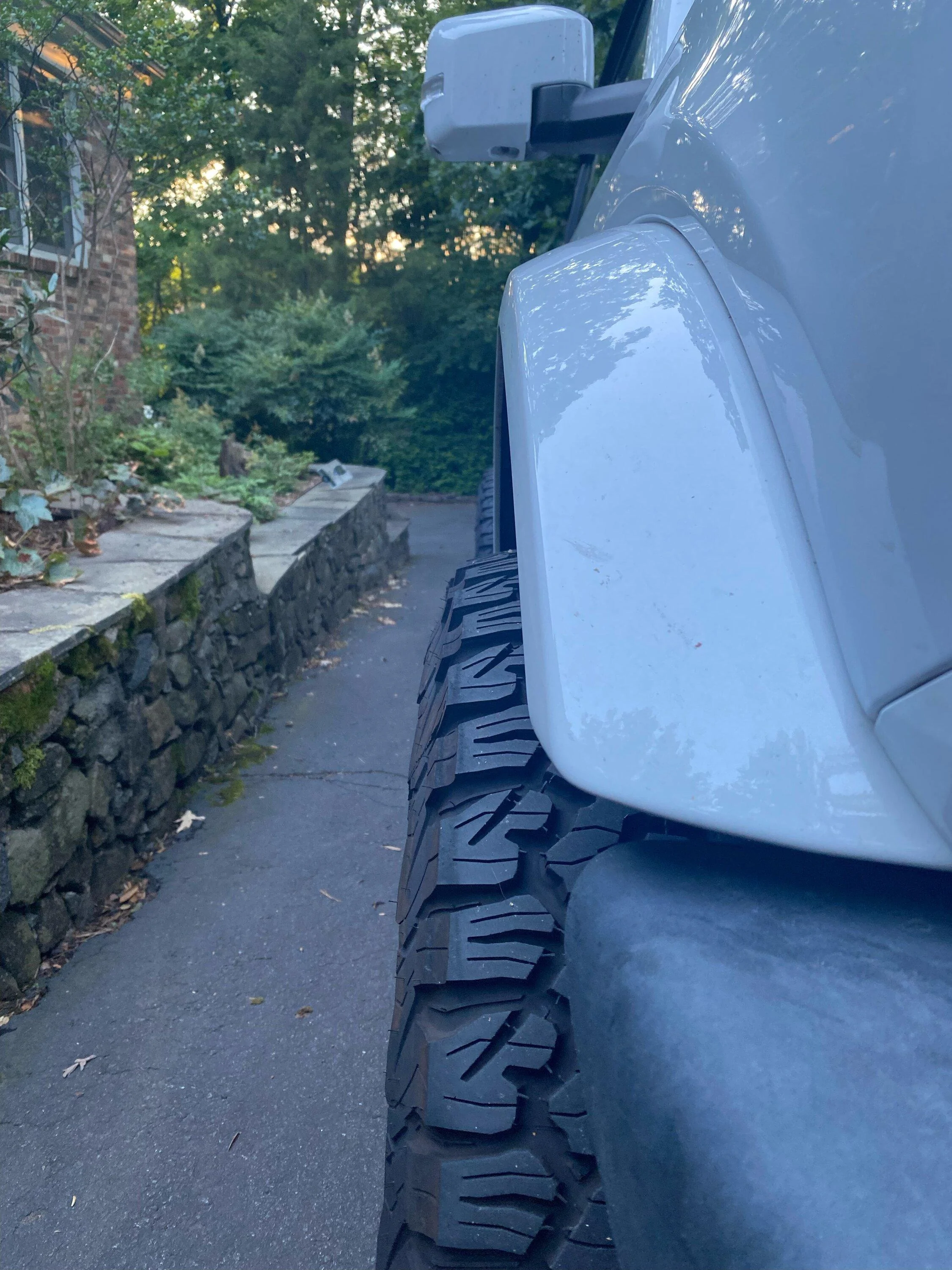

Yup. Here are a few more angles.

You sure your KMC Mesa's aren't +18mm Offset? I am on their website and the 18x9 or 17x9 Mesa's say they come in 18mm Offset. There is no option for 25.
