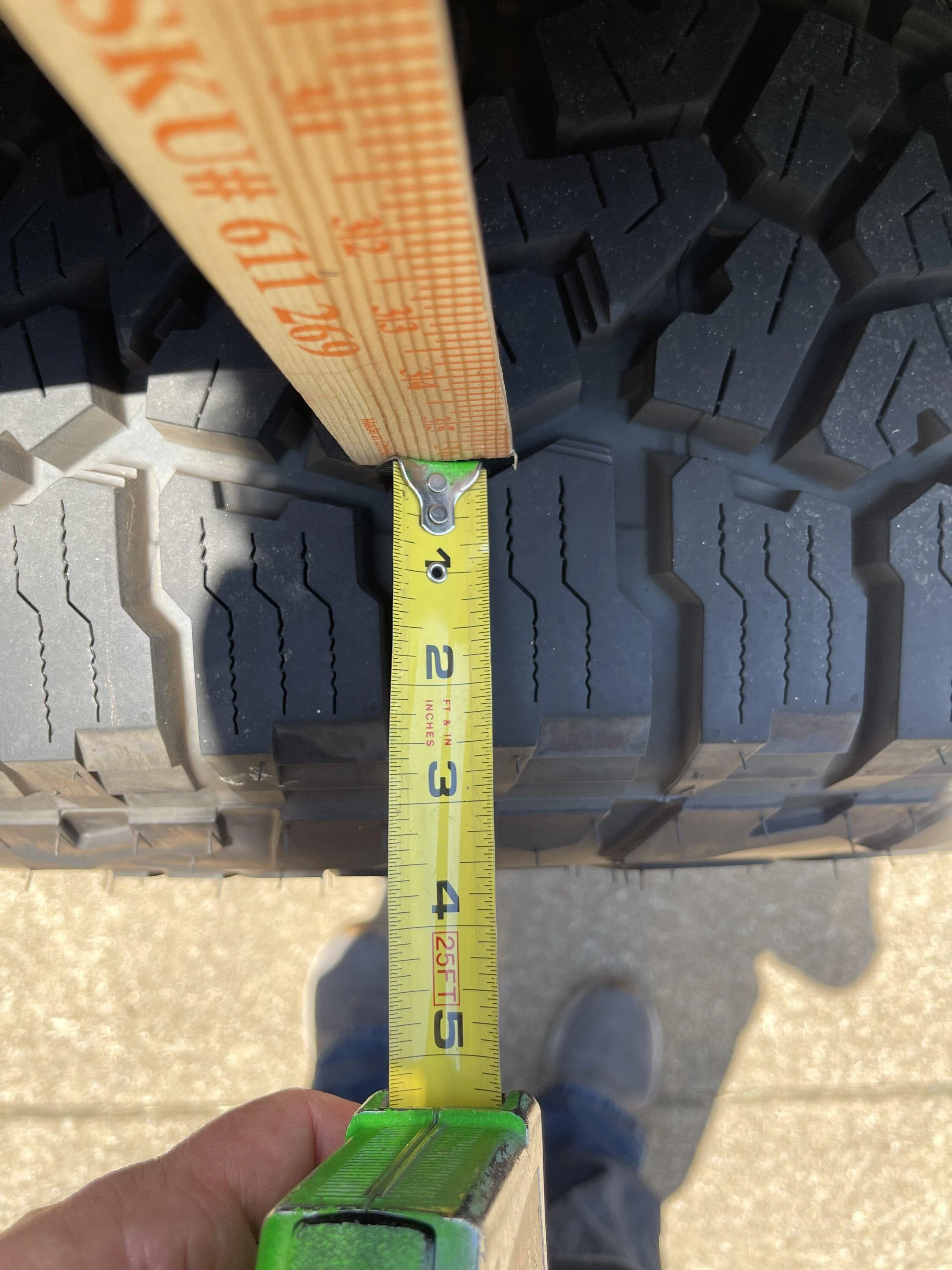

I have an outer banks non-Sas. Swapped out my wheels and tires for 35” tires and some black rhino 17” wheels with a -18 offset. Clearly now it pokes outside of the fenders. But I have not measured it
Ford Bronco Any poke on non squatch Outer Banks? B8460A56-E032-4481-8BC3-89F5BE004ADB
What is the width of your new black rhino wheels? It looks like you have about 2” poke. Looks good

It’s the Arsenal 17x9.5. I just went out and measured it on the back wheel (so I know it’s not turned) and it shows actually 3.5-4 in total poke including the sidewall. We lifted our outer banks 4” so we wanted a much wider stance. This means that although we have no rubbing, there isn’t enough room for a mud flap (this may change in the coming weeks as I remove the tube steps for sliders). The problem is, I have not found flares that can match the super wide stance we have. But I can live with it, because it’s a much more stable option with the 4 inch lift.

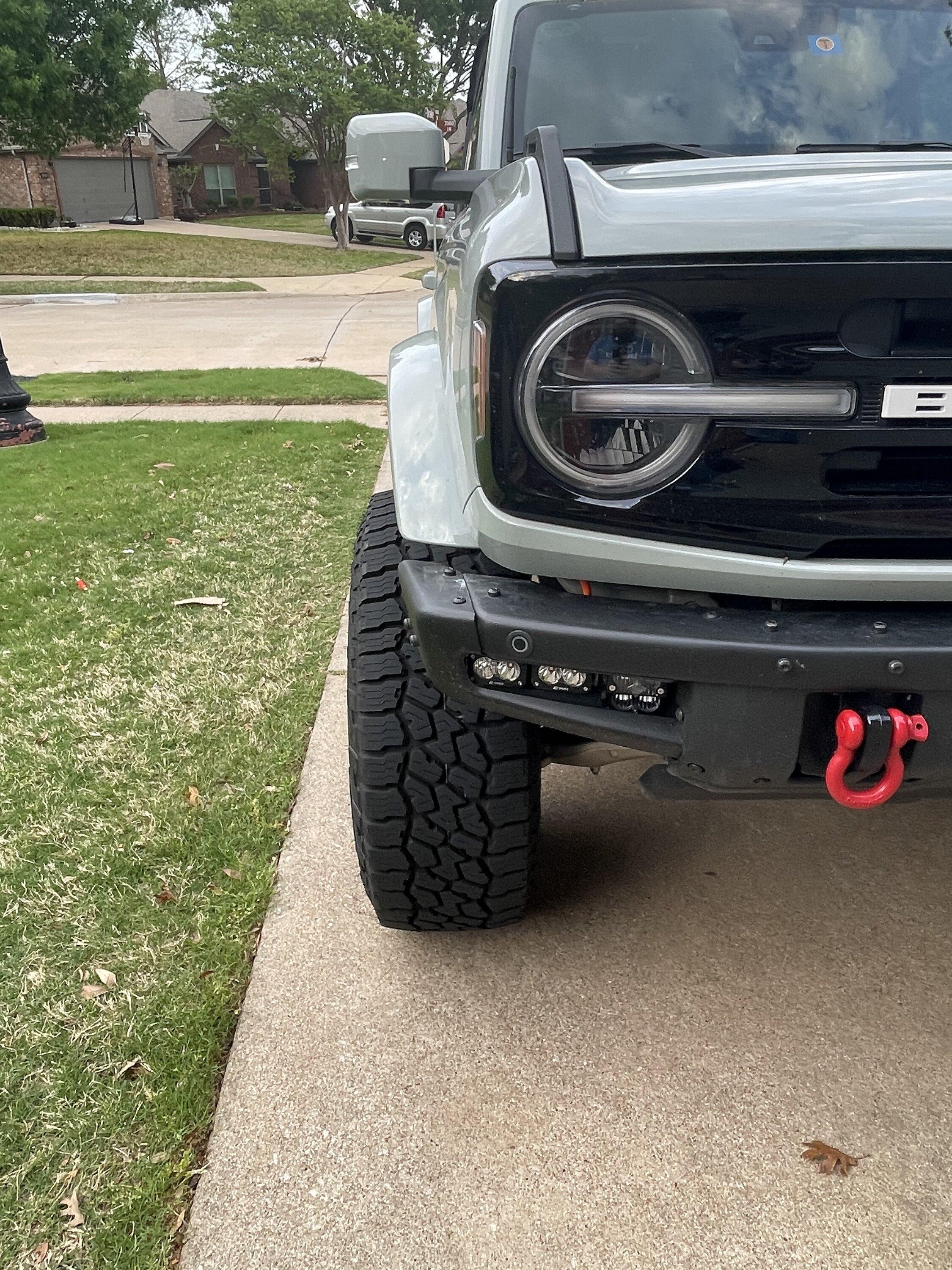

+30, I ran the new wheel specs through the offset calculator and it says the new wheels will protrude ~1.7” past where the stock wheels are.
I’m running a +30 on my OBX. Here’s what it looks like.
