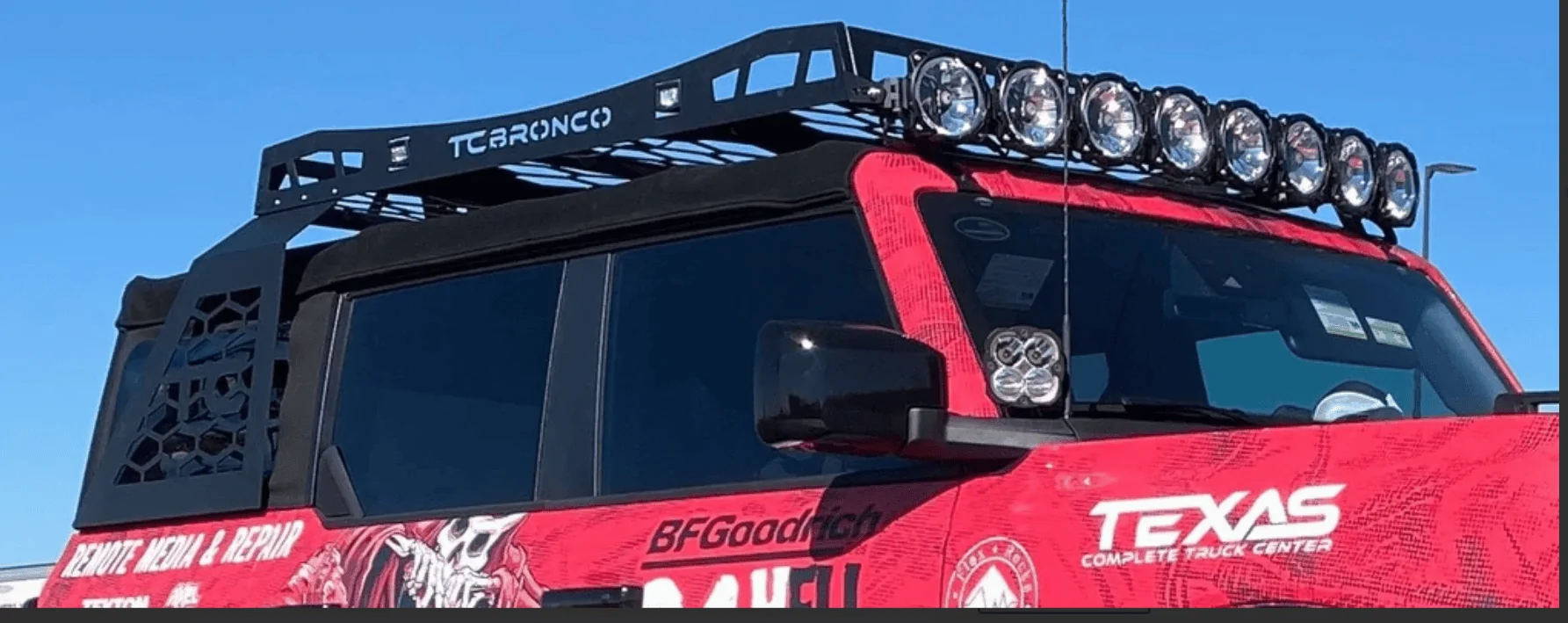

This one doesnt look that bad... I'd consider something like this..
Ford Bronco AR | Roof Rack Project 1644524561733

Need more soft top roof racks
Yesterday I placed my order for the Gobi Rack.... i prefer the lines of that one over the TCBronco version... :)
