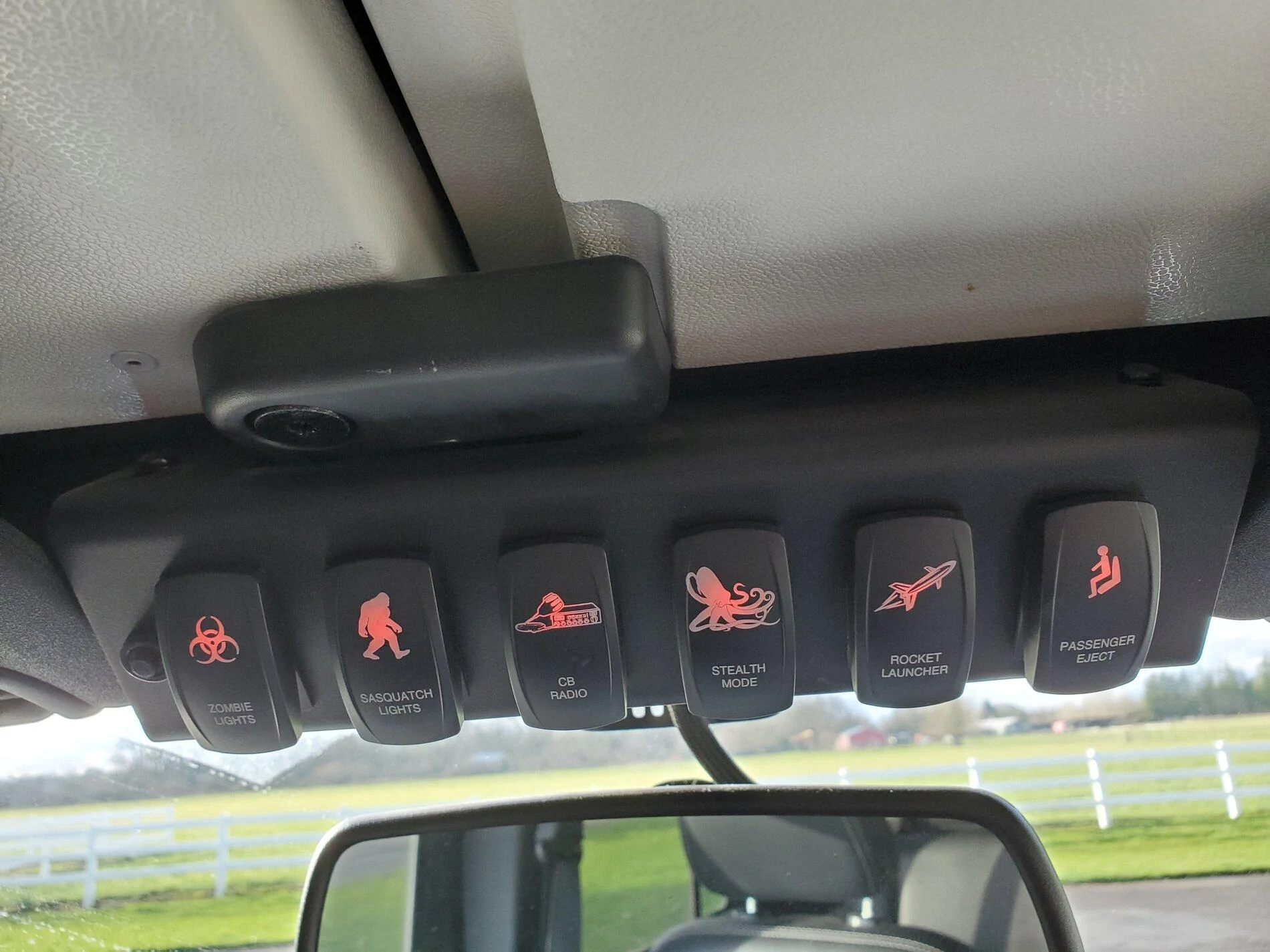

I'll probably just add the same after market accessories that I installed in my Jeep - wonder if there is a way to identify the switch so I don't accidentally launch a rocket.

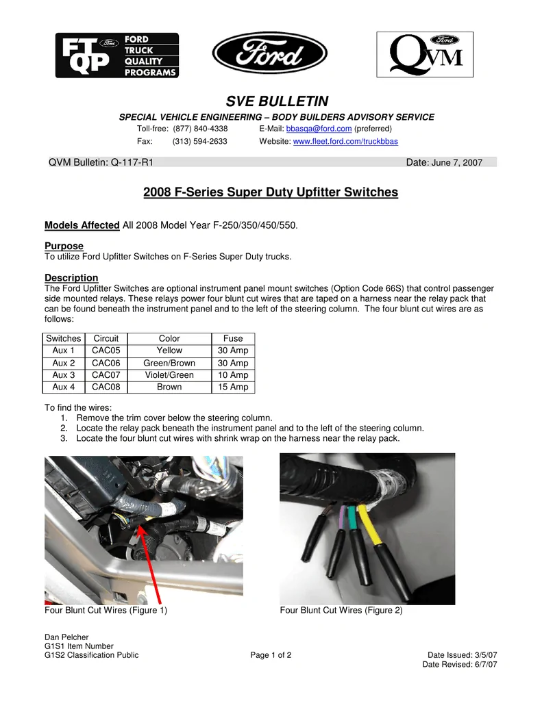

I have them on my 08 F350. Had all kinds of ideas for them.
  • I have yet to see a way to re-label them to something cool like oil slick, nails, SCRAM etc
  • On my truck the wires are fused differently, and the wires are sized differently
  • Technically wires should be fused at the supply to protect the wire and fused at the device to protect the device (This is what we do in marine electronics anyway.
  • The items I have thought about adding never work, because they have their own switch. The plow had an automatic relay system. Seat heaters have multiple positions. Amplifier switches usually include a level knob. etc
If I got it I'd hook up backup floods maybe . . .
Here is the info on my truck for reference. Hopefully the now they offer more customization via programming.

I'll probably just add the same after market accessories that I installed in my Jeep - wonder if there is a way to identify the switch so I don't accidentally launch a rocket into an antifa crowd???
LOL I had most of the same switches in my 78 C10.
I had one that said "Burn, ya Bastard!". Used it to wire in the seat heaters from the BMW buckets I robbed from Pull-A-Part.
Sasquatch lights is a must. Seriously.
I never saw the Rocket one, Or I definitely would have used it too.
Funny stuff.
