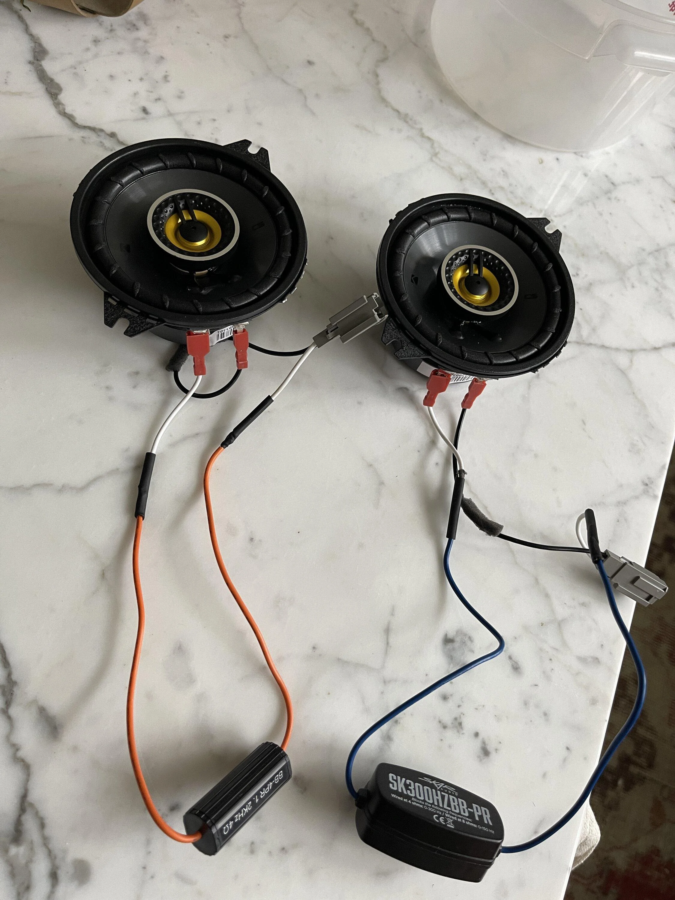

I’m going to solder two different Bass Blockers Tomorrow. 300hz and a 0-600hz. I’ll test the 3 new fronts with the blockers and without any. I’ll report back.
The fronts I have are Kicker CS, which I don’t think I like and Hertz DCX-1003. The center is a PRV woofer. I have the B&O, no mods on amp or sub.

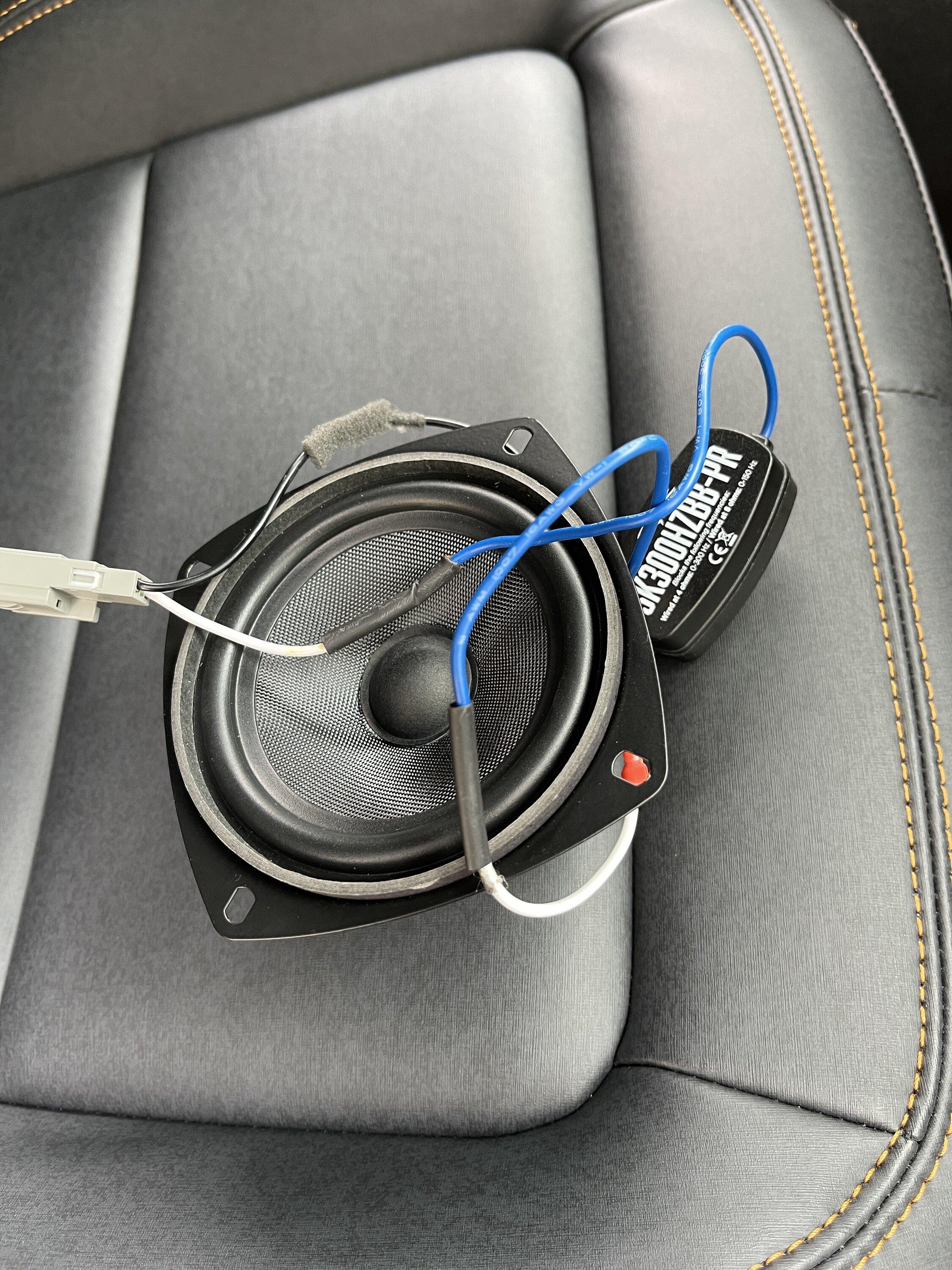

In the name of science, I tested two different bass blockers on multiple speakers.
The test was done with 4” Hertx DCX-1003, Kicker CS, and PRV woofer for Center. W/ 300 Hz and a 0-600 hz bass blocker.
I also test two different aftermarket 6.5 kick panel speakers. Currently have B&O, no mods on sub Or amp. Rears switched out to kicker CS 4”.
Here are my results. PRV Center woofer sounded better with the 300hz blocker.
The Kicker CS sounded significantly better with the 0-600 hz blocker.
Surprisingly, the Kicker CS with blocker, sounded better than the more expensive hetz speaker. The most significant upgrade was replacing the center with the PRV woofer.
After installing two different 6.5 kick panel speakers, I concluded that none of the after market sounded better than the OEM. Agree, don’t mess with the kick panel if you aren’t replacing the B&O amp.

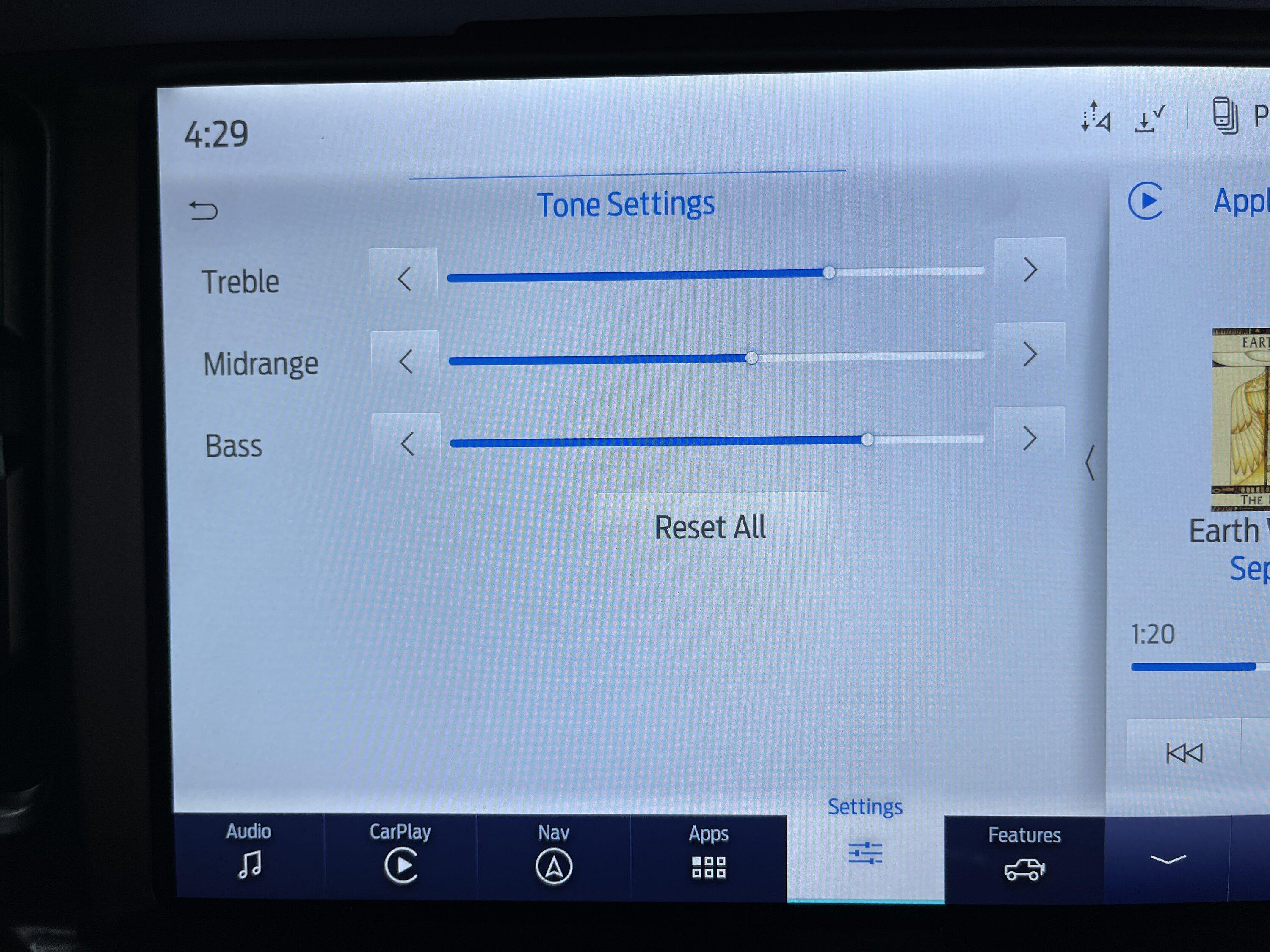

Suggested settings, stereo and settings pictured.

Slightly better sound with these bass blockers for center PRV woofer. Skar Audio SK300HZBB-PR Elite Frequency Filters - Eliminates Frequencies 0-300 Hz at 4 Ohms - Pair https://a.co/d/e8IoN0B

I’m still missing the left speaker install actually, due to being short on wiring harnesses. Just the center, right and rears it sounds good. Someone gave me advice on trying different setting and that was vast improvement as well.
