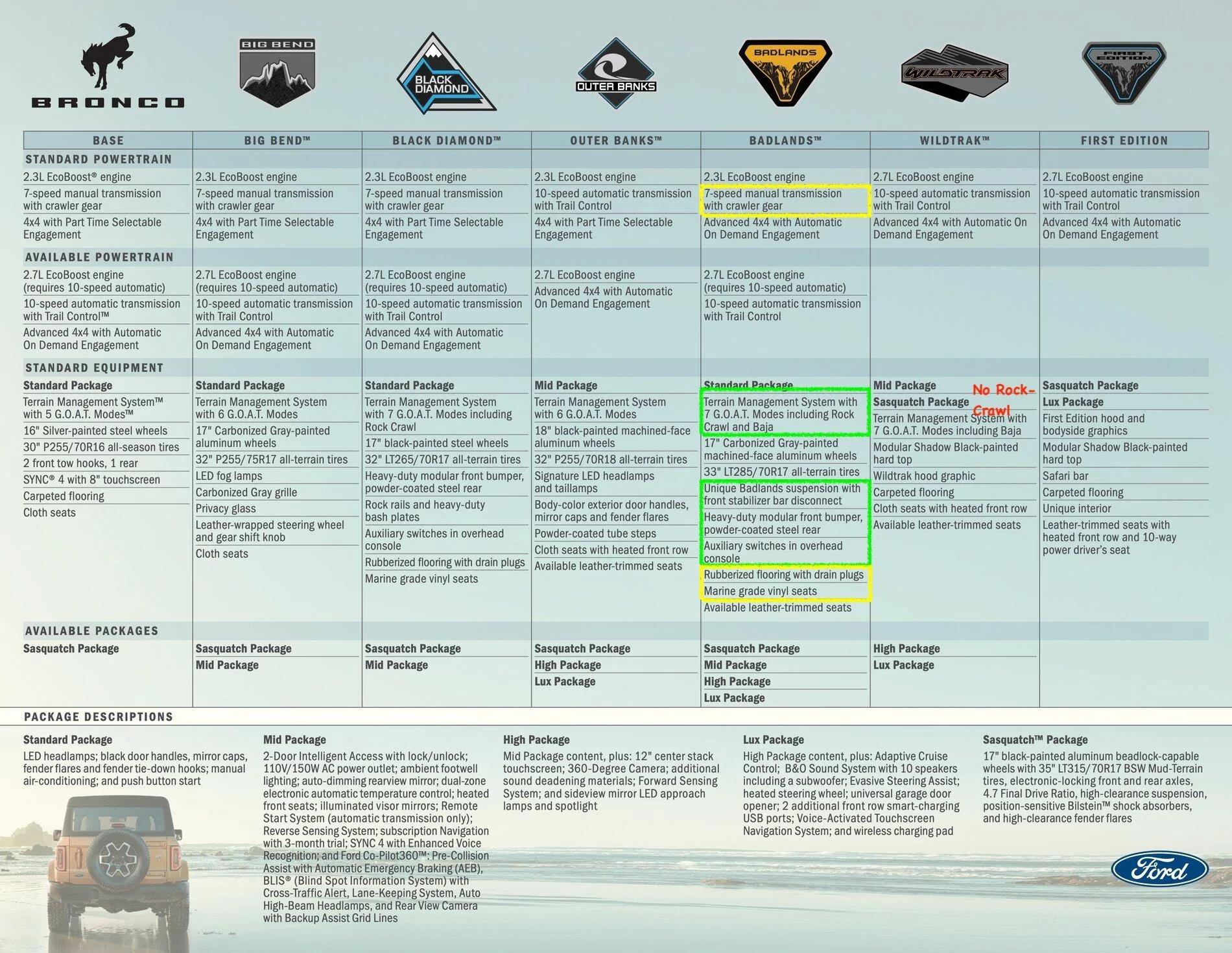

I want a badlands but I plan on getting my own 35" tires. Do I really need the sasquatch package? Doesn't the badlands already come with everything in the sasquatch package except the wheels and tires?
duc135
Duc
Jun 15, 2020
73
127
Los Angeles
2004 Jeep Grand Cherokee, 2014 Ram 1500
No 4.7 gearing in the stock Badlands with the automatic transmissions. Not sure if the Badlands has the high clearance suspension and fenders of the Sasquatch or not, but it does have the rest. I'm in the same boat. I would prefer to get my own tires unless I the dealer would allow me to order with the tires I want.

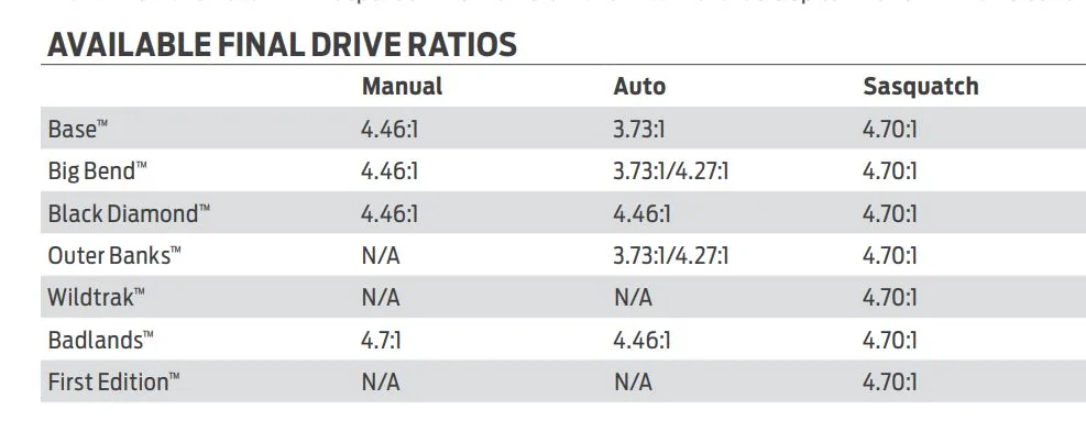

Isn't the manual trans gearing pretty close to 4.7?
TXRancher
Feb 12, 2020
269
563
Brownwood TX
2011 F150
No 4.7 gearing in the stock Badlands. Not sure if the Badlands has the high clearance suspension and fenders of the Sasquatch or not, but it does have the rest. I'm in the same boat. I would prefer to get my own tires unless I the dealer would allow me to order with the tires I want.
incorrect, the Manual has a 4.7 gear. Auto has 4.46.

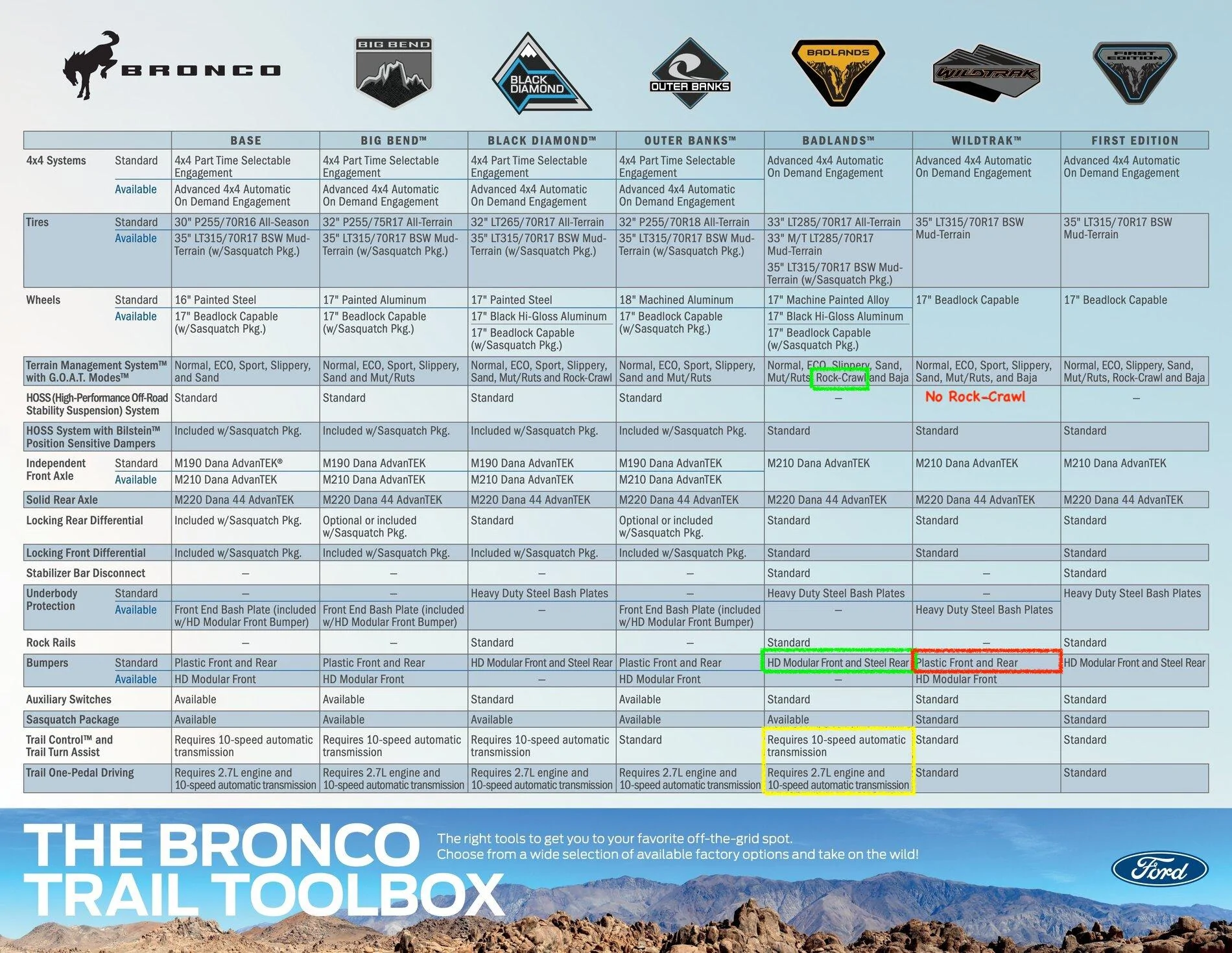

It is a big deal to me too. I am hoping I can get: 4dr Badlands + want the vinyl seats + rubber floor + Sasquatch + LUX + 2.7 (which obviously comes with the 10-speed auto)
I am hoping "Lux" doesn't also come with leather seats. Hopefully, they make that a separate option entirely.
Seems like Lux doesn't add leather on the Badlands, according to the packages/options one-sheet on the Ford site.
