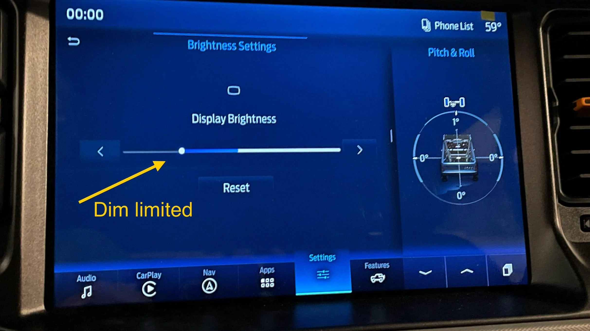

Did you notice any options for changing the range of intensity for the illumination on the center display while in these modules? Mainly dimming, recently I noticed the center display was brighter at night then it had been. In settings/display/brightness adjustment does not allow for the slide bar to go left completely. Happened around the time I noticed my Badlands received update 4.2.2
That’s very strange. I currently have the 8” but swapping to the 12” soon. I will double check and see what I can figure out.
