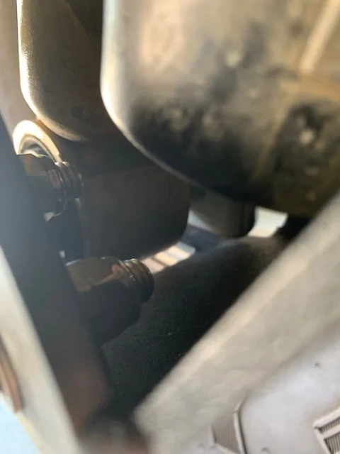

Here's a shot of the bolt hitting the reservoir covering. I can also reach my hand behind the plate and feel it touching the rubber covering. Any hit to the plate will transfer right into the shock, which kinda defeats the purpose of the protection.

@OffroadBandit Put some washers under the bolt head to pull it away and contact Barnes, they’ll make it right if you provide pictures and details.

After doing some digging and comparing to my friend's sas'ed base, it looks like the badlands, nonsas, Bilstein shocks have lower reservoirs than the sas shocks. This causes them to interfere with the bolt and press against the skid plate when mounted.
Unfortunately, this also means it's possible that all shock skid plates that were manufactured and tested on sas broncos will be incompatible with nonsas badlands. @Sewie , do you have sas on your badlands?

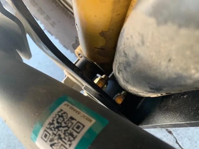

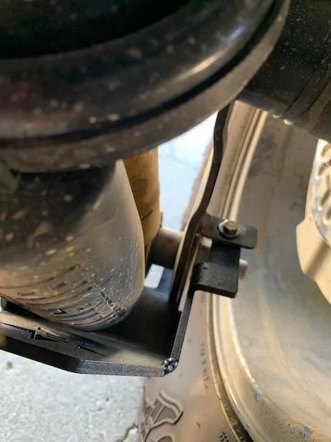

Yes, I have Sas. Kind of hard to get measurements without jacking up the rear end, but took a couple more pics to show clearance.
