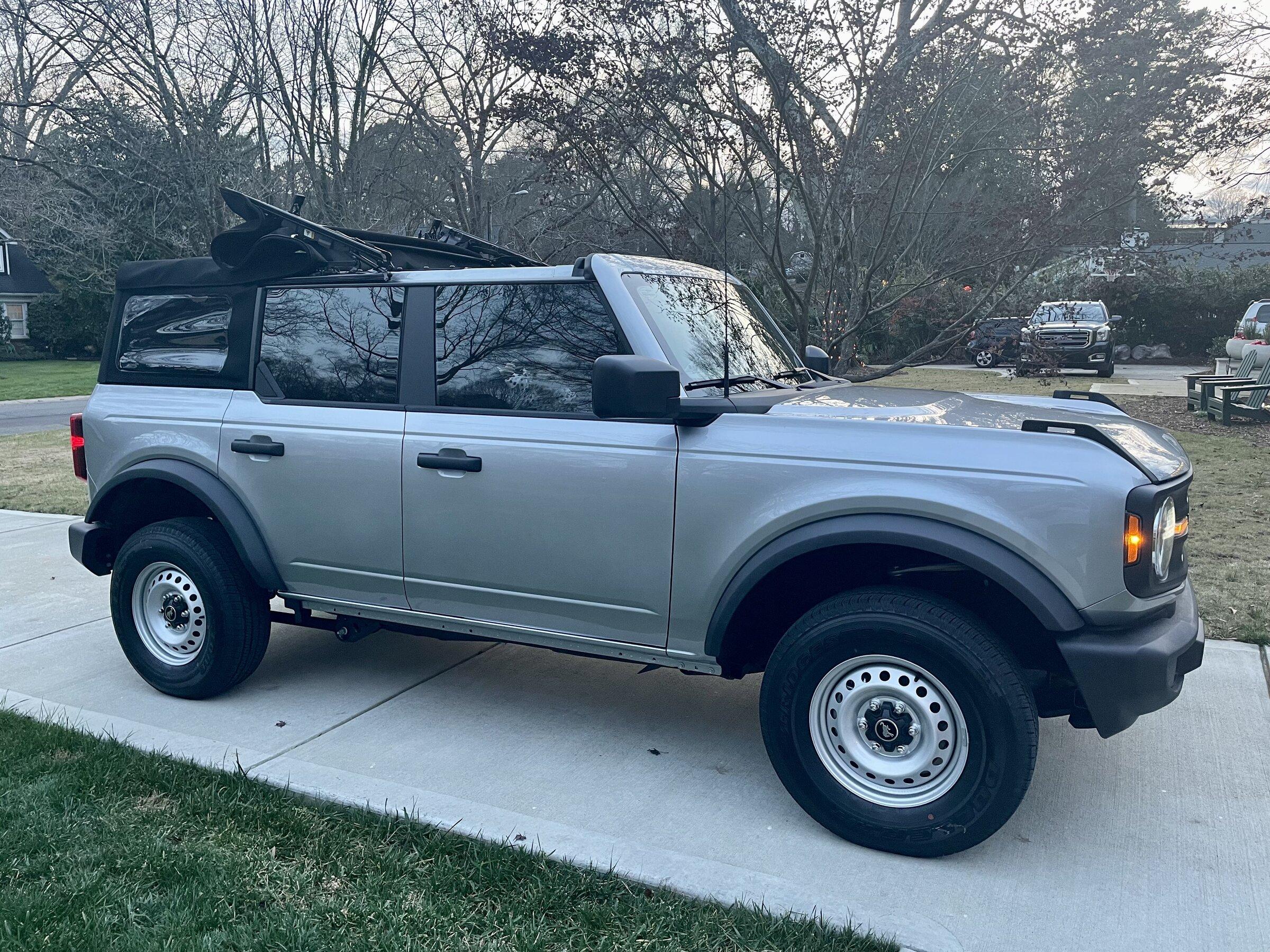

1. Stock the day I picked it up

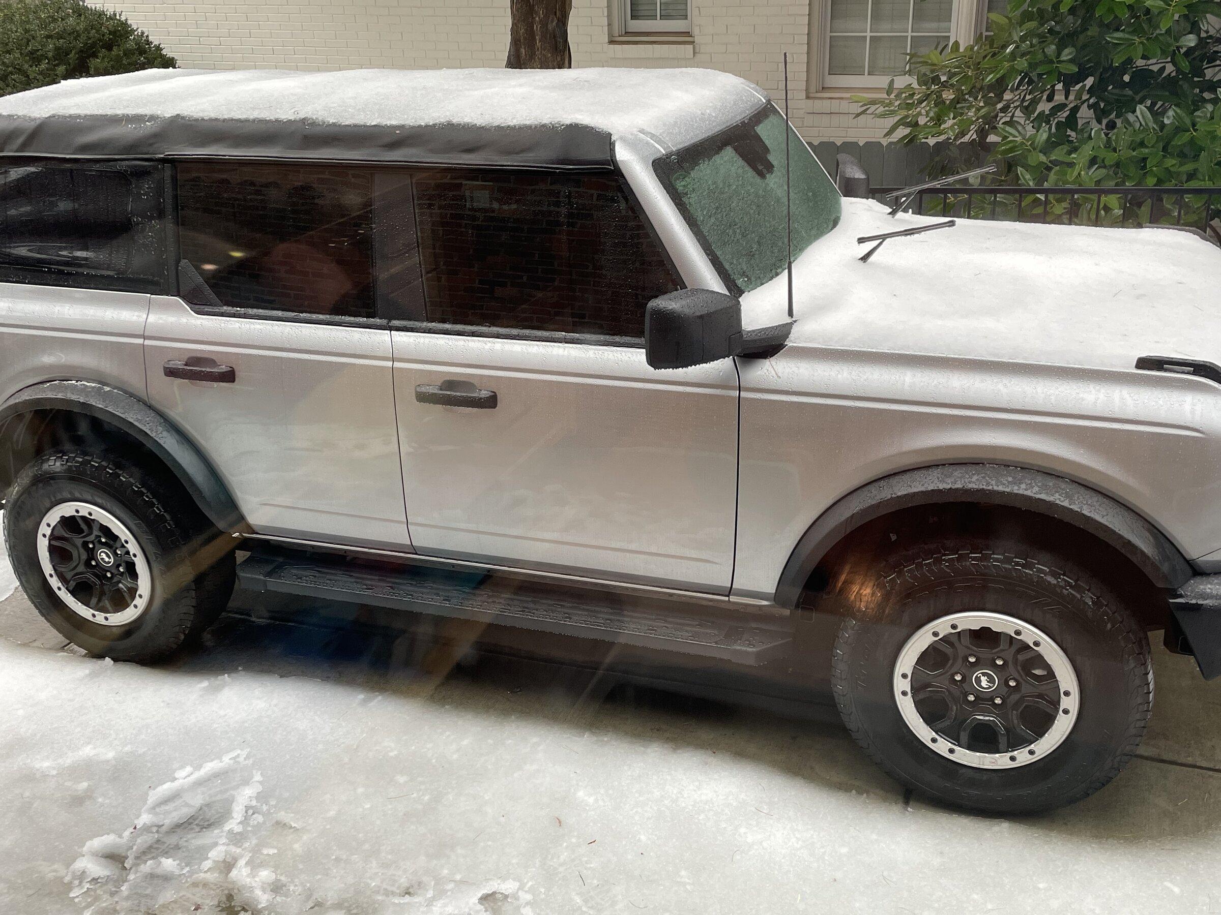

2. Added 285/70/r17s on Sasquatch wheels.

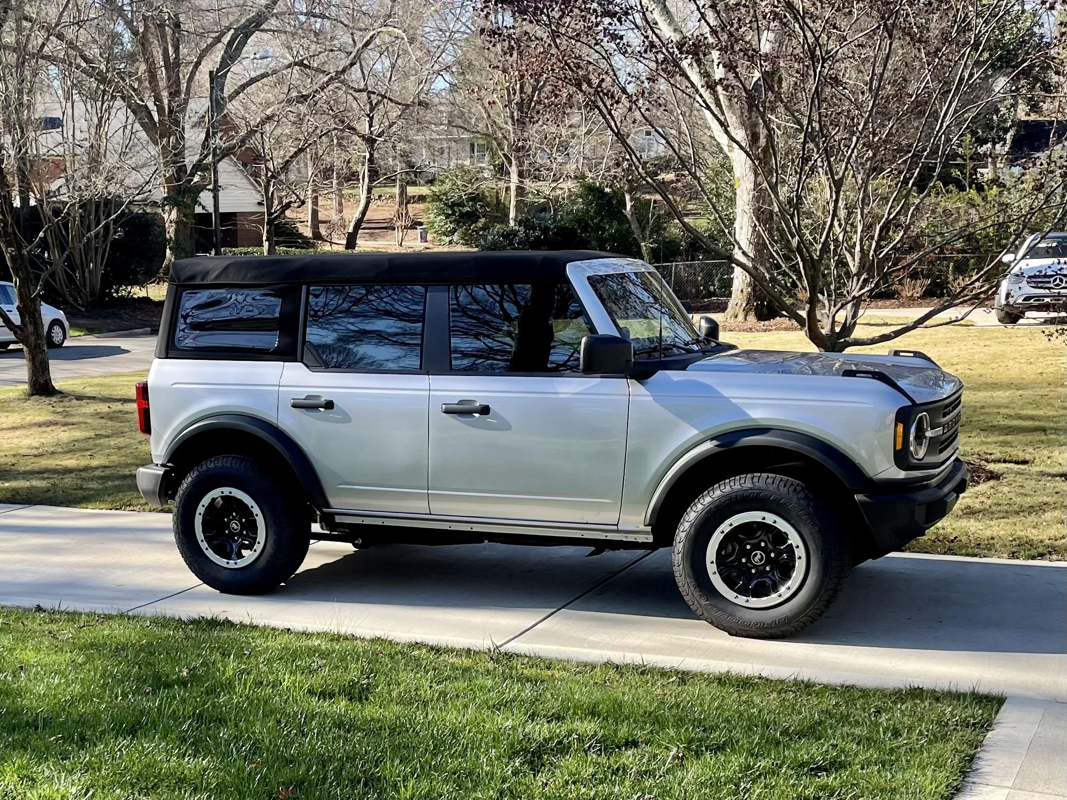

3. Added tube steps
I'm assuming you're running a lift? If so, which one? That looks really good. I've kept my eye out for takeoffs but the few in my area that have popped up have wanted 4k+ for them.

No lift needed. The 285/70s I put on are 32.7 inches. That’s just over a half inch taller than what BB and OBX trims have as standard with the same suspension. It sits pretty high with the standard suspension, already. The steps were added out of necessity more than looks. The kids and wife struggled to get in and out. I’m 6’3ā€, and it’s about as high as I can effortlessly step into without using the step or hopping a little. I was pleasantly surprised.
I paid $700 for the 5 wheels (no tires or sensors). 5 BFG Trail Terrain A/Ts installed and moving sensors from base wheels, ran about $1,100.
Be patient… Sasquatch take offs will be priced right in your area soon enough.
