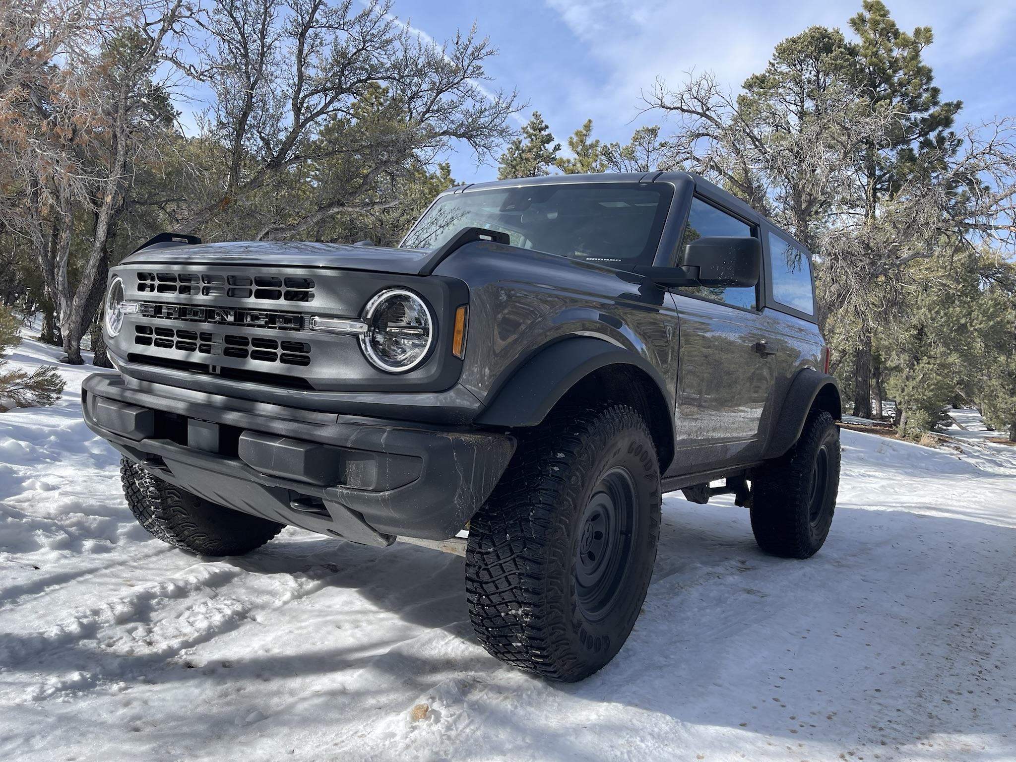

get maybe husky liners to replace the floor mats if youre going to be in the dirt or snow. Base model is the best. Look at all those handsome grilles. Good choice.
