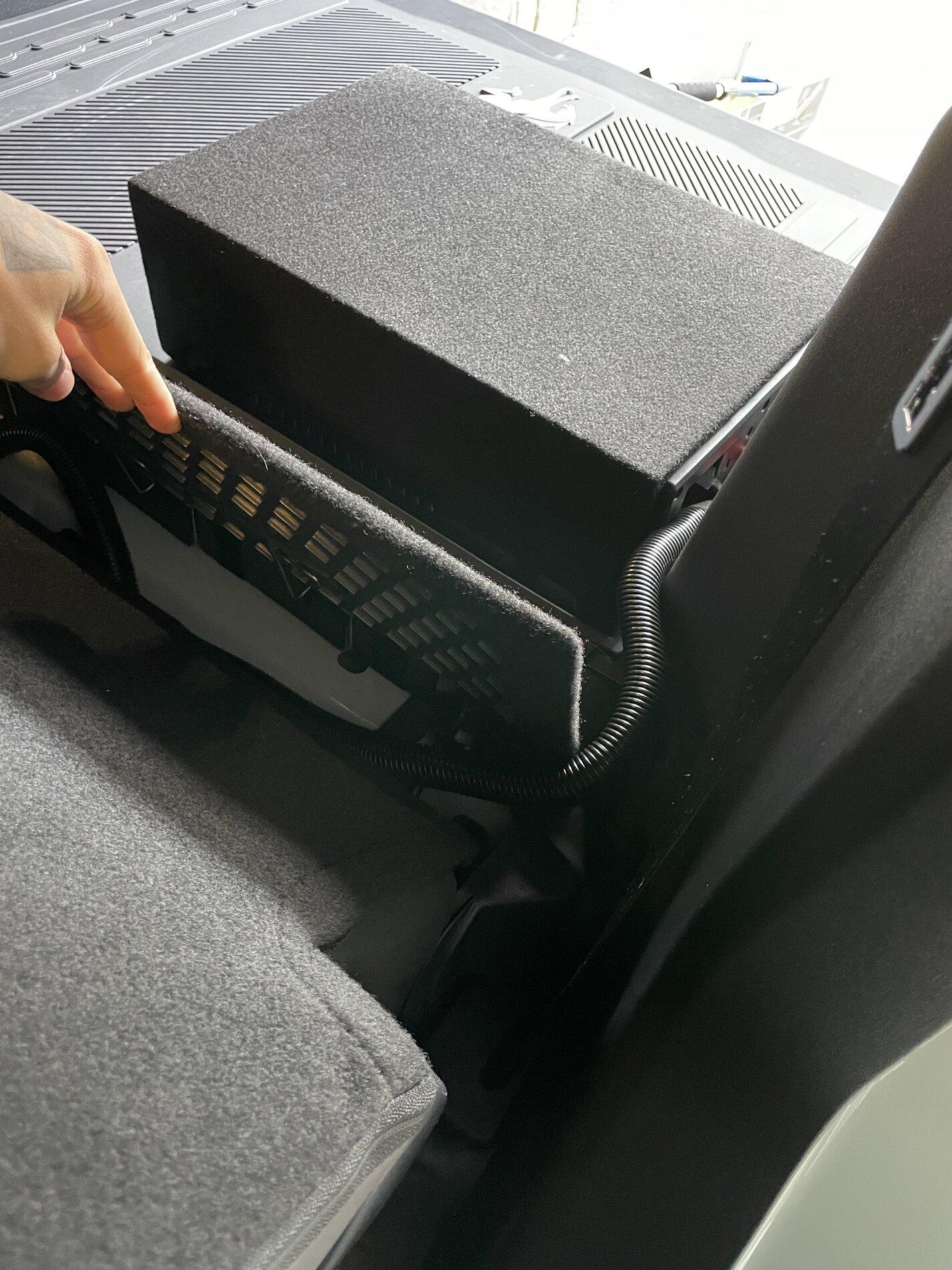

Nice. I like the placement and look of yours. Is there anyway you could confirm how they connected it or post pictures of the connections? 🙏
I'm out of town away from the vehicle until next week. All the wiring runs behind the back seat and behind the trim though, so I won't be taking that apart.

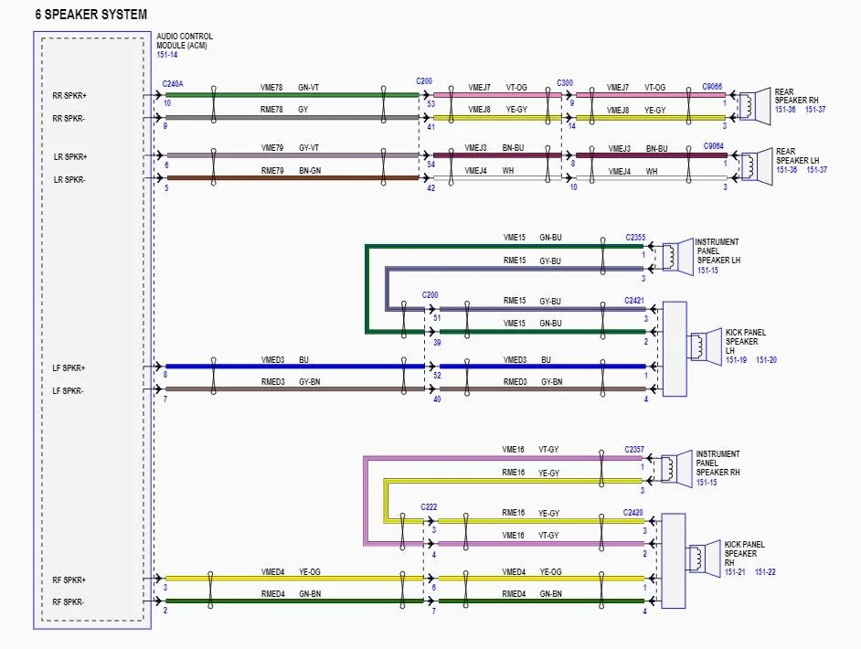

I just unplugged the kickpanel speaker harness and tapped into the + and - and plugged it back in. Nothing special or difficult. I used this schematic for reference.
