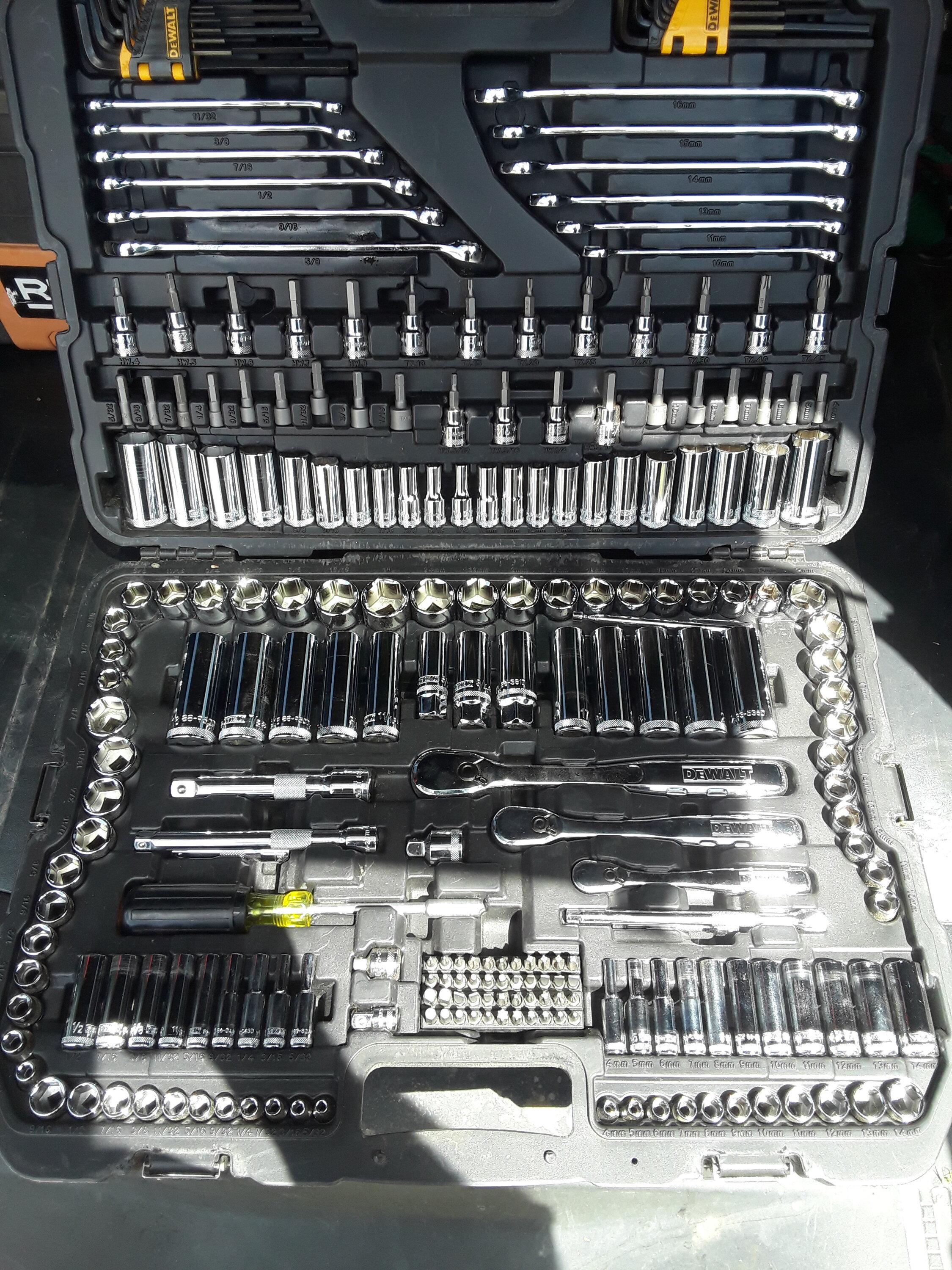

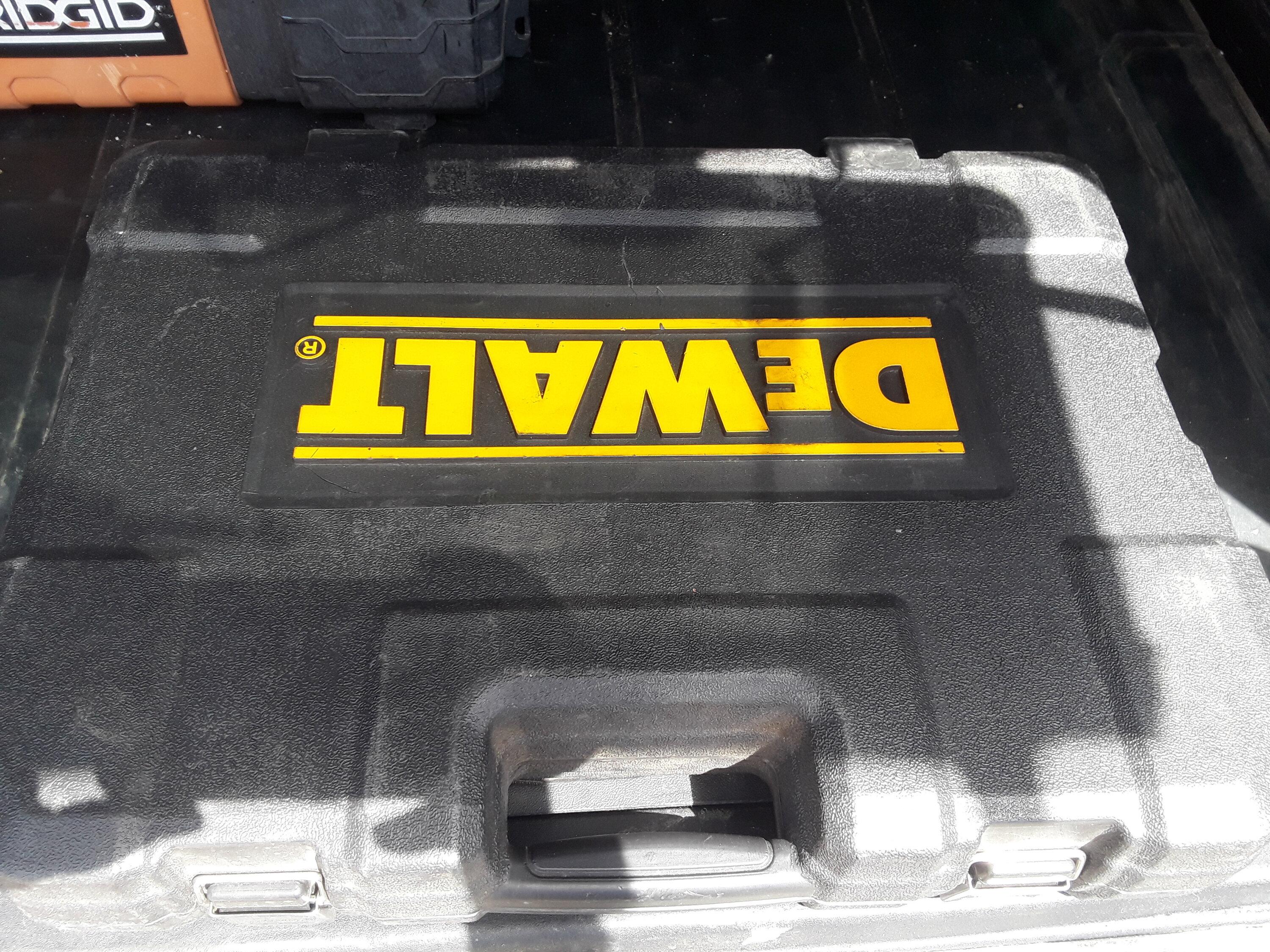

Ford Bronco Basic Bronco Specific Tool Kit 16919487691271904749679990690789
Ford Bronco Basic Bronco Specific Tool Kit 16919488154784358586077006105790
I picked this little guy up on amazon for about 125 it fits in the back great. Also a cordless impact and various tools depending on what you intend to do while out.
