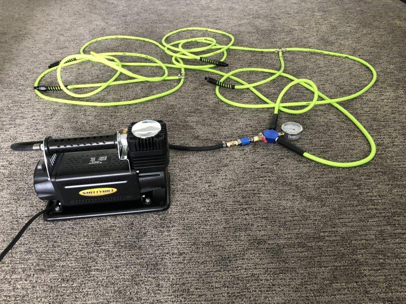

When I was looking at an inflation system a couple of years ago, the Smittybilt 2781 was the best overall value. Mine cost around $150, but their website shows it at just over $200. Other web sites show it at around $160.
Mine can inflate four Sasquatch tires from 20 psi to 39 psi in ten minutes. I've timed it a bunch of times and it consistently fills them in that time. But I have a 4-tire inflator/deflator system, so they all get done at once. It cost me another $150 or so to build that out of random parts.
I drop pressure in my tires whenever I get to the dirt areas and leave them at 20 psi until I get back to pavement. It improves both traction and ride quality. I haven't spent much time in sand, but when aired down I have had no traction issues in the little bit of sand that I've driven in.
One photo of my setup:

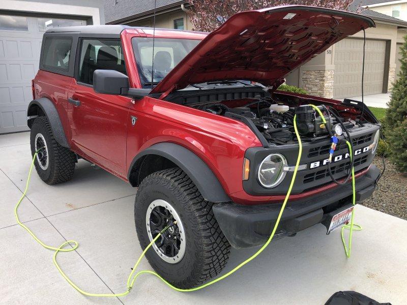

Mustang, Escape, 2-door Base Sasquatch
Definitely appreciate it. Does the “Complete 4 Way with Gauge” have four hoses and everything I’d need? Currently leaning this direction?
This is what a proper inflator/deflator system should look like in use. Four chucks, two hoses leading off from the main air pressure gauge and each of those hoses having two chucks on them. Yeah, it's faster to inflate all four at once, but the biggest advantage is that when you let the air out all four tires will have equal pressure.
