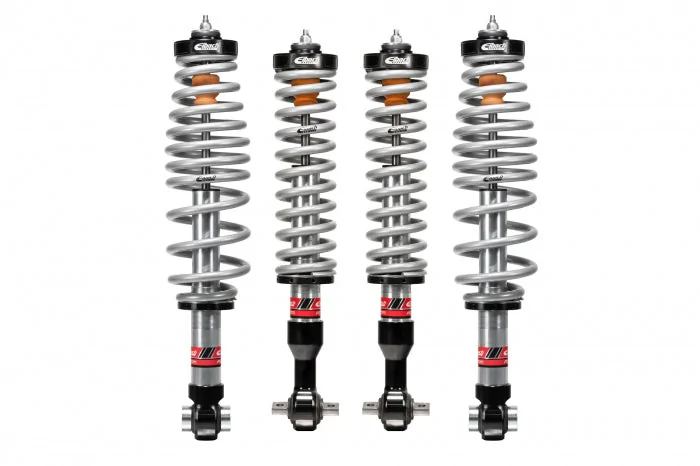

I would highly consider this system from Eibach. It’s made in the USA and comes with a lifetime warranty. Fully adjustable as well!
https://www.neo-garage.com/products/2021-ford-bronco-eibach-stage-2-coilover-system
What makes this system better than either OME Heavy or Bilstein 6112 with the correct Overlanding springs?

Spring preload = fully adjustable? Is there compression and rebound adjustment? 🤔
There is no compression or rebound adjustment. I guess my wording could be confusing, but it was referring to the height adjustability. Since it's not on set notches like the Bilstein's you can fine tune the ride height to be exact. If you want internal adjustments you need to look at Icon, FOX, King, ADS.
There are a plethora of systems available out there but what I don’t want to do is buy/install the wrong system then load up my Bronco with bumpers,RTT, winch, fridge, gear, etc and watch it sag and struggle. And my future long term goal might be to pull a Turtleback Overlanding trailer.
I was laser focused on ICON and OME BP51 but am considering other options. ICON has not released there heavy springs yet
Ford Bronco Bilstein 6100 vs OEM Kits B490E98F-52A7-4532-9653-E5471A221D46
Well, you can get around the added weight with these by just adjusting the lower spring perch, since it's threaded, like I mentioned earlier, you can really dial in the height and as you add weight, you can just adjust them right on the Bronco. Icon & FOX are identical if you go with the true 2.5 stage kits. The biggest benefit with Eibach is the warranty though. You are pretty much set on suspension for the life of the vehicle as long as Eibach is still in business and producing these.

Bilstein coilovers are digressive where as Eibach is progressive. Your application is going to determine what you want to put on your vehicle.
https://accutuneoffroad.com/articles/digressive-vs-linear-vs-progressive-pistons-shock-valving/

Ok. Let’s then boil this down to 2 options
1) Eibach Stage 2
2) Bilstein 6100/6112
Which has the proper spring for my application? I get the adjustability of Eibach being much easier. That is definitely a plus
1) Eibach Stage 2
I’ll actually be rolling to the shop in about 15 minutes. I can crack open one kit and confirm spring rates.
Another thing to note with Eibach (100% for front) they use a spring that they make hundreds of variations with. So if you needed to bump up spring rate, you can do so, the rear being a proprietary spring (I know they’re working on different versions) that will be what you get u til they release new spring rates over time.
I hope that makes some sense.
it’s like with Icon 2.5s for example, they come with a 14”x600# spring if I recall correctly, but then you can swap to a 14x650 or 14x700 if needed.
